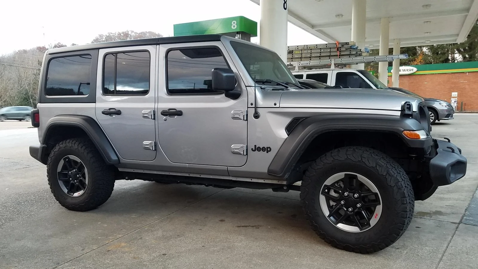

Here is my jeep currently with takeoff rubi suspension/wheels/tires. I just sold my sahara steps and ordered roam framed mounted step/sliders. Do you think a 2.5" lift on 33's would look way too top heavy? I'd like to have a little more clearance for offroad and it's tough to justify ditching these tires with only 6k miles on them.
I think it would look fine with some more lift. You can manually disconnect your sway bar pretty quick with some tools or go with a company like you mentioned. I think the Rancho don’t require any permanent mods but I’m not 100% on those products
Brett
Thanks...so the sport does come stock offering the ability to manually disconnect the sway bar? Are we talking less than 5 min to do this? That would obviously be cheaper if it's easy to do.

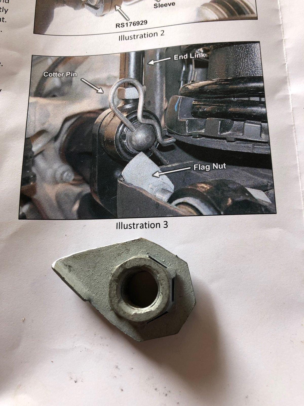

Brett
I have the Ranchos. They will require trimming a flag nut if you want to actually disconnect. Which is not in the instructions. No other permanent changes needed.
Great pic and info. I didn’t know that. However, that’s an easy mod but one that would bite ya if you didn’t know
