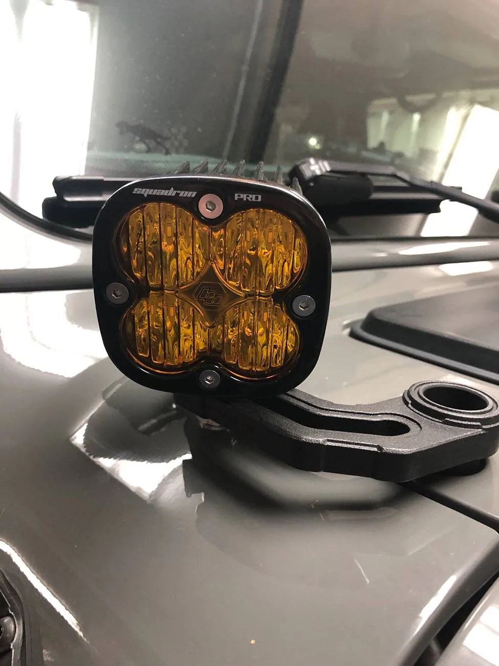

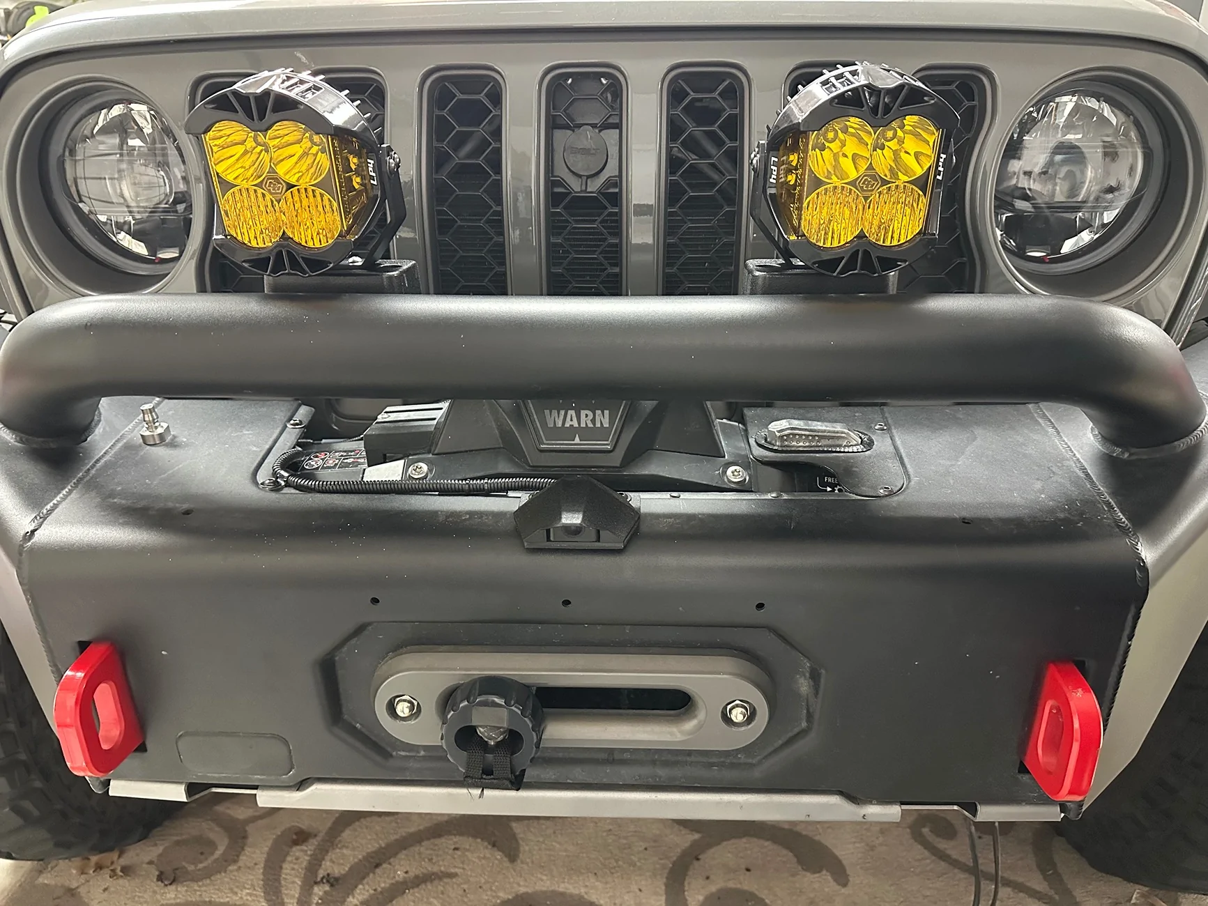

Baja Designs LP4 Combo on the bumper. Baja Designs Squdron Pro used for ditch lights on the cowl with Seven Sparta mounts. Even though I have the factory auxillary switches I have lights wired to a JL400 grab handle switch. I have amber KC Hilite Cyclones on my rear window hinges as wig wags. I prefer amber since while driving in a group in dusty trail conditions, amber is easier on my eyes and reportedly to those ahead of me. @THAW has it wrong since a million Toyota Bros can’t be wrong about amber lights. I’m currently adding KC Hilite rock lights in you guessed it, amber, before I cruise over to trigger @THAW

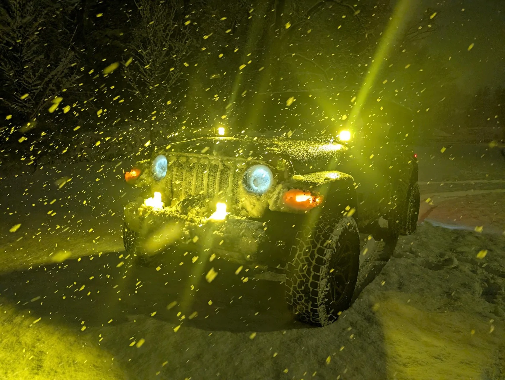

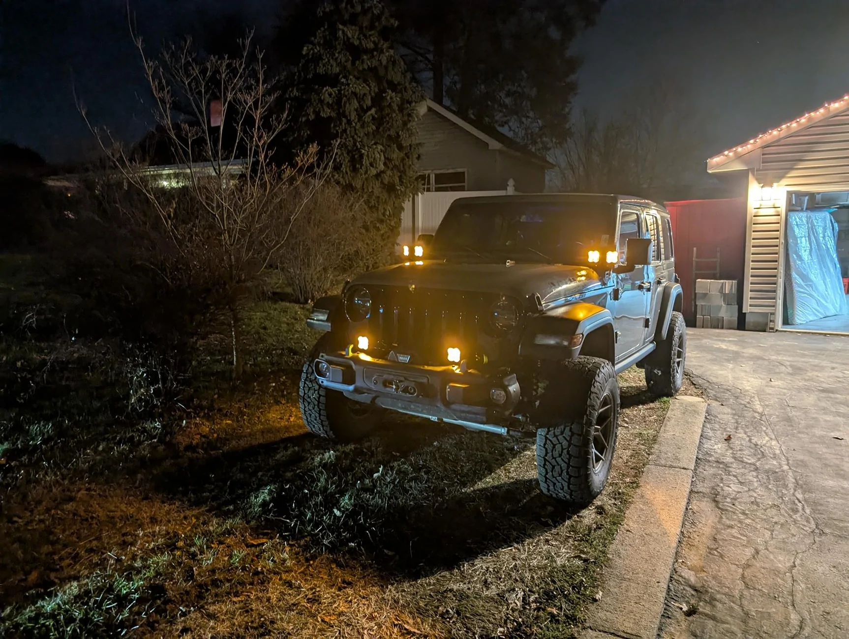

I have two sets of Diode Dynamics SS3 Pros (bumper and A pillar) for snow/dust. A pillar is the driving beam, bumper is the flood beam.
I also have a set of SS3 Sports (white) for ditch lights. They are all wired to the Diode Dynamics D Switch. Simple install as noted above. The lights have a neat backlighting feature. Not pictured is Oracle Bumper mounted Reverse Lights. Those were an awesome $150 upgrade. I may supplement it with the Diode Dynamics hitch light.
