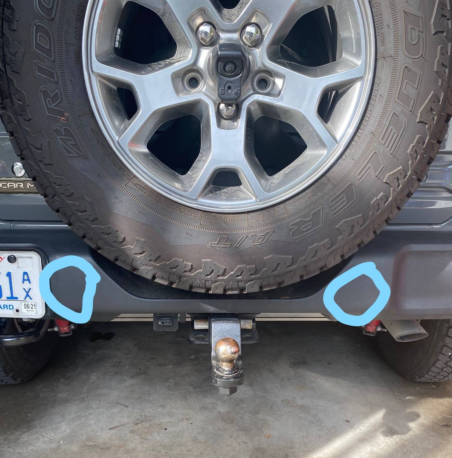

I recently purchased some inexpensive (cheap) LED lights that I hope to add to my rear bumper to augment the poor back-up lights. Here is what I ordered:
https://smile.amazon.com/gp/product/B07GR23FGJ/ref=ppx_yo_dt_b_asin_title_o05_s00?ie=UTF8&psc=1
Since these are just over 1 1/4" deep, I want to flush-mount them in the bumper where the factory reflectors are on the Rubicons.
Question 1. Is there enough room behind the plastic to mount such a light? Picture included for exact location.
Question 2. With the low power draw of these lights, can I simply splice into the current back-up light wiring to power these without having to run a power wire and relay?
Any other comments/suggestions would be much appreciated.
Yes, you should have no issues.
Sorry can't answer question 1.
It seems like there should be room.
Oracle makes a set that replace the red reflectors in the Rubicon rear bumper. Might want to compare the specs/sizes of the Oracle version and the ones you bought.

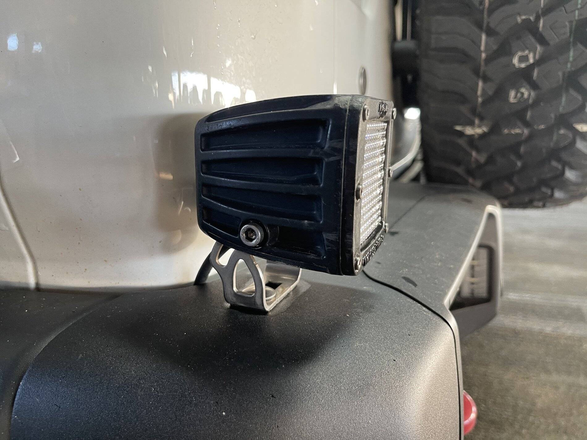

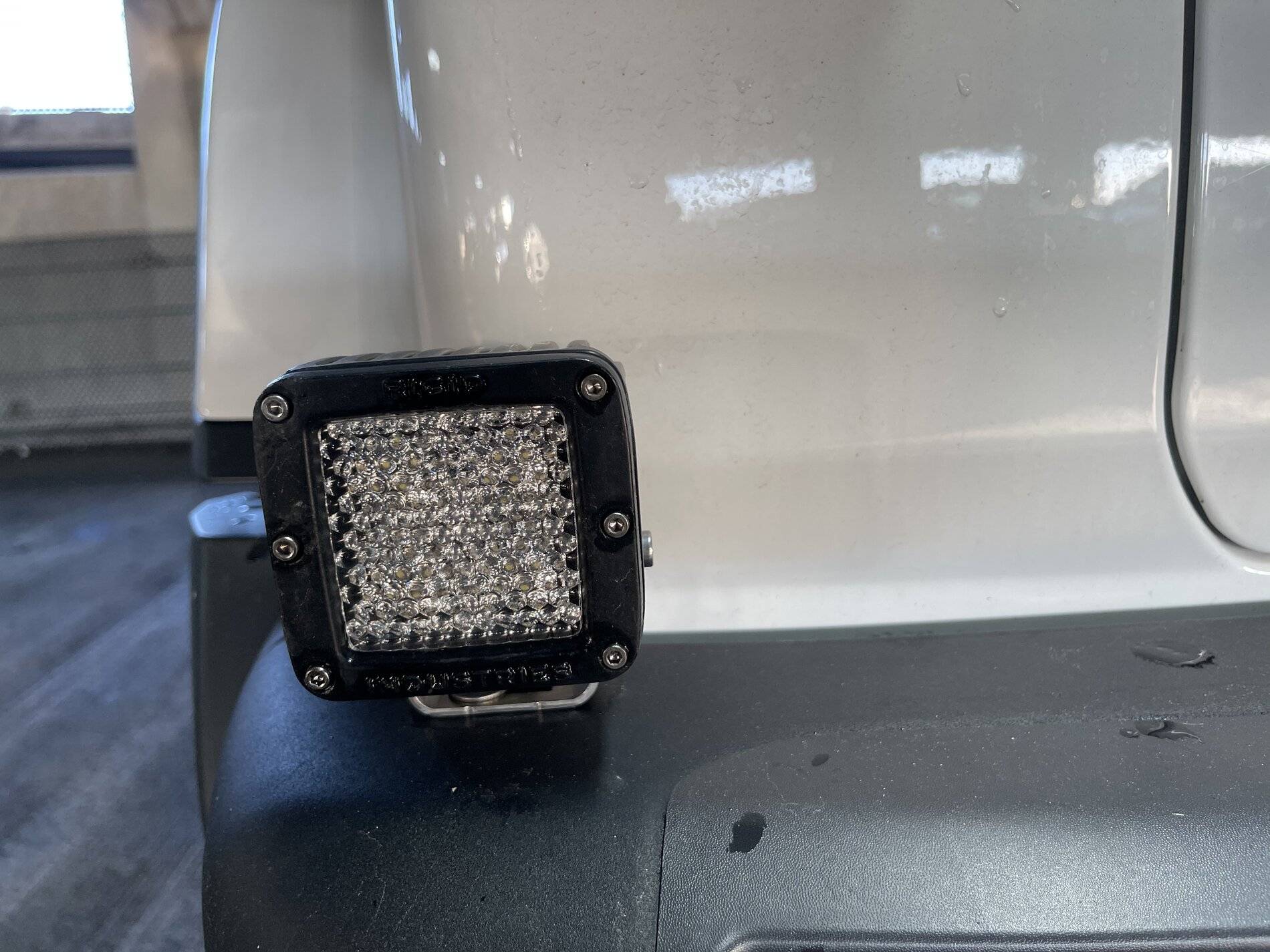

Would you consider a factory steel bumper, more protection and it has pre-drilled holes that are perfect for mounting lights. My old rigids fit well here.

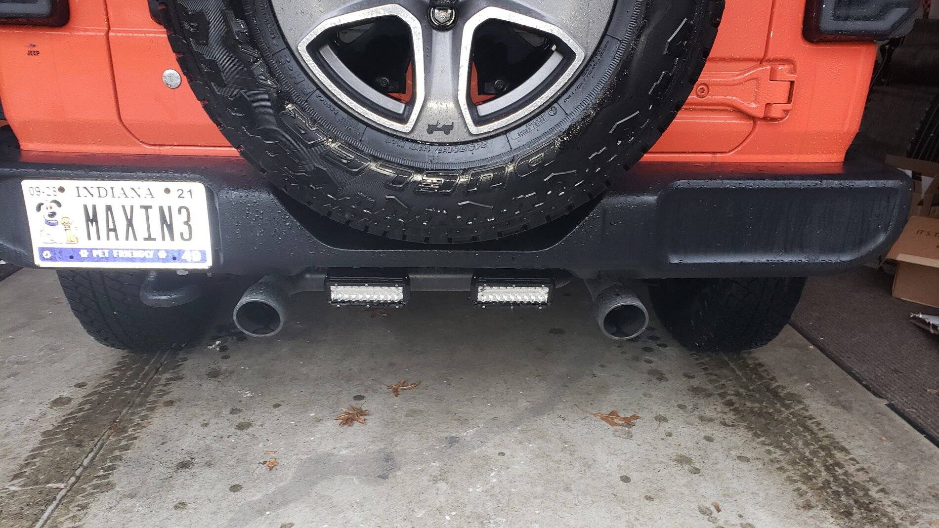

Sport S here. I think they should fit but I am skeptic on adding more draw to a system with the current(amps) aftermarket things might pull. If my calculations are correct it would be about .5amp. I recommend temporarily hooking into the pin and see how they behave first. Not sure on the fuse but should be.
I ran a 6gua power wire to my rear and added a fuse block to power my subwoofers and then added more lighting.

Yeah I’d run dedicated wires,
