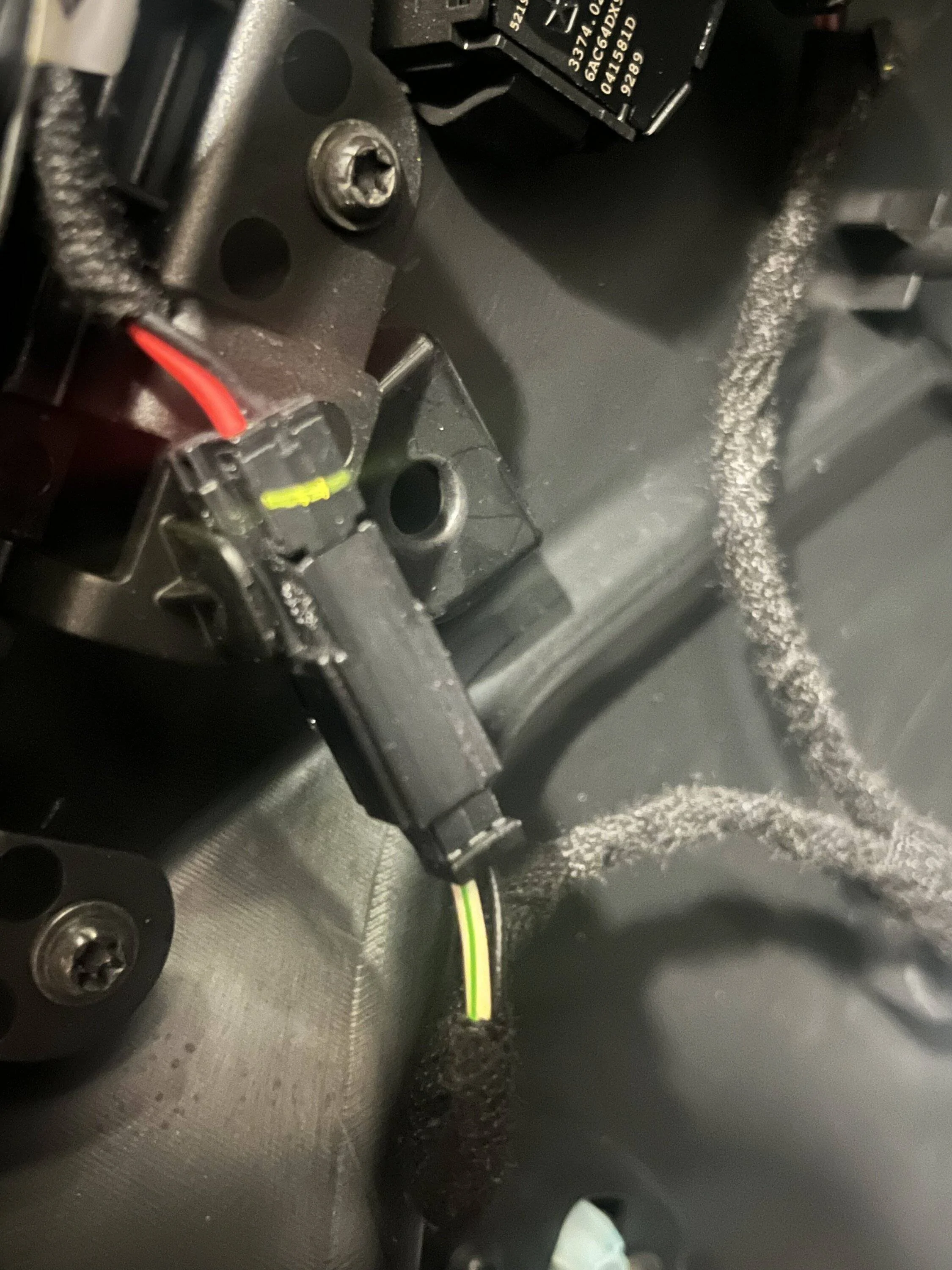

The left dimmer wheel can be used for ambient lighting control. I accessed the wire under the door panel. It’s the white/green wire in the picture. I spliced after the quick disconnect to the door handle light bulb. The control knob dims led strips I installed in the footwells.
You got a write up for this, interested in doing the same.
