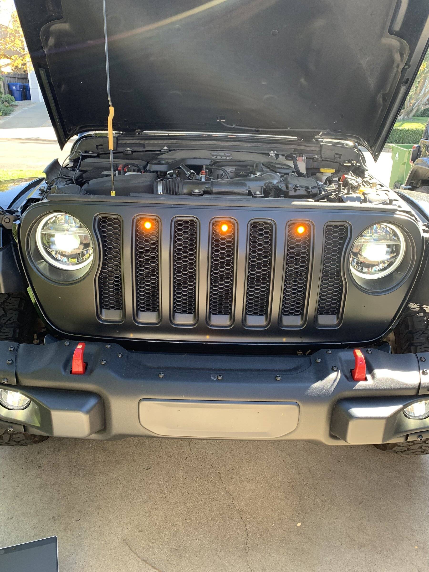

Hi All, looking for some insight on adding additional lights and wiring into DRL's. I have the lights installed, oracle states to tap into the white and brown wire... This works, but the lights will only work with the switch to park/ on/ or they will come on at night with the auto setting.
Any idea which wire color to tap into that would make them work with the actual DRL's, basically leaving the light switch on Auto (so that they will funtion during the day)?
Thanks in advance!

If you didn't have DRL from factory I believe turning them on manually is the only way.

Mine has the full DRL and lighting package, but I dunno why they won't come on with the DRL's... And I don't wanna try each wire, hoping to find a solution

Another alternative is to just run the power to an Aux cable (assuming you have that package) and then adjust the settings on the screen to have that particular Aux set to always on.

The one package mine does not have... Damn lol. Thanks though, maybe I can come up with something.

I saw a response by Oracle that stated the following:
"You can connect to ignition power (F52) on fuse box and these will act like a DRL and come on when the Jeep is on."
I have no idea how to do that, but looks like if you can figure it out that is the way to go for what you are looking to accomplish.

Oh shit, that’s awesome! TY for sending, I can do that for sure!
