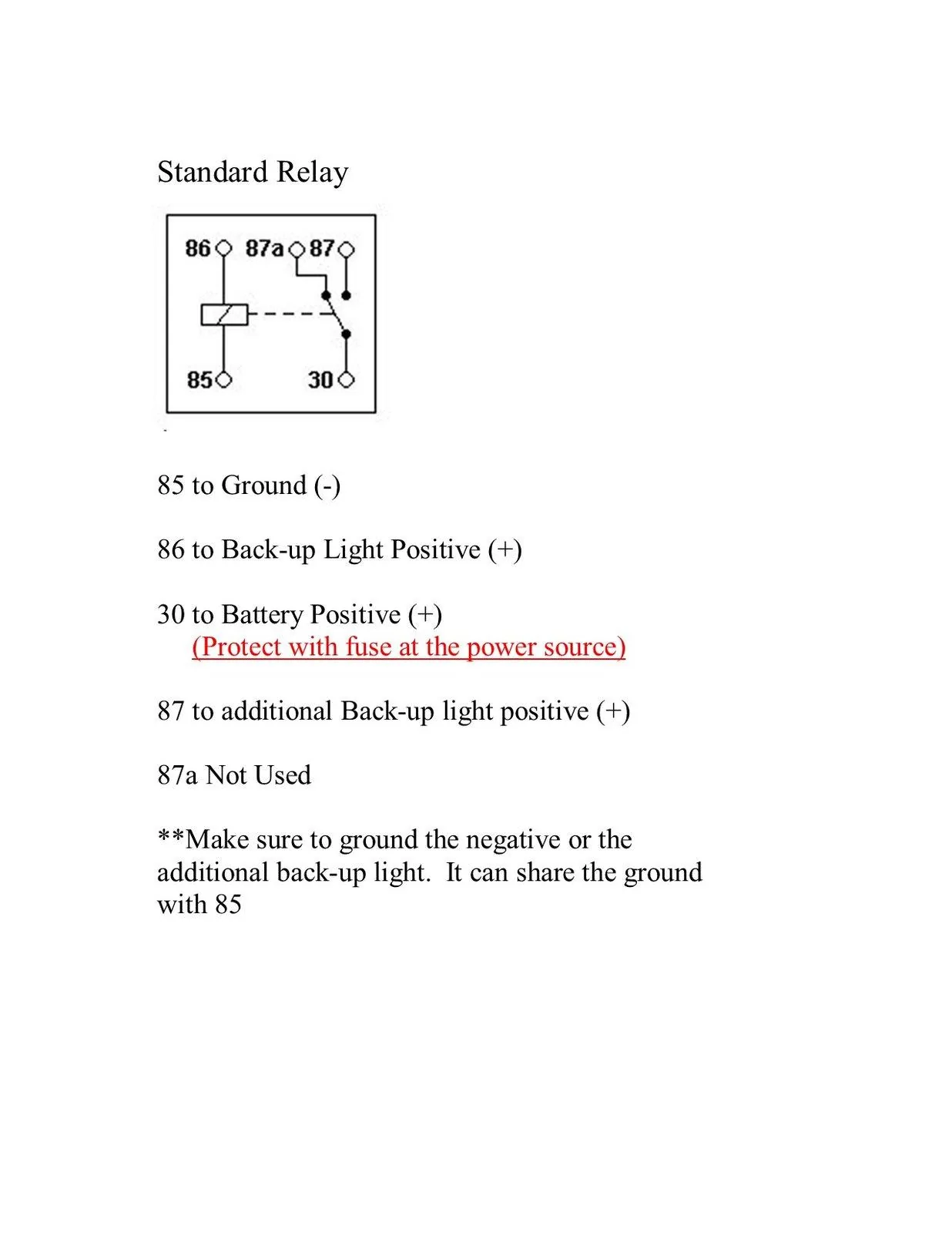

I know this has been discussed but I'm adding the Addictive Desert Designs rear bumper with RIGID back up lights. . . .what is the cleanest way to get power to them? I only want the lights to work when in reverse. . . .

I would use a relay. Have power from the back-up lights trigger the relay and run a hot wire from the battery with a fuse at the battery. Do you have the two package? If so, you may have a hot wire in that plug that you could use to power the lights and get your power from there.

They might. I would check your tow plugs for a positive 12v source that is hot when the engine is running, if you have one, then you just need to tap the revers light positive and get a relay.

I'd just tap into the reverse wire (white w./ beige trace) on the drivers side taillight harness, simple :)

I've read where some who tapped into the factory reverse lights had issues. . . .

I would tap i to brake light wire on both sides done.

That is why I suggest a relay. I don't know how much draw the reverse circuit can handle.

I wanted the same as you, I tapped into the backup wire in the trailer harness by the plug. The wires are labeled on the larger plug. No issues with anything else.

I added some extra LED backups as part of a DV8 bumper I installed. I tapped into the trailer wiring harness. No issues, the lights come on when I shift into reverse. It was pretty easy to splice the lights in and everything works.
