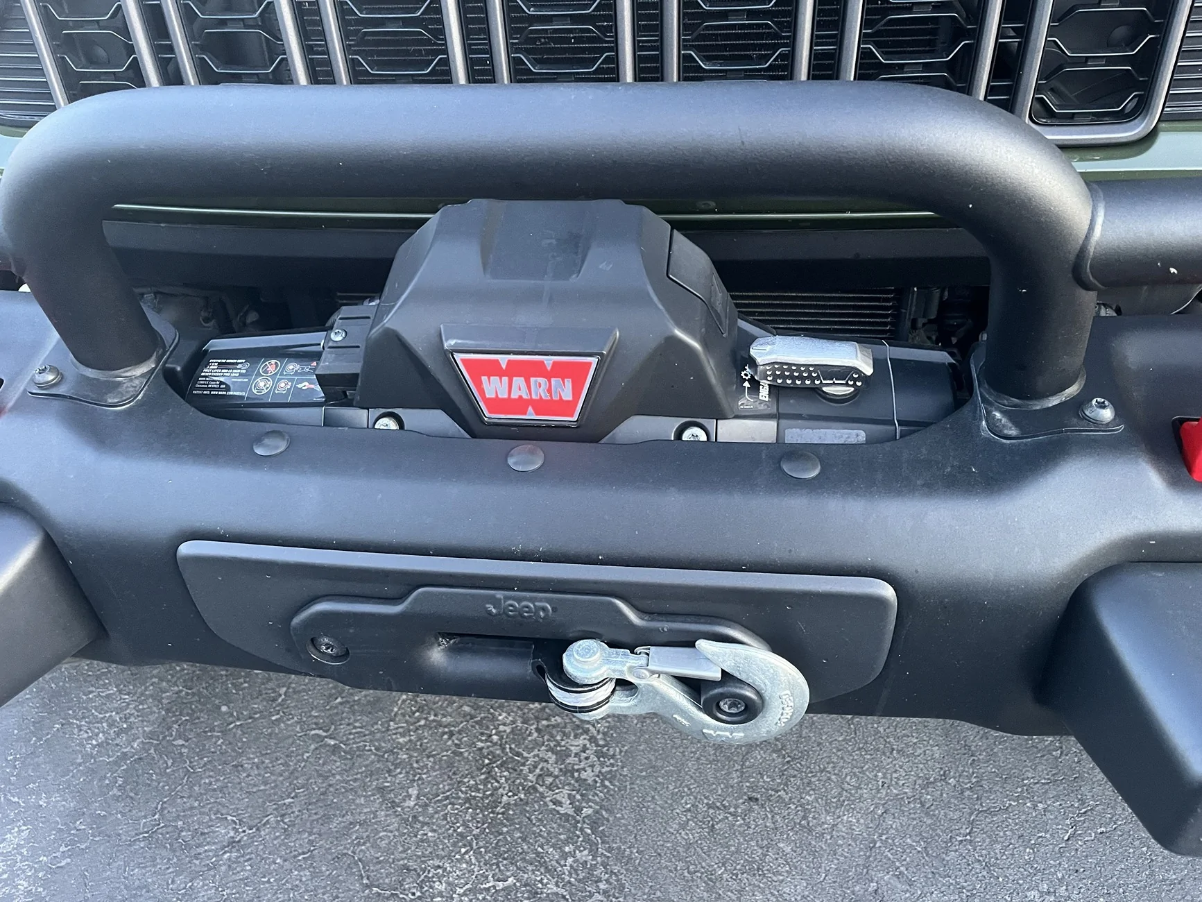

For my bumper, I would like to add @BajaDesigns LP6 Pro lights LP6 Pro lights. I have an OEM steel bumper with factory Warn winch and Mopar Triple Hoop grille guard. Using the mounting holes on either side of the winch, I think I should have room for the lights, but want to make sure. My other concern is accessing the clutch lever and potential heat generated from the lights.

My plan is to wire the bumper LP6 high beam to Aux 2 and low beam to Aux 4 with the amber day-time running light wired to stock running lights. I plan to wire the A-pillar lights to Aux 3.
Pie in the sky, I would also like to install Reflex Light Actuators to all of the lights. I don't particularly like the idea of running a toggle switch through the firewall, then not having a clean place to put the switch. Would it be possible to set up the actuators to use the rear door window toggles when those switches are in lockout mode? My thought is that when the windows are in lockout, those switches can move the lights without affecting the windows, then when not in lockout mode, the windows can be controlled without moving the lights. Is this even possible?

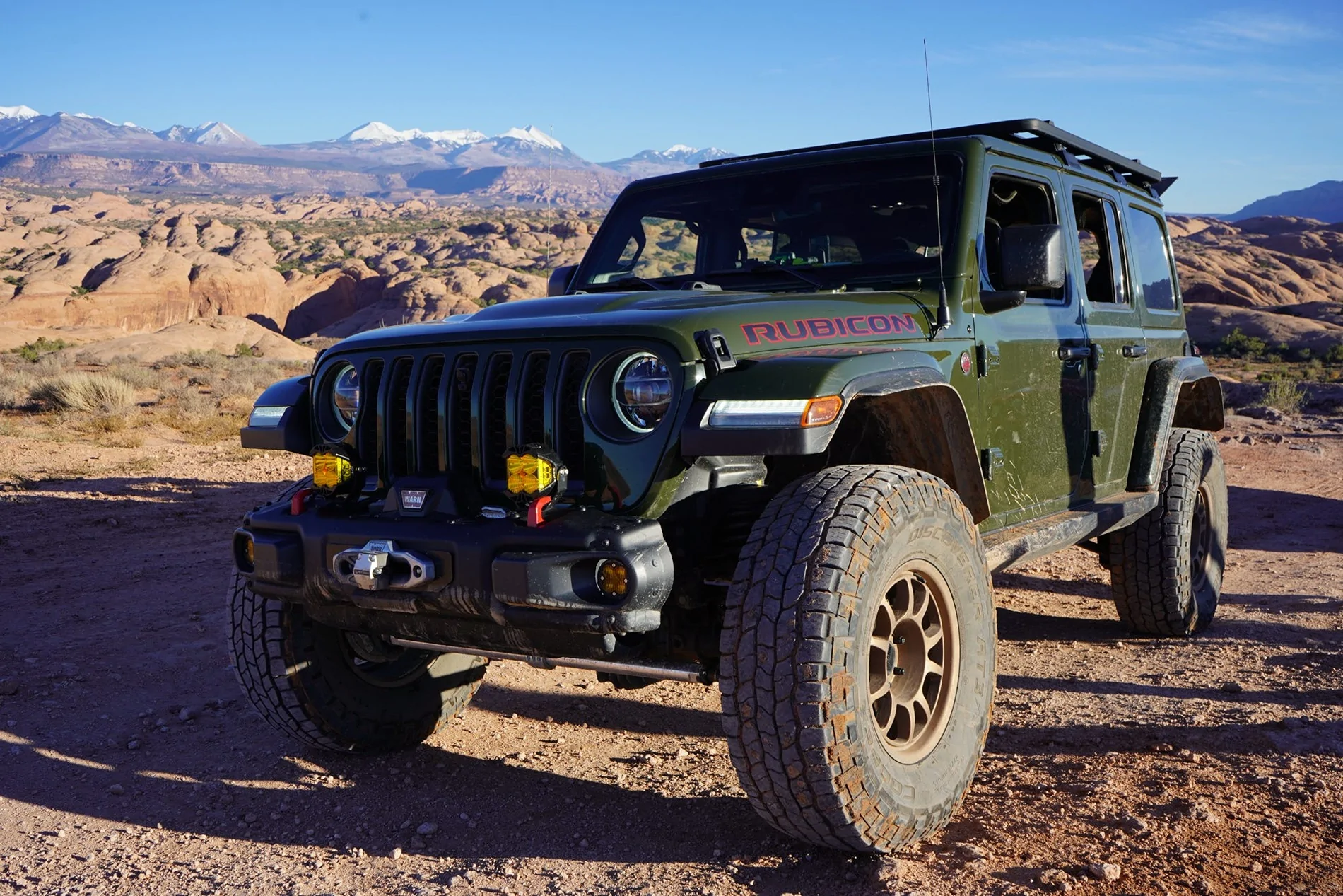

I have the LP4's on my front bumper and I think it's plenty of light by themselves. I'd recommend getting those first then deciding if you need more light. The LP6's would be good for high speed stuff to get light further down the trail but seriously the LP4's have been all we needed. I would recommend not putting the LP4's on the pillars because you will get a lot of reflection off the hood etc. I know they offer a block off plate to stop some of that but honestly I think they are overkill for the pillars. I also upgraded my fogs to the squadrons and they are great.

How much does the angle of the A-pillar lights affect hood glare? Looking to light up the side of the road/trail with those lights.
