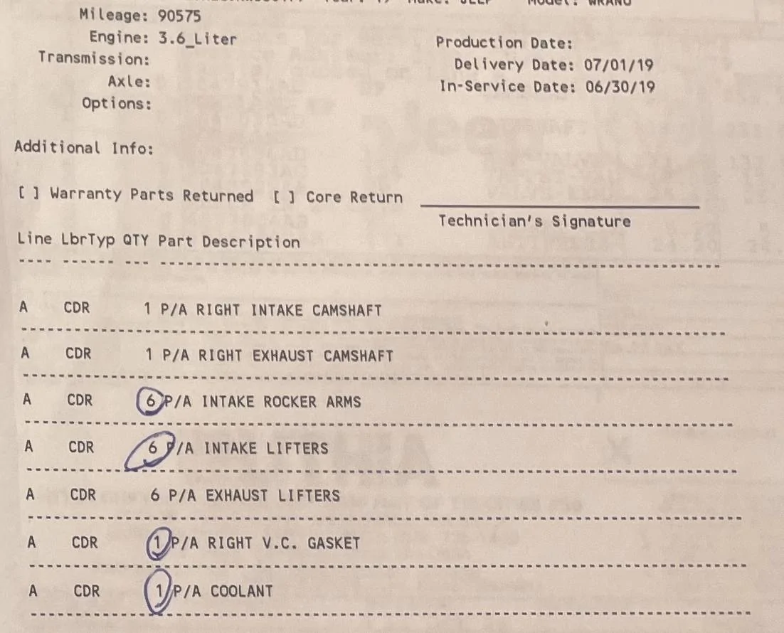

Pic of parts that need to be replaced (circled items they had in stock local)

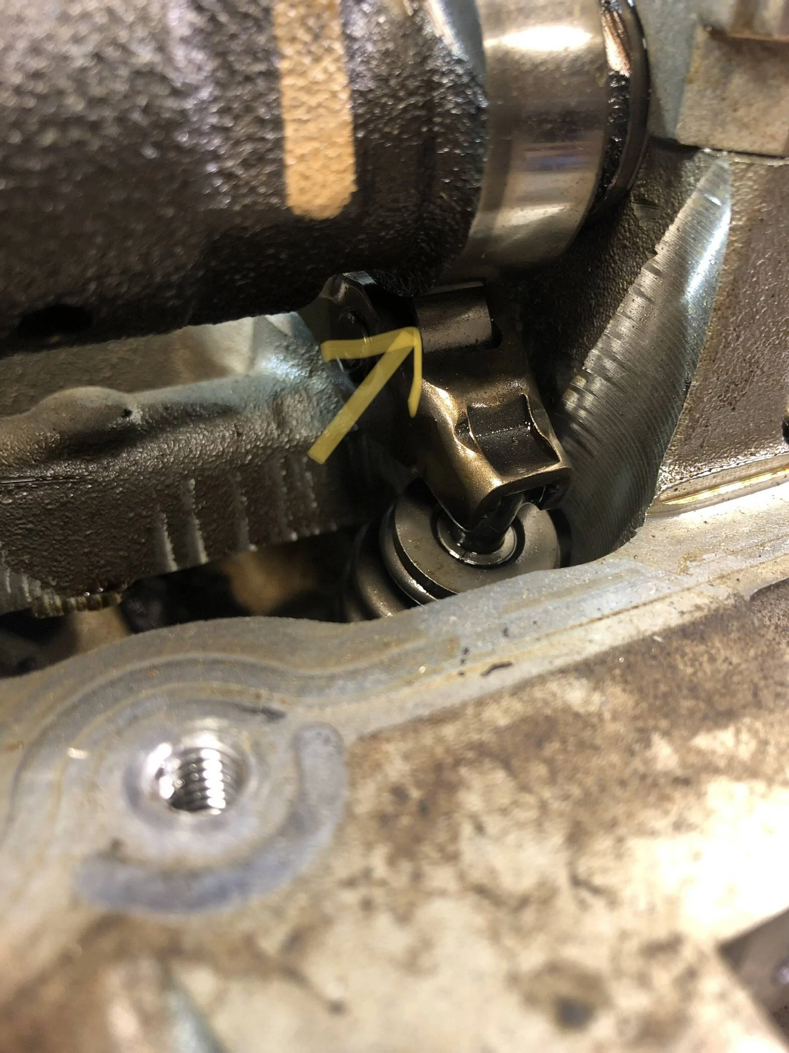

these roller bearings on the rocker arm fail:
Jeep Wrangler JL Lifter Tick image
then the cam lobe gets destroyed (sorry this one isn’t catastrophic)
if you catch it early, you just need to pull the valve cover, replace the rocker arm and lifter, and maybe do a little bit of cleaning. once the cam is damaged, I recommend engine replacement. It’s reparable but not guaranteed. If an oil passage gets blocked up with finely ground bits of camshaft, the VVT system wil stop functioning and you’ll end up in limp mode.

Yeah they said the camshaft was scored. They then told me exactly that - if I would’ve got it in right away the repair would’ve been smaller. When I told them I called it in right away and was told to come back in a month, he said that must have been before I got hired, I’ve been here a month ??‍♂
The cost wasn’t right at 3, I rounded, it’s a little lower but not much, 2.8 maybe IDK. Still. Not cheap.

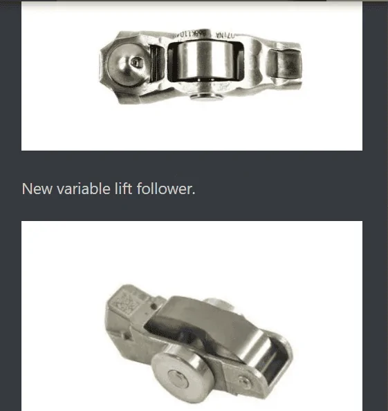

It should not have happened, because it is a new design in the PUG 3.6. The original 3.6 engine, the top pic, had the roller bearings fail. That failure on some started in a 2011 Jeep model, and then 2012 wrangler through 2018 Jk's. Jasper engine came out with a new design, for the JK's. It has a rocker pin that will turn with the bearings. Did that help...don't know...
Jeep Wrangler JL Lifter Tick Capture.PNG cam follower
The new rollers are only on the intake cam, and they still have small roller bearings in them.

Pics
Jeep Wrangler JL Lifter Tick 43473F47-DABE-46DC-894C-BA6592C263B0
Jeep Wrangler JL Lifter Tick 947BAE07-D516-44A8-840E-901D1AFD8E2B
Jeep Wrangler JL Lifter Tick 1025EFDB-7414-485D-B640-68D15533D0DF
