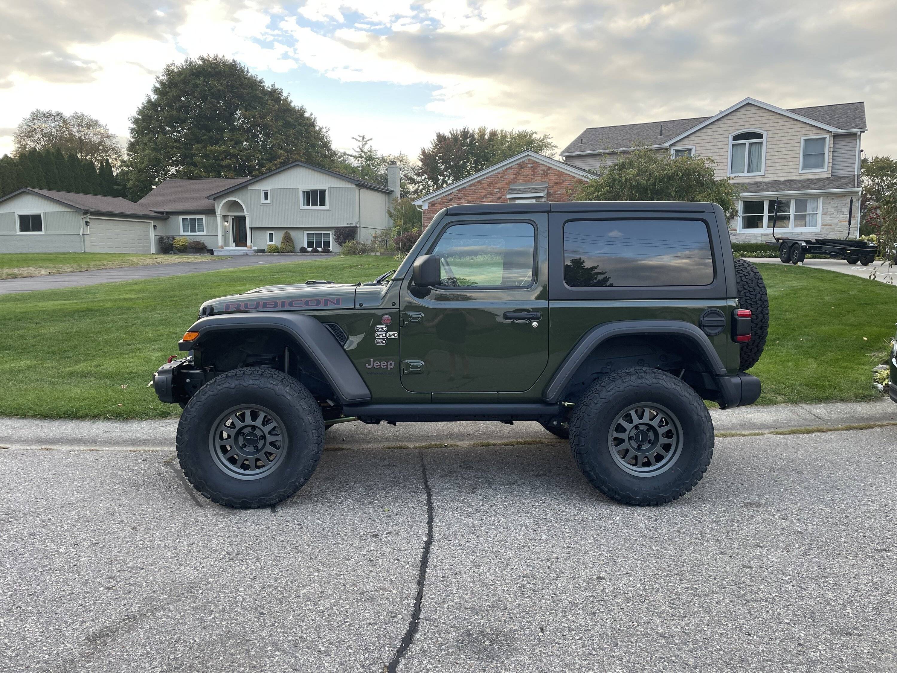

If it helps, here’s my two door on a Metalcloak 2.5” Gamechanger Suspension and 315/70r17 BFG KO2’s.
BFG is notorious for their tires running small, so basically any other tire will look larger than this. And with the Sahara fenders, you will lose about 1” of the gap I have between my fenders and tops of my tires. I could easily fit 37’s with my setup, and many others on the forum do.
Also, the gap can be deceiving in photos without a true side shot. Maybe go to a Jeep club event and check out some rigs with setups you like and ask the owners what they’ve got. Everyone loves to talk about their setup, and you’ll likely get some honest feedback on what they like/don’t like and how they would do it if they were to start from the beginning again.

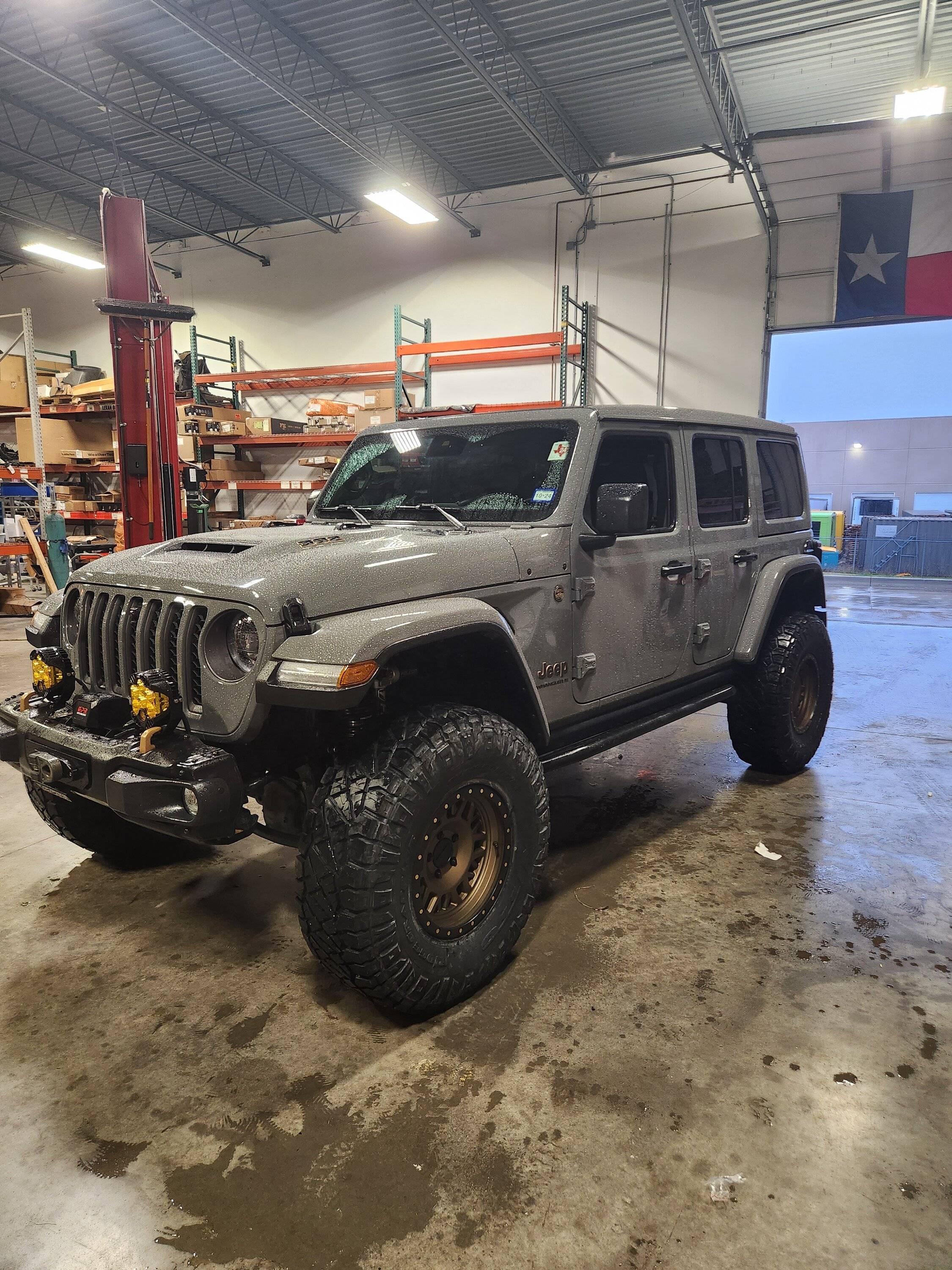

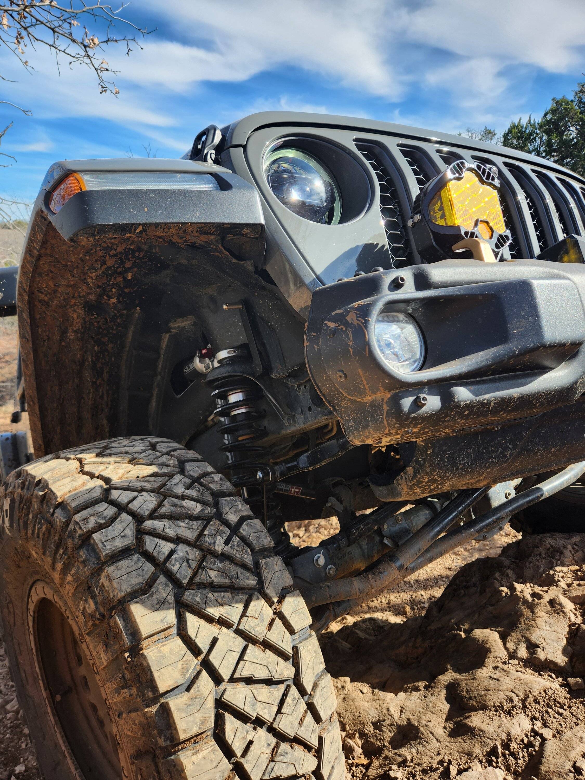

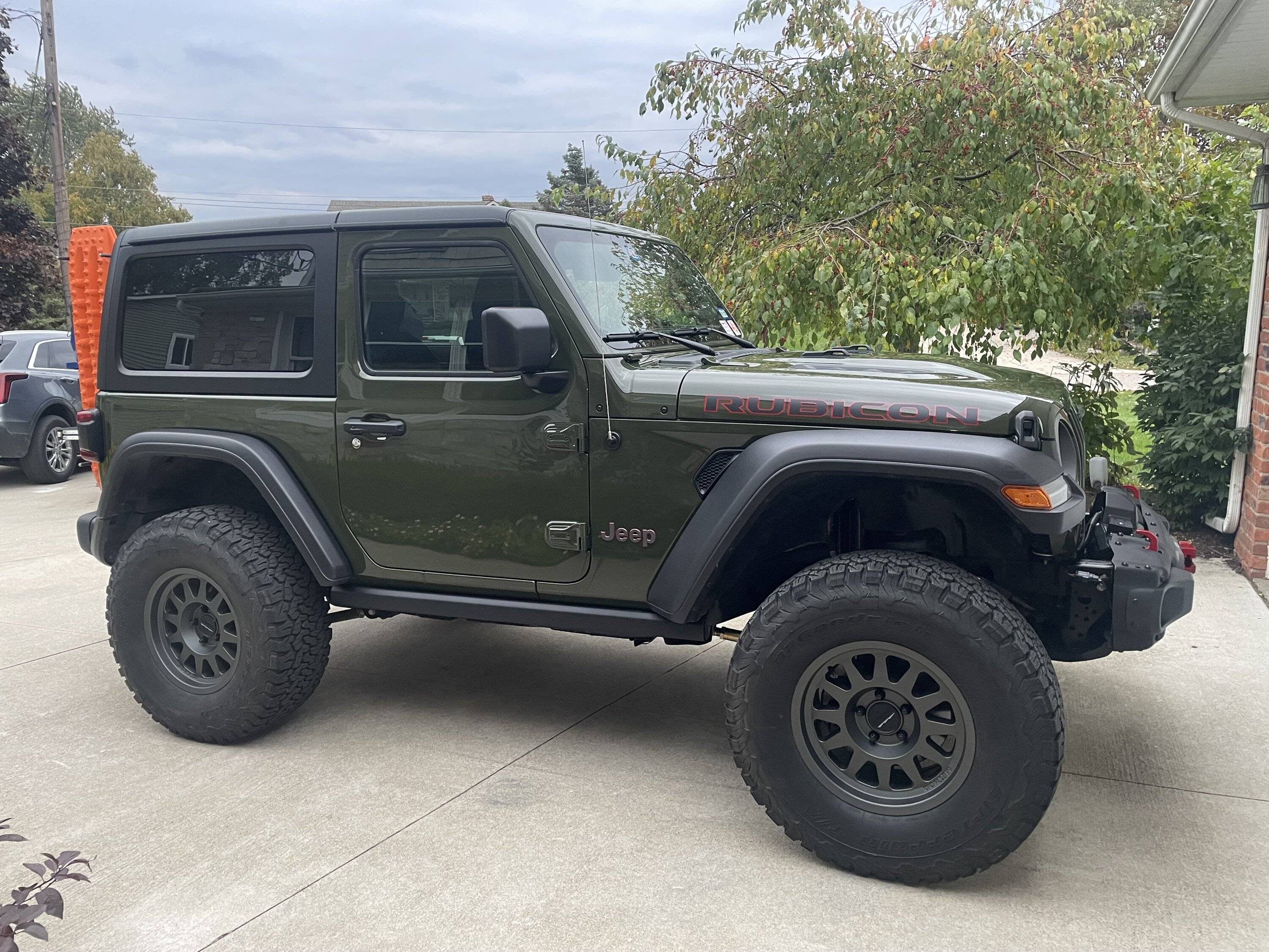

You will always want 37s no matter what you get next so go with 37s. A 4'' lift you will likely need new wheels or spacers. I really wouldn't dive into this, without the proper budget, if you want it to drive properly on and off road. Wheels, tires, lift with adjustable control arms, gears, shocks and labor you are looking at 10-14k and you still won't have the proper axles.
It all really depends on what your goals are with this Jeep and what you budget is. As an example, I really wanted a long arm kit but it wasn't in my budget. I ended up going with the Teraflex 3.5 RT3 short arm /Falcon 3.3 kit and absolutely love it.
Only you can ultimately decide what works for you. You can usually piece a kit together and save money but I wanted mine turn key out the door. I would seriously look into a 2" kit.
