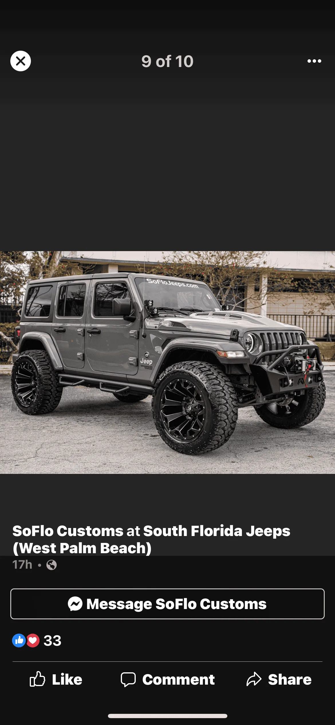

Nice ride. Ok what does a long arm mean. The quote is for Teraflex 2 arm kit 69-6836?
Jeep Wrangler JL Lift with 37s 1708524289016
