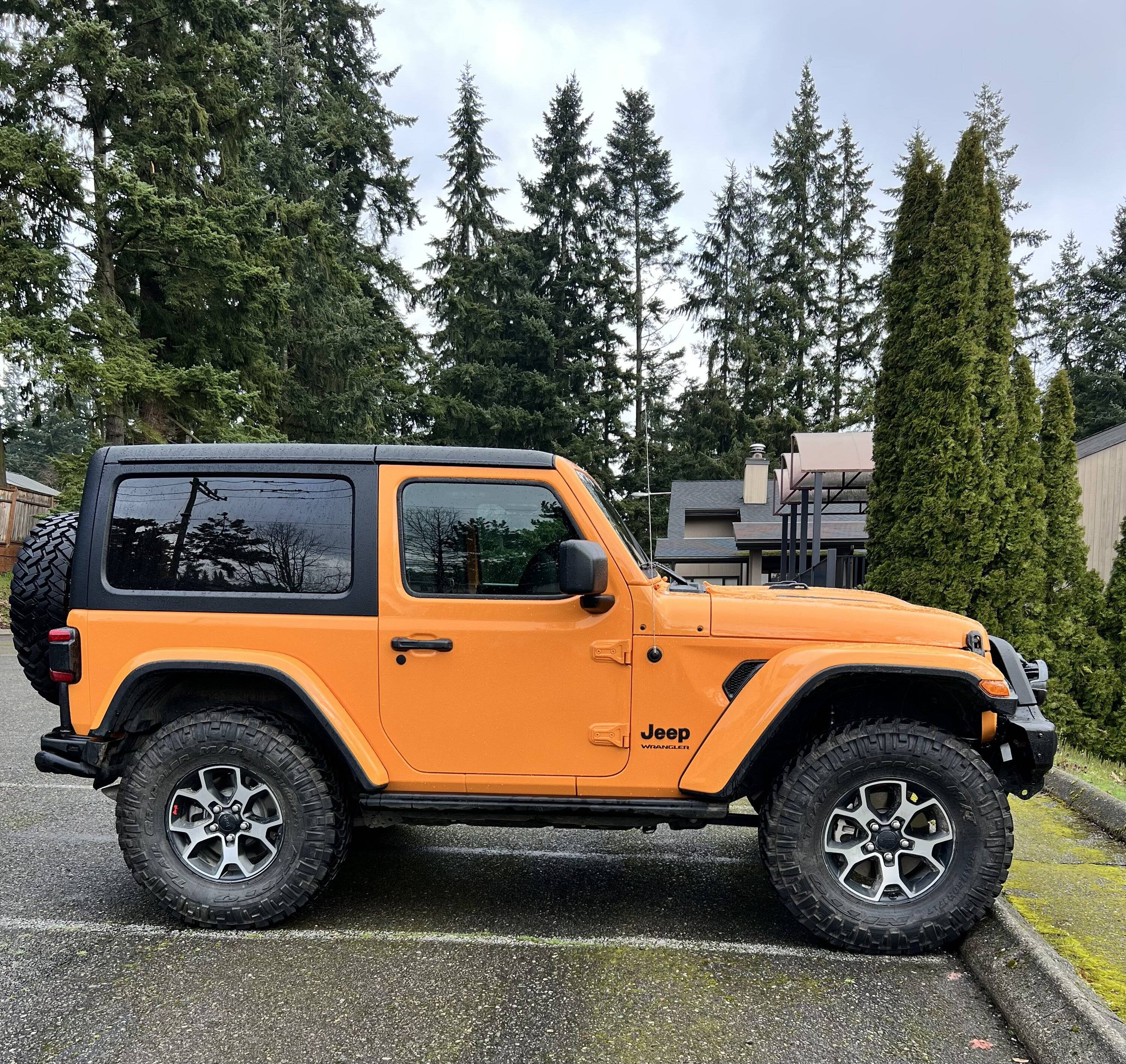

I'm on 33's with the Mopar 2.5 lift. It is much closer to 3+' but I'm satisfied and would do it again.
Looks good! I thought it would look small but the sport fenders make the tires look a little larger.

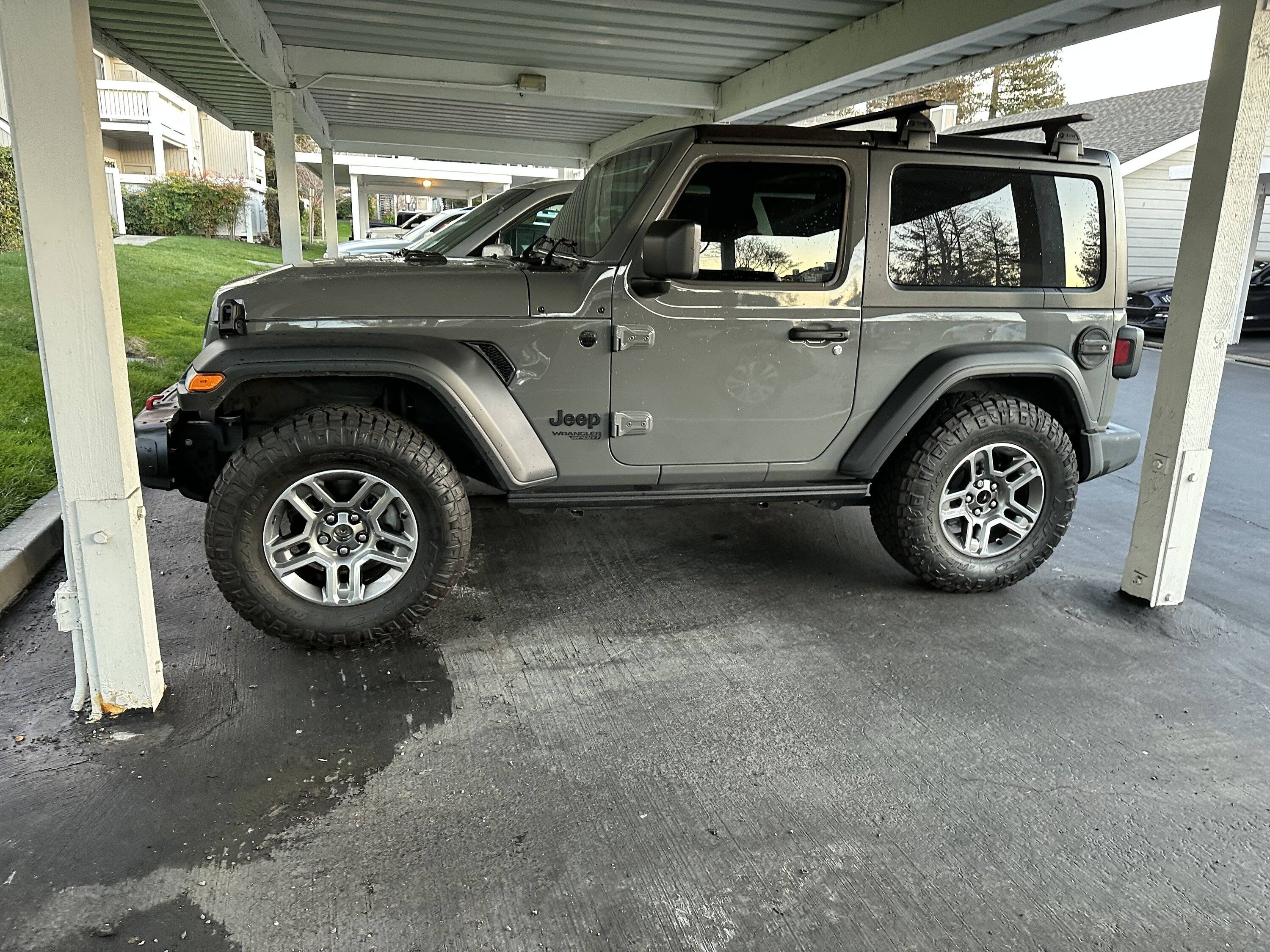

Here is a pic of mine with TF 1.5 2door lift with extra 0.5puck in the back. This is before I added a winch. Was mostly level and still is mostly level.
