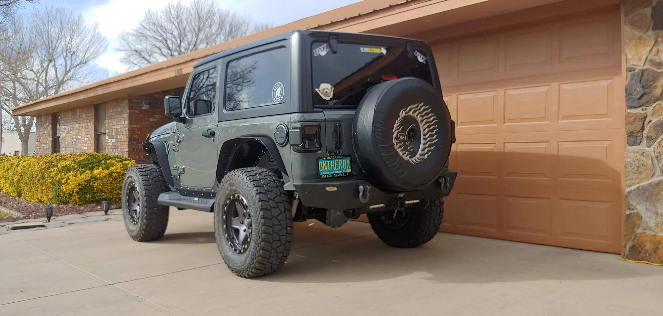

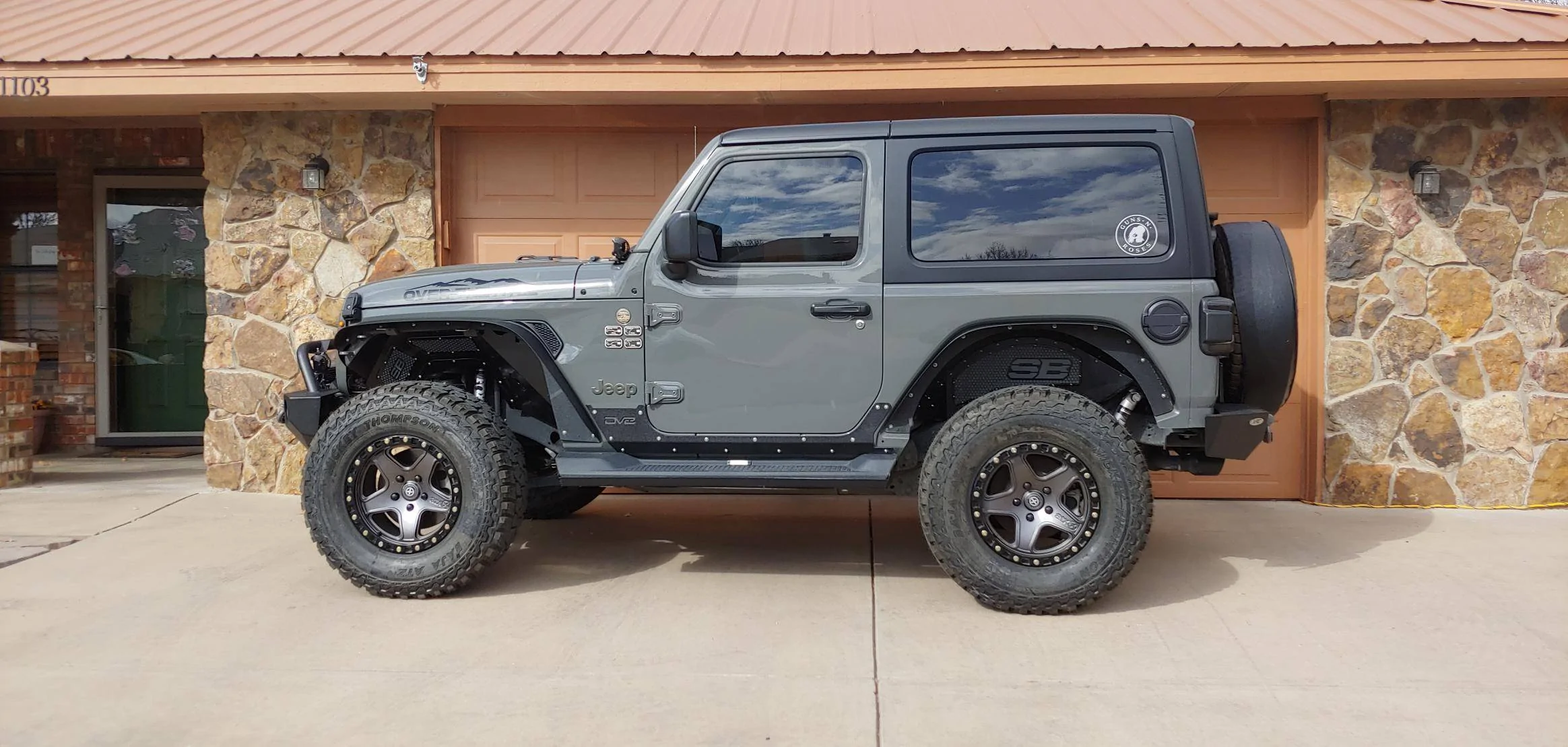

Ibrahim, I may not be a lift 'purist' because I just went with the dealership installed Mopar 2.0" Lift on my 2019 JL 2-door Sport. No adjustable track bars, just the plain Jane Vanilla standard kit. Ended up with a little over 2.5". But after putting on 35's along with a Teraflex Swaybar Quick Disconnect Kit, I couldn't be any happier. Rides great, both on and off-road. I love it.
I know I post this pic a lot, but it shows where I can easily take this thing. This is on the Wheeler's Lake Trail, northwest of Alma Co, just after the V-Notch obstacle. On that day our Jeep Patrol assisted the U.S. Forest Service in putting in several winch points.
Many Jeep's, including non-stock Rubicon's, find this obstacle pretty difficult. The winch points were being installed specifically for that reason.
However, I have never yet had any trouble navigating this obstacle with my Sport on open diffs. The added clearance, all-terrain rubber and the disconnected swaybar certainly makes a big difference in my capability.
No matter which lift you decide, you won't regret it. Getting far off the beaten path is so much worth every penny.
