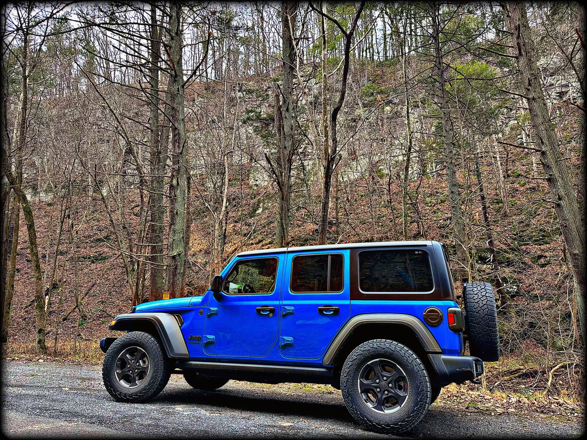

Morning! I’m having a hell of a dilemma with figuring out a lift for my 22’ JLU. I don’t want to go crazy high just something around the popular 2.5”. When I research I’ve seeing a bunch of installing the lift and then changing this and that and it seems like a never ending process. I’m looking for something to install and go. I know budget is a huge part in this but speaking of budget, that’s my dilemma. I’m trying to decide to either go with a lift on my JLU or trade in for a Mojave Gladiator because they’re crazy rebated right now. Can someone please help me out. I don’t know a whole lot about the jeep lift kits as this is my first jeep. TIA pic is my Jeep currently
