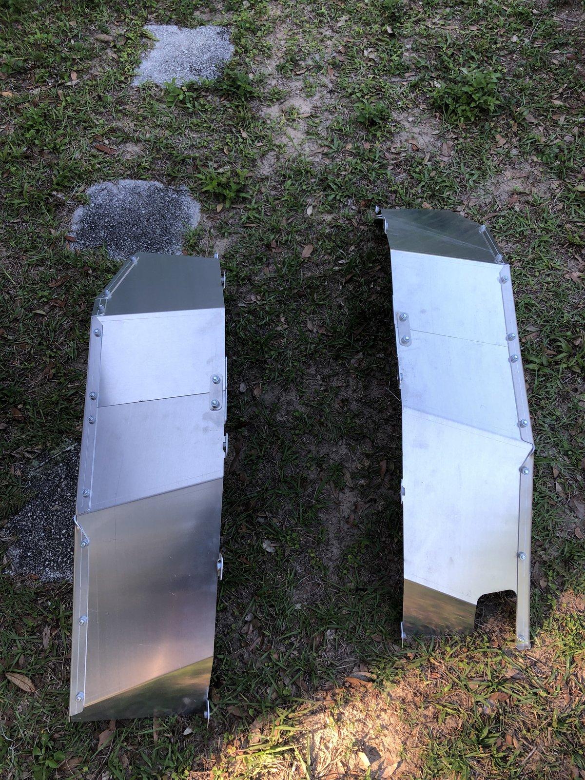

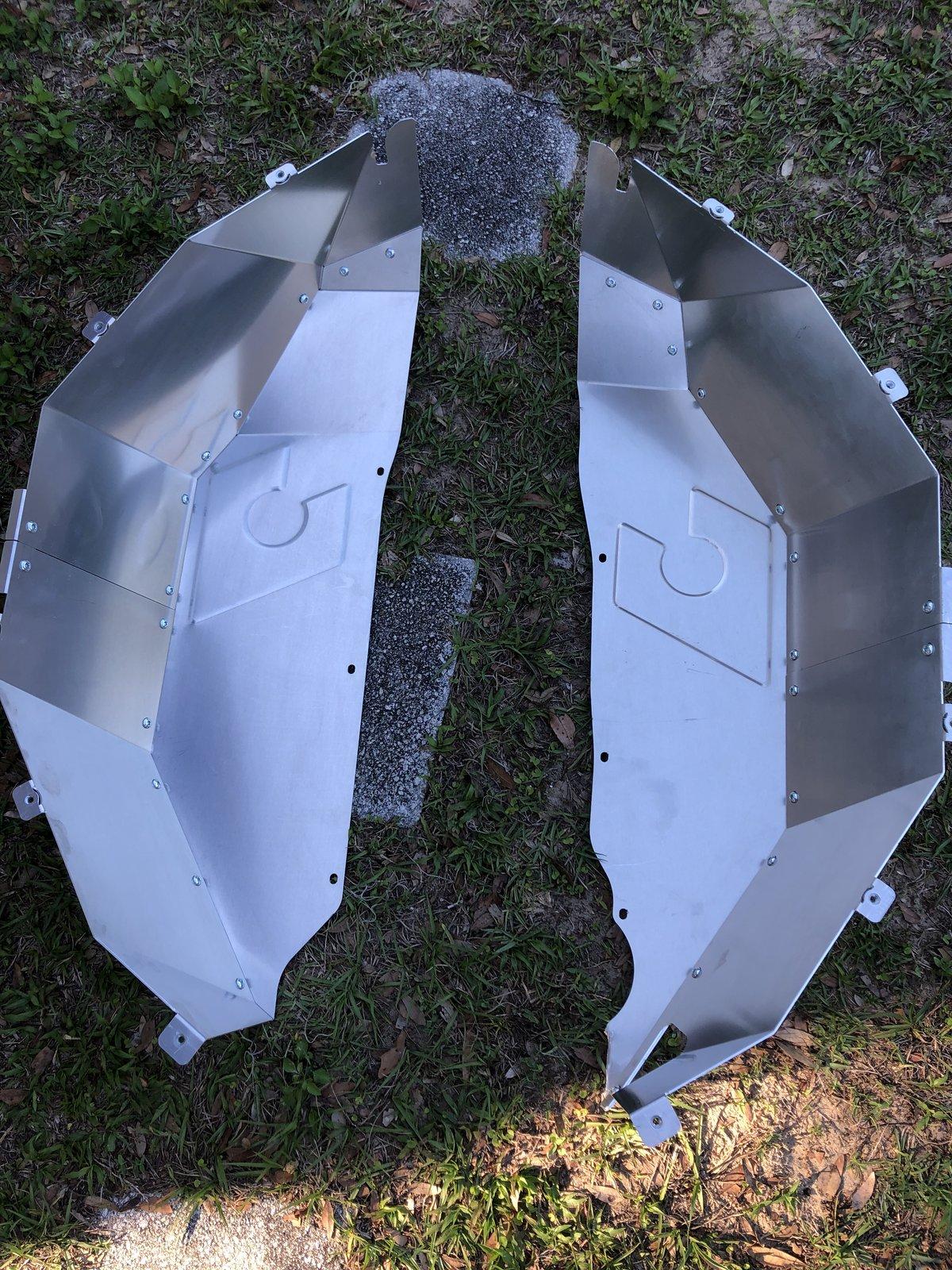

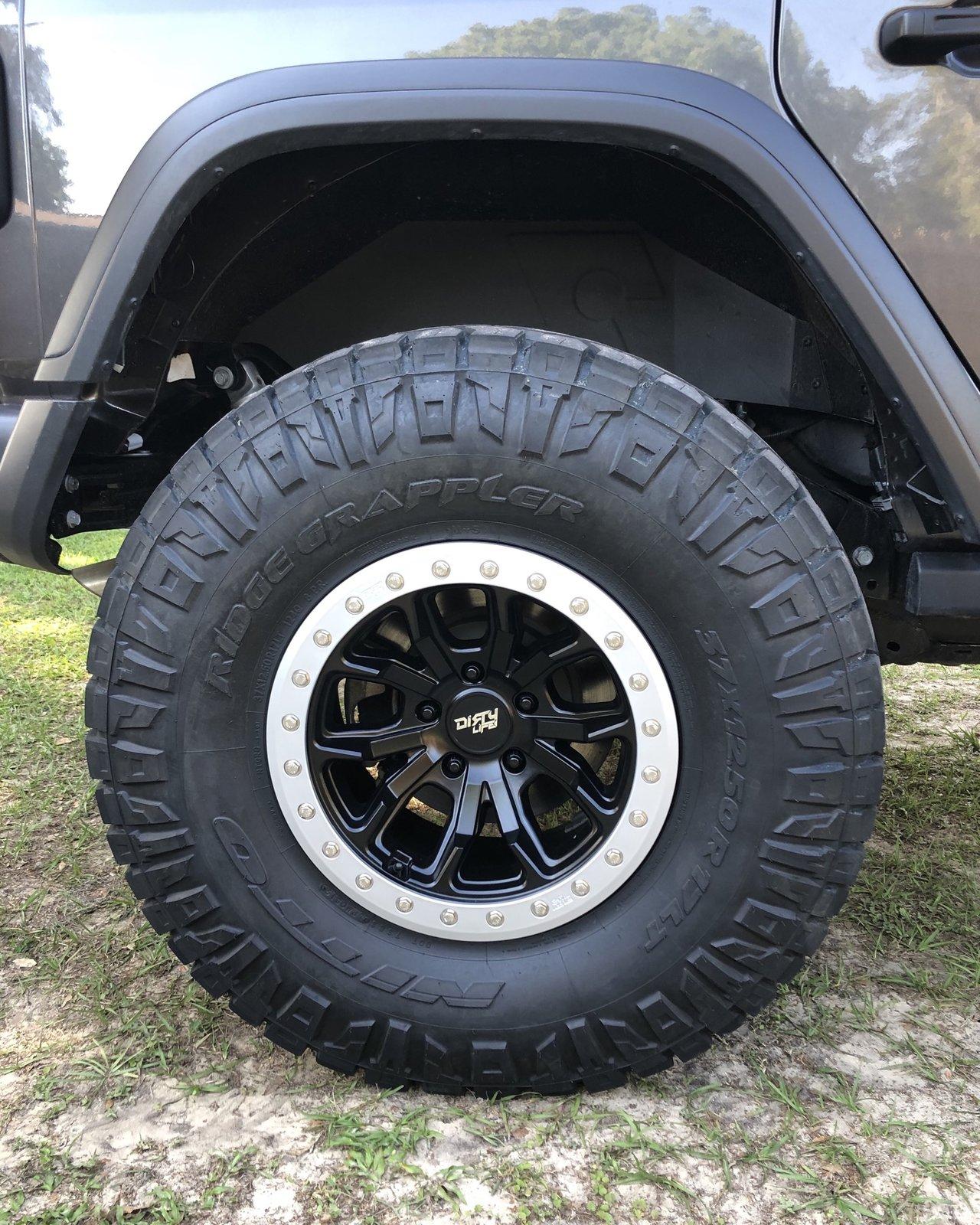

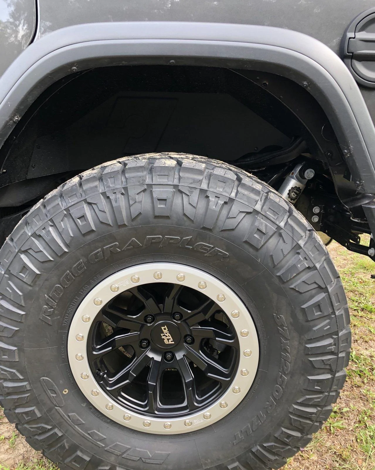

If you plan on wheeling your rig and anticipate getting full flexed, I would recommend getting rid of your rear inner fenders and replace with artec or dv8, because you’re going to rub, I did and I’m at 3.5”. You can use longer bump stops but I didn’t want to restrict my flexibility. They recommend 2” bump stops for 37” tires with that kit, also a rim with 4.5 “ backspace is also recommended. You shouldn’t have any problem in the front, the rubi’s high line fenders really help. Here’s pic.
Jeep Wrangler JL lift and tires 4C987BC8-D0B1-482B-9897-474C8B119634
Jeep Wrangler JL lift and tires 3EDA98AC-7E4C-46CD-B199-525A18DA183B
Jeep Wrangler JL lift and tires 58861DDF-B69D-4EE8-8AC9-38D7A8127CB4
Jeep Wrangler JL lift and tires 30C646B2-8722-4DE0-A425-7F46168F9AD9
