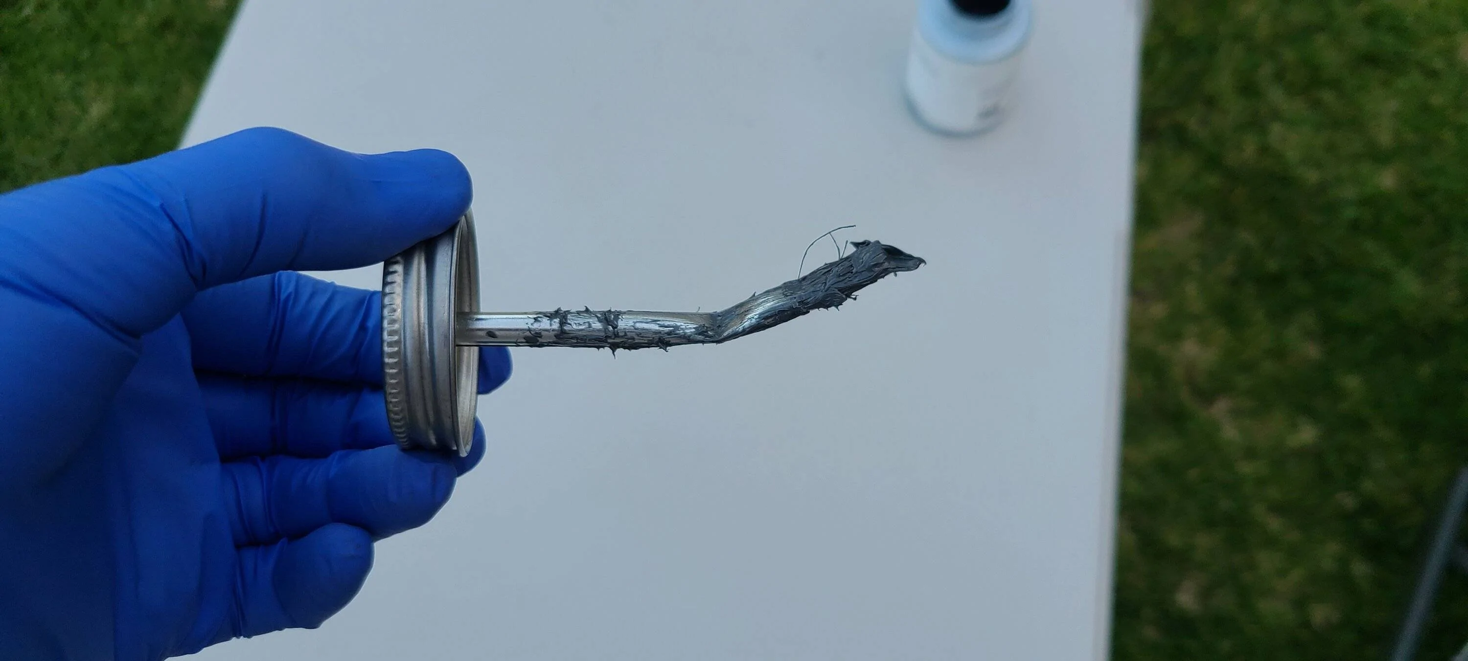

Anyone know how they make these? Every can of anti-seize I've had for about 50 years has looked like this, regardless of brand. It's fascinating. How do they do it?
