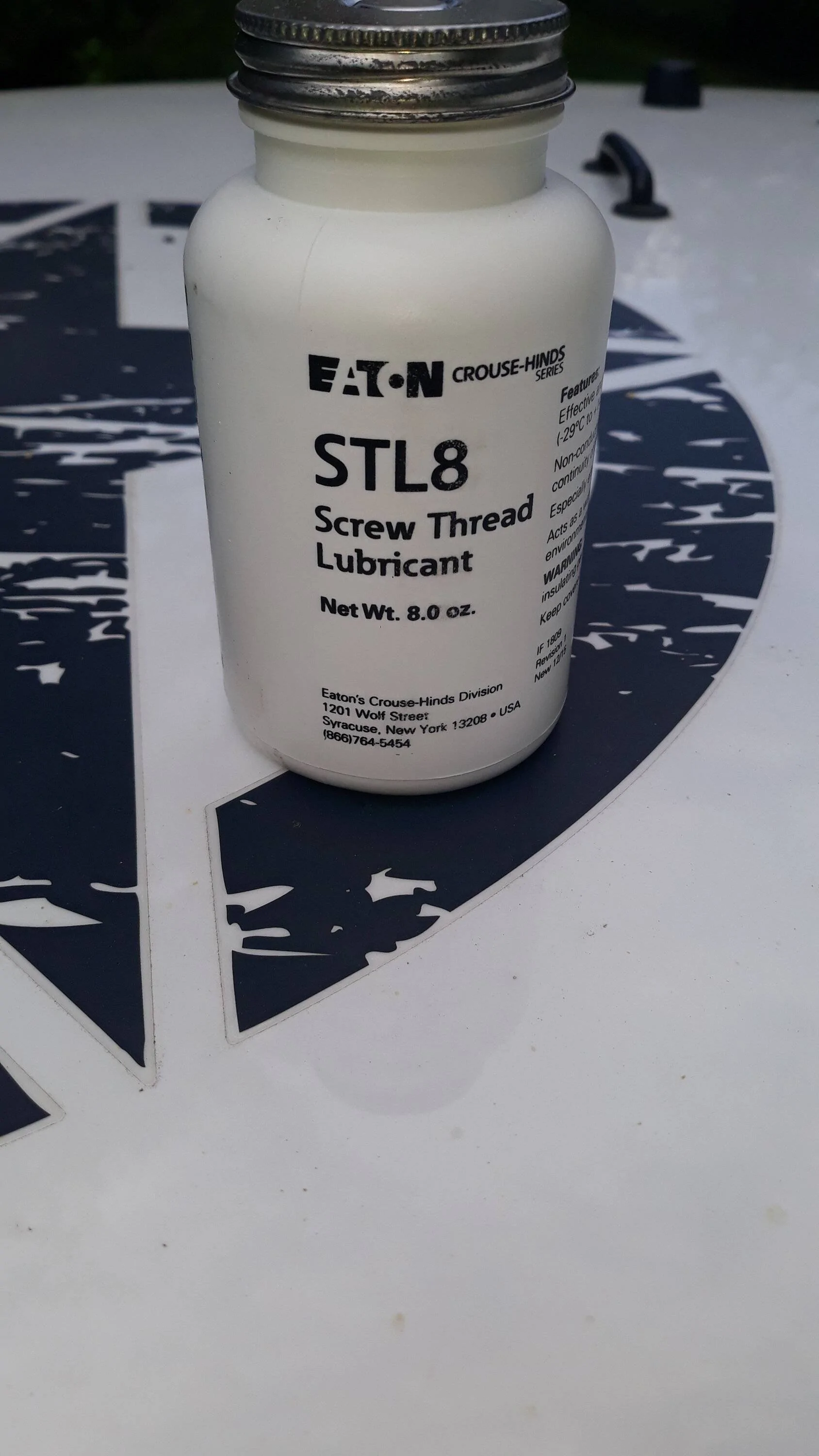

Or Salem/Hope creek, Oster Creek... been in a few. I'm sure mcmaster has it if you really need it.
With the exception of nukes and bakerys this is what just about every plant, refinery, power house specs.
