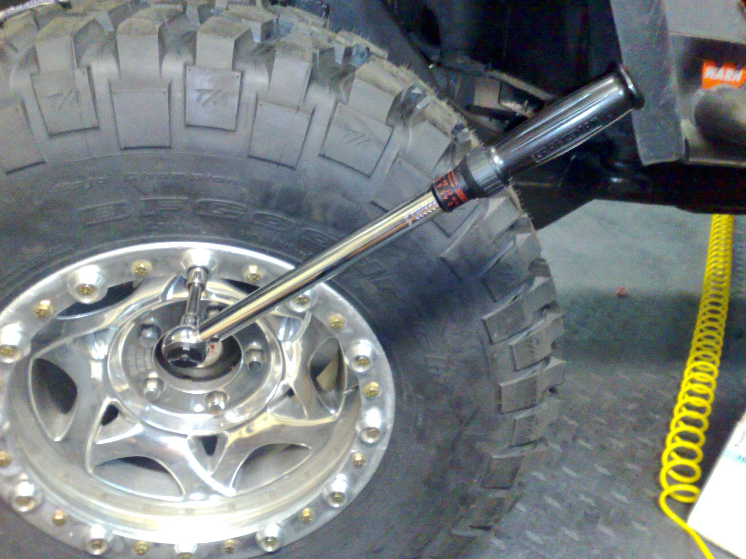

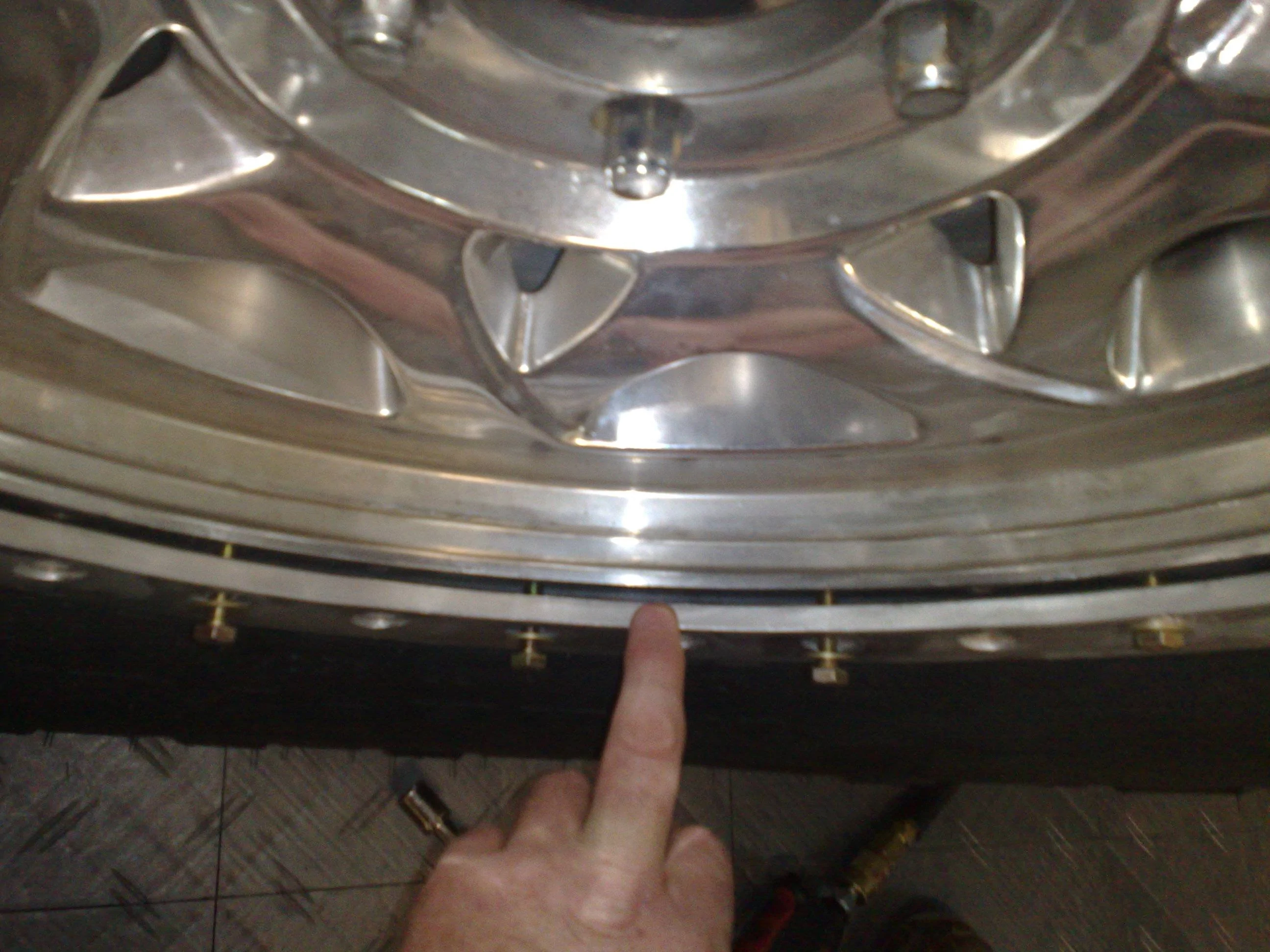

Here is the procedure I use: I torque down and I do it based upon my Lock Ring distance from the wheel rim. This require a very slow pace, around 1/4 turn of the wrench at a time going clockwise back and forth across opposite the sister botls around the diameter.
Look at this pic and to the right of my finger you note the ring is closer to the wheel to the left is a bit more wide as I am going around the wheel at this point and I turn the torque wrench 1/4 turn at a time after I have started with my finger, this is the point at which I switch to the torque wrench.

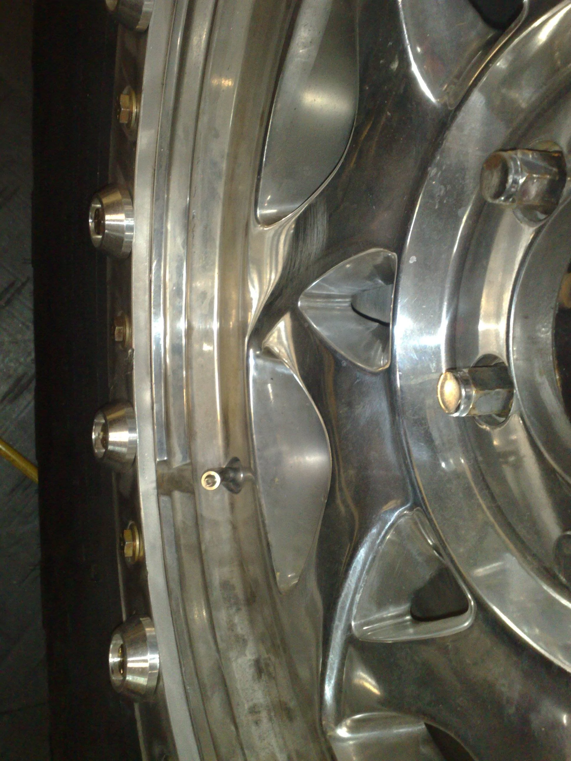

These are the Rock Bolt Rings I ran, I got tired of beating my bolts heads on the rocks to the point I had to hammer on the socket, another reason why I replaced bolts x 2 yearly
Jeep Wrangler JL Lets talk Anti-Seize 21102008129
Here you can see how they stick out, they will climb the rock, one of the best investments I ever made for rock crawling
