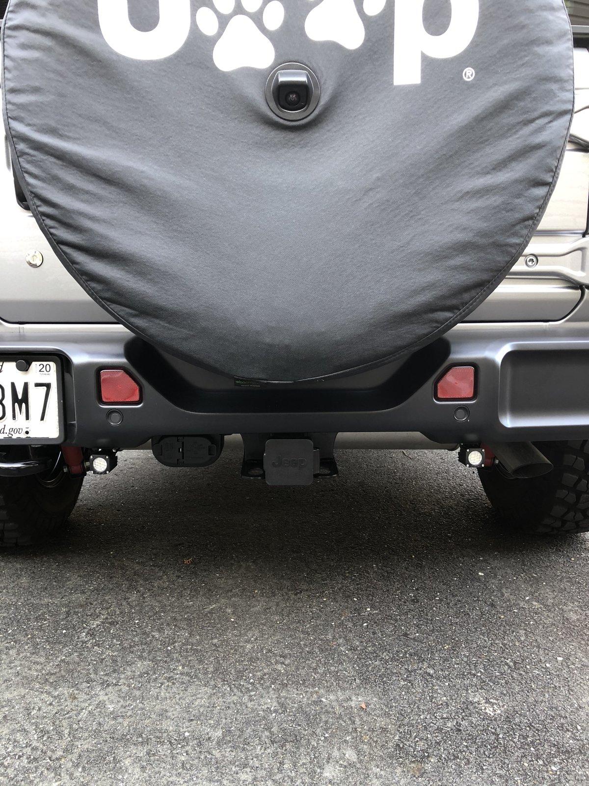

I have the LED lighting package. I want even brighter reverse lights. I ordered the LED 1000 Lumen upgrade, but now I am wondering if it is only for upgrading non-LED lights. Yes, I should have figured this out before ordering. Thoughts on upgrading existing LED bulbs? If that isn’t a good idea, what’s the best “integrated” solution? I have the factory auxiliary switches. ;-)
I added a pair of Ignite backup light cubes underneath my rear bumper. They are wired in with the two diode solution mentioned throughout the threads so they come on by going into reverse or manually switched via an Aux switch. This allows them to be used independently of reverse so I can use the for connecting up a trailer. They are small and tuck away nicely, IMO. Used existing bumper screw holes.
Jeep Wrangler JL LED reverse/backup light upgrade from stock LED upload_2019-12-30_10-5-29
