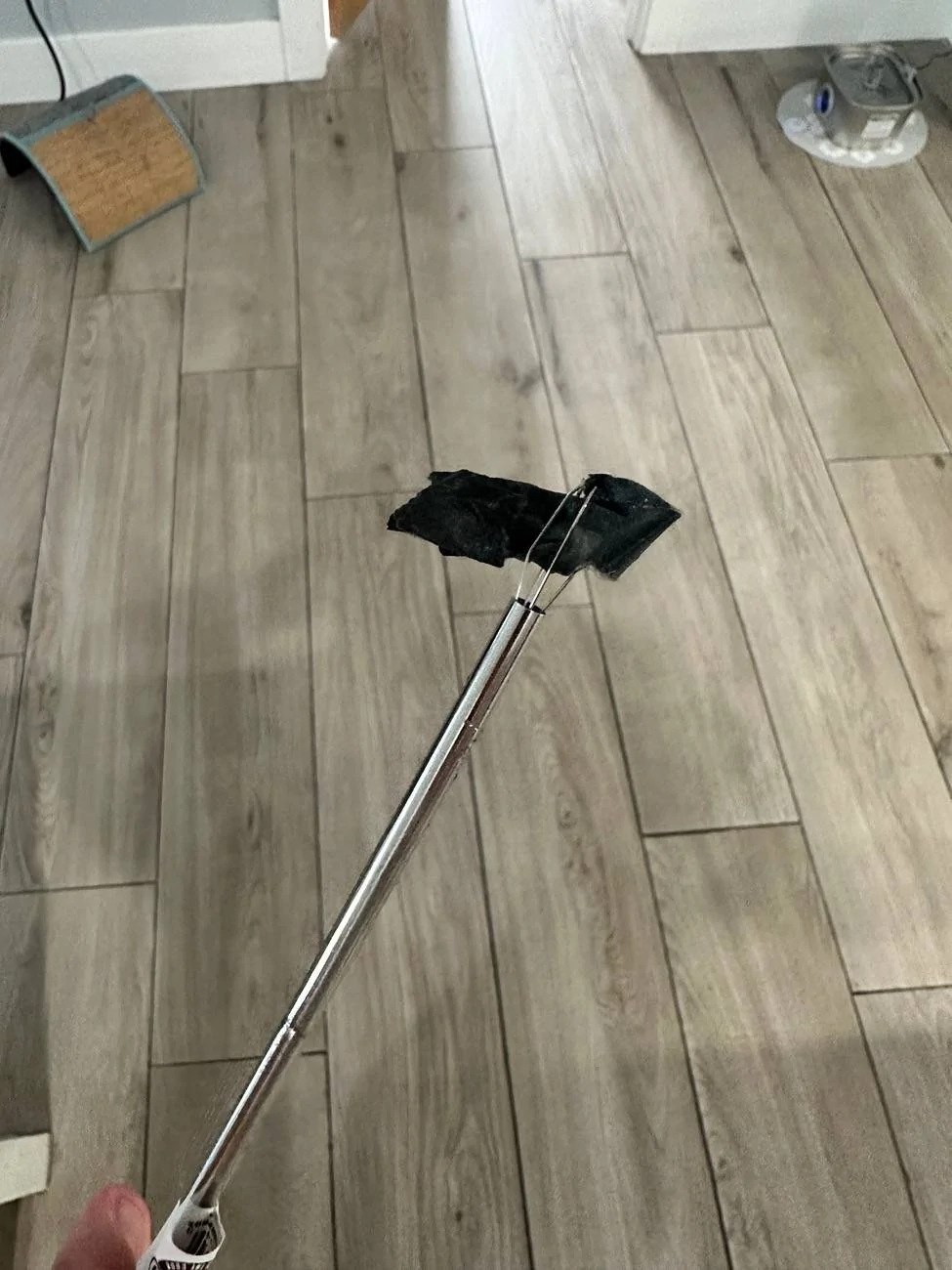

My AC started making a slight farting noise after replacing the cabin filter. I thought it was because I put the two piece filter in wrong but I reseated them and it was still doing it. I had read this thread the other day so got out a flashlight out to look for debris and found a leaf. Grabber thing FTW!

ok I googled it and you’re kinda right!

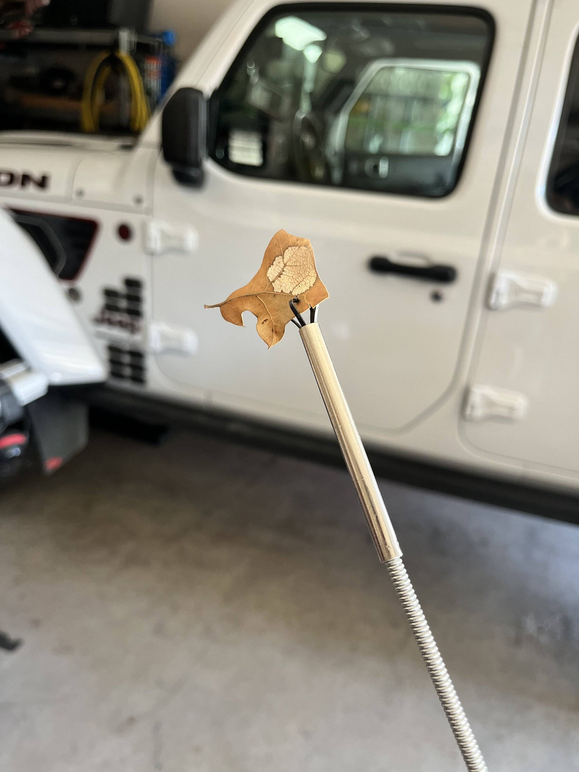

2021 jeep wrangler here, I replaced the cabin filter and same thing happened to me. Shoutout to the person who recommended a “pickle picker”. I was about to lose my mind lol
