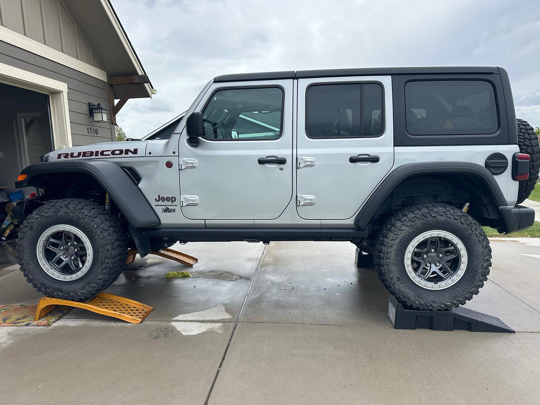

no it won't cause lift but it will cause bind. absolutely put it on the ground under its weight loosen everything and rock it side to side a few times and them retorque..if you need more room run it up on some ramps...
Jeep Wrangler JL LCA torquing when doing lift tempImagefktjG6
