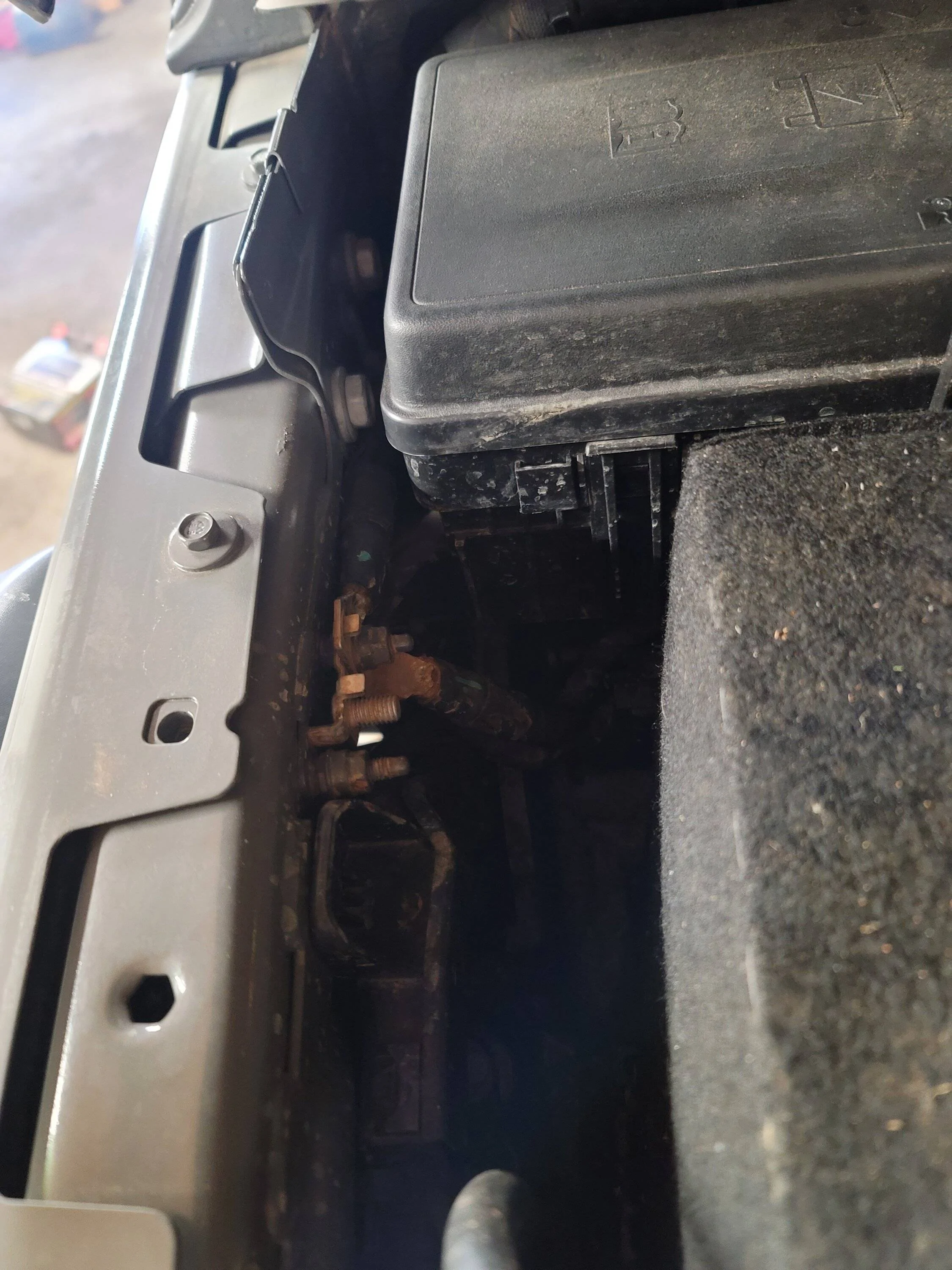

So would this point be sufficient then? Looks like a chasis ground if I'm not mistaken? Your story is exactly why I'm asking lol, I'm leaving for a vacation in a day and don't want anything messing up my plans!

Yes, in fact that is the de-facto place. In fact it is because that place exists, with its placement on bare metal and having a cable to the negative terminal of the main battery that allows the vehcile's bare metal to all be a grounding point, and allows Bill's quote @Yawnie'sPapa , "any bolt or other part that is bare and not painted. Doesn't matter," to be true.

If you look under the hood of a WK2 you will find two spots to connect to to jump the vehicle Both at the right fender in the engine bay. One red, one black. You aren't even close to the battery there.
The black capped one on a Grand Cherokee sure looks a lot like the chassis ground points on a Wrangler or Gladiator.
I go engine block/head/bracket, whatever but the fact that Jeep also supplies those things for jump starting in other Jeeps, or as ground points for accessories says "use this".
My JT's ground points along the right side are buried under my winch solenoid bracket plow fuse, 12v outlet, and the bracket I made to hold the aux switch terminal block I installed.
