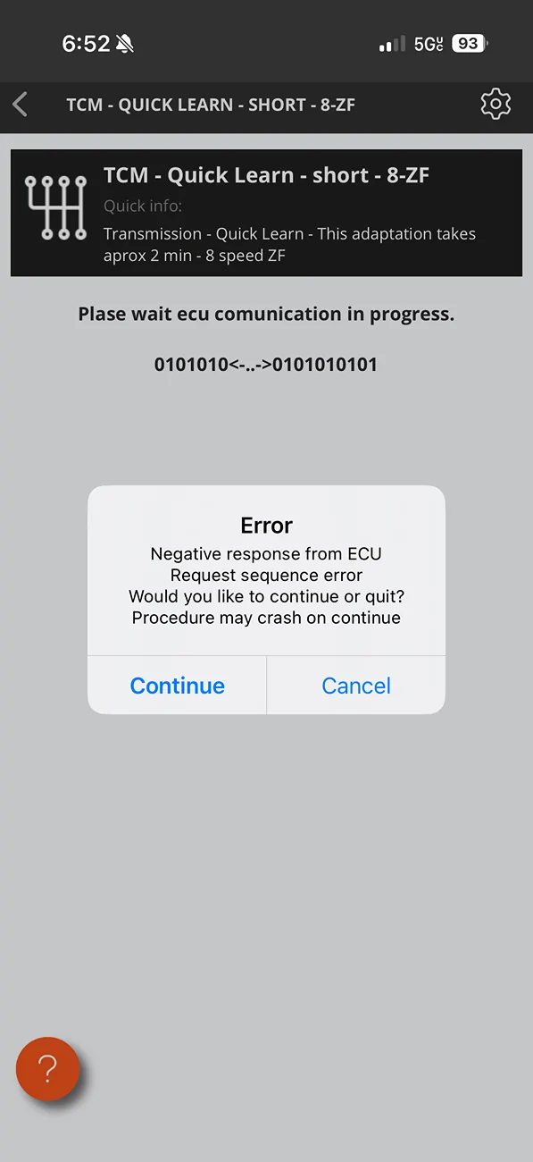

Are we supposed to do the long or short quick learn on this? When I select short it says “may not be supported on this module” but will let you continue until you get to the gear shift movement and then once you press proceed it says “negative response from ECU”. Are we supposed to do a long quick learn instead?
Using an OBDlink MX+ and a security dongle.

Transmission learn function is technically only supposed to be used after a transmission repair to reset adaptives like you’re doing a valve body repair or the like. Otherwise, there’s really no need to do it.

Understood. Just trying to reset the previous owners driving habits that it learned over 50k miles. I’m weird like that I guess lol.

The whole “habits” thing is a complete myth and blown out of proportion on forums. The only thing the transmission “learns” and saves for true long term measurement is what pressures/times/apply rates that are required in order for the transmission to complete the shift process in the time/rate that the TCM is expecting to manage heat, slip, and proper shifting. Shift schedules remain unchanged.
By resetting adaptives, your transmission has to learn its condition essentially. Has nothing to do with driving habits, just bad info that has been thrown around forums for years.
