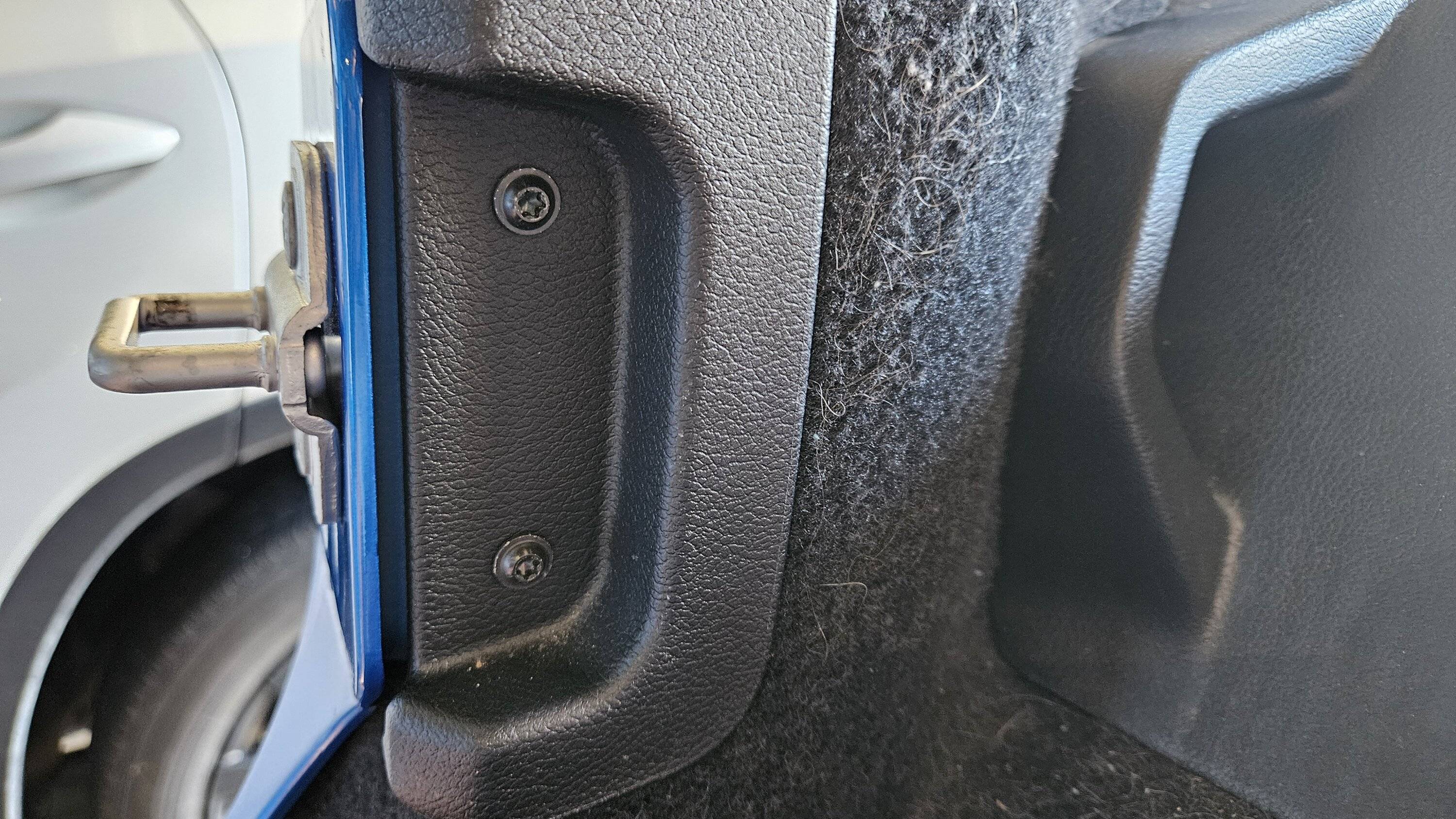

These are pretty easy to do. On either side, next to the door hook, there's a plastic trim piece. It has 2 T25 screws in it. If you opt to just remove it, note that there's a clip in the middle:
Jeep Wrangler JL "Joyride" Hydro JLUSA Build Thread 20240203_144342
If you break the driver's side one like I did, here's the part information:

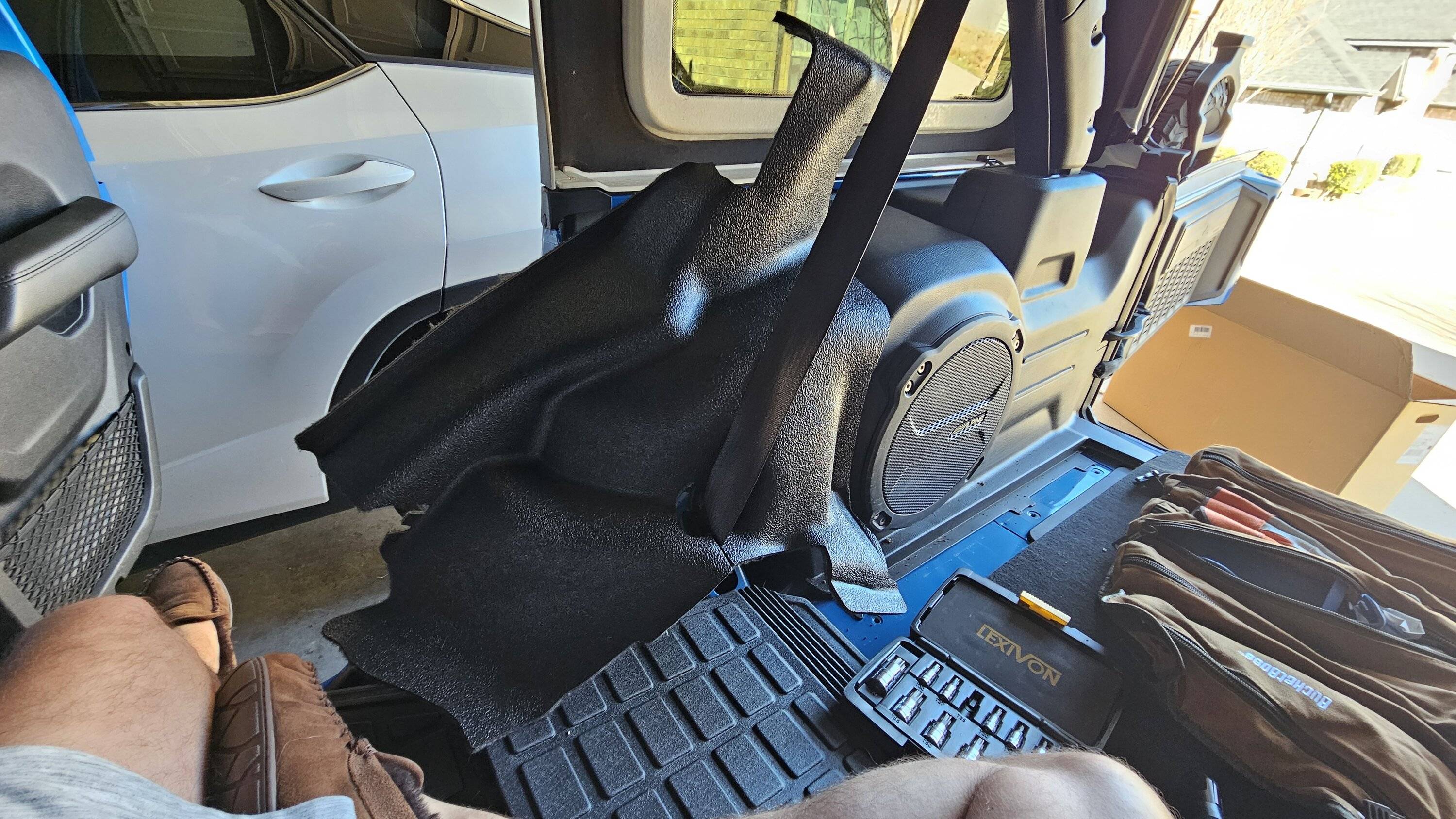

You also need to remove the tie-down boards on either side of the cargo hatch. Once I got these off, I was pretty annoyed with Jeep - they're literally just hard plastic pieces with carpet glued onto them. It would probably be pretty easy to change them out with wooden or metal replacements and then cover that with Raptorlining or similar.
Jeep Wrangler JL "Joyride" Hydro JLUSA Build Thread 20240203_144516
This is how the passenger side one goes back in - it took me about 5 minutes of turning it various directions to match it up. Note that I have the subwoofer - yours will look different if you don't. I *did* also loosen the one T25 screw holding the subwoofer down, but otherwise, just use a trim tool and push it in underneath everything. Pretty easy, really. I did the back first and then got the front in, but I don't know that it matters either which way.
Then do the same on the driver's side. There's a grommet behind my toolbag, which they provide. It's helpful to line it up. If you have two people for this side, that would be helpful, as that black trim at the back doesn't move much. I wound up having to stand in the back of the Jeep and just pull it toward the back to get it to fit under there.

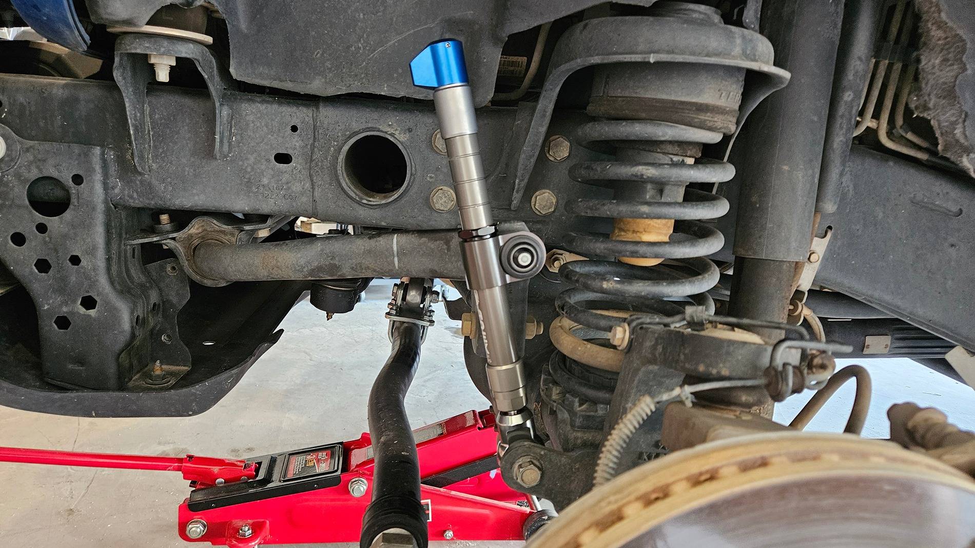

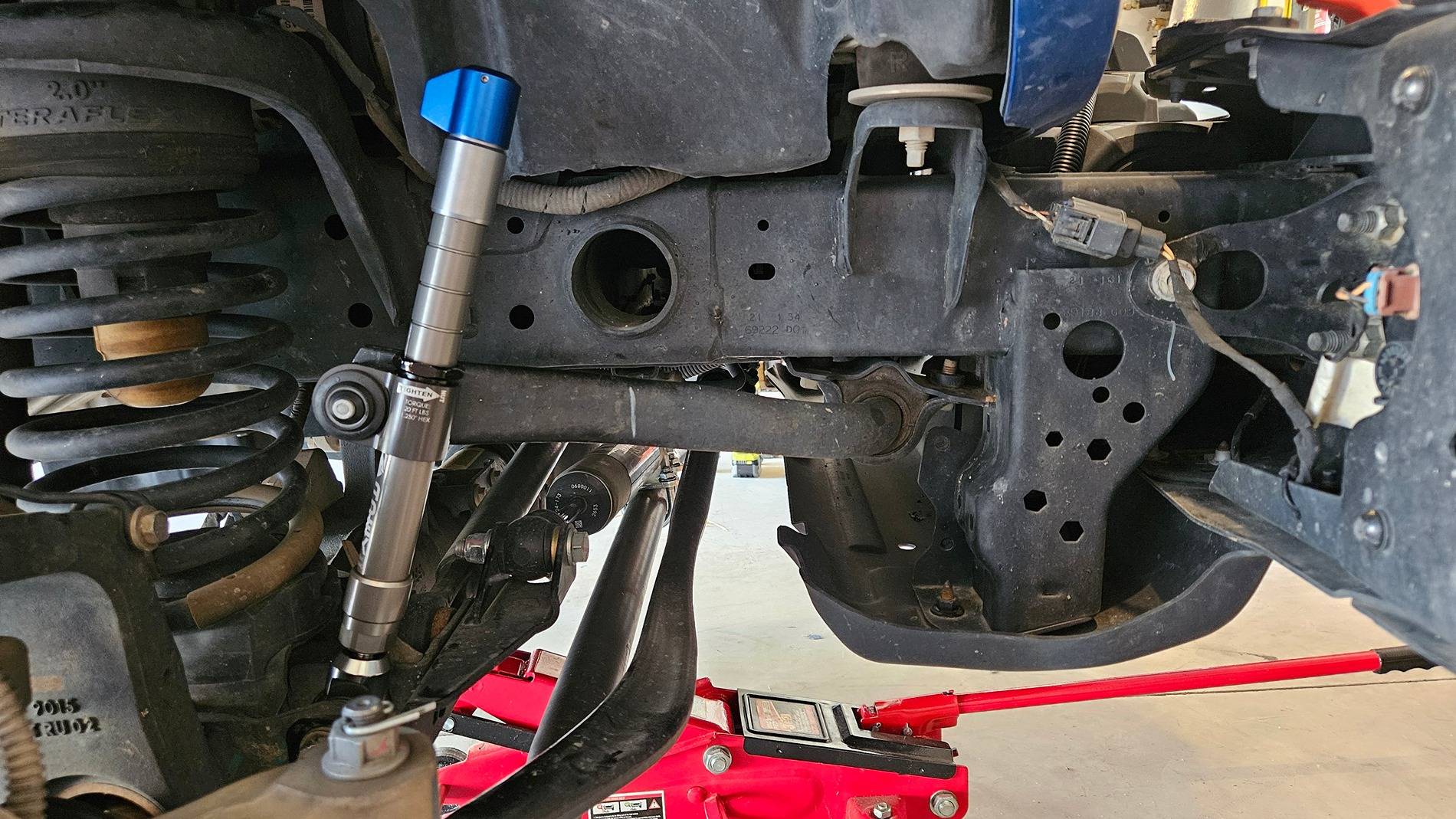

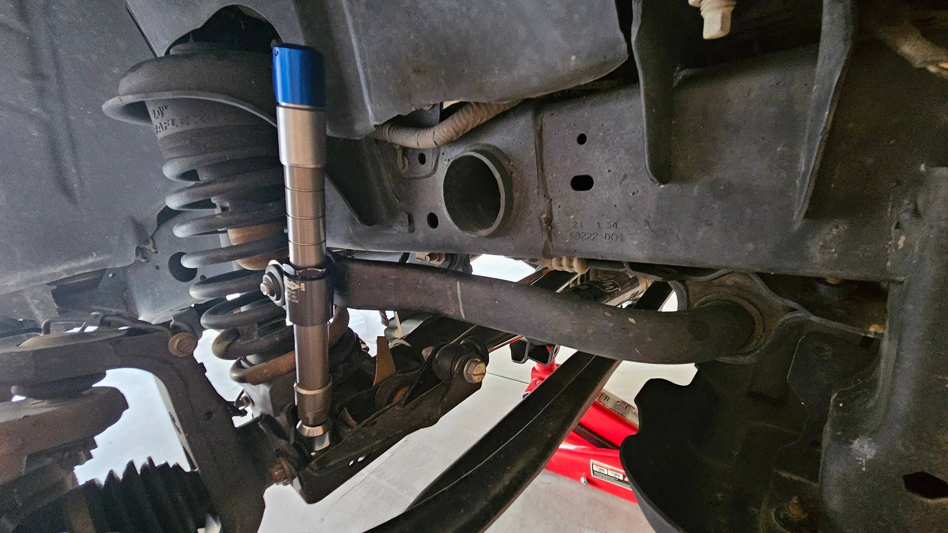

Finally got the bolt loose and had an evening free to get this knocked out.
Local shop quoted me ~3hrs @ $125/hr - yeah right. That's basically what the parts cost me.
Install went smoothly, with a few notes:
  • Even on the lowest setting, these are ~1" longer than my stock links were. This results in the sway bar angled just slightly up instead of perfectly parallel to the ground. Doesn't seem to be an issue thus far.
  • There are little metal rings you have to move. They're not too bad, just really tight and small. I used two small screwdrivers to pop them out.
  • Tightening the top nut is really obnoxious. Its 19mm, and you have to loosen/tighten it with an open wrench (not a socket) because you have to insert a #6 Allen wrench in the end of the bolt to hold it still.
With my fully stock setup, I didn't need to trim the wheel well liner at all - plenty of room.
Disconnecting is as simple as turning the blue knob a half turn. Then to reconnect, just turn it back and bounce on a the bumper till you hear the click.

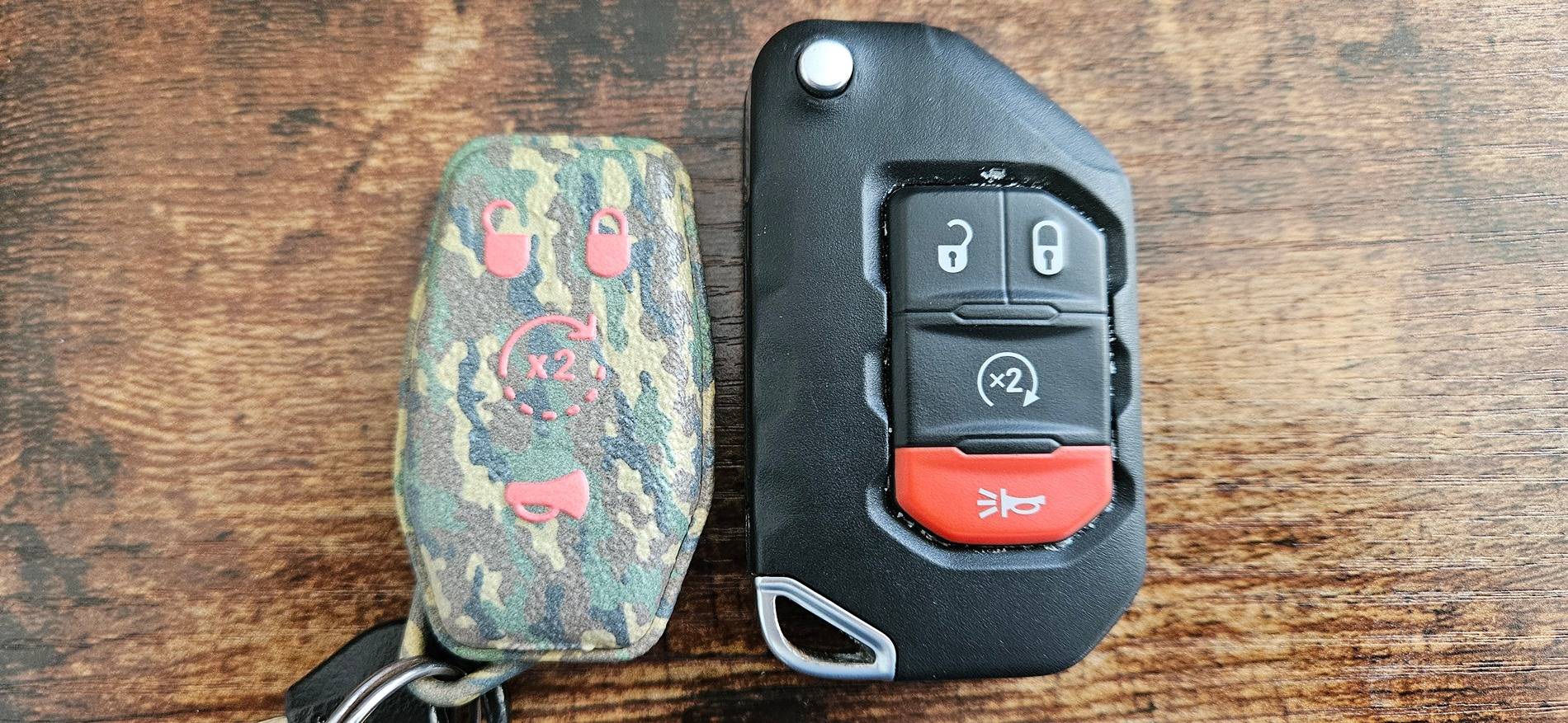

Me being the idiot that I am, I was thinking that finally swapping to a @Threedom fob would work. Don't know why - the circuit board is obviously fried and corrupted. But anyways.
Finally ordered the Model M that I've had my eye on for a while.
Jeep Wrangler JL "Joyride" Hydro JLUSA Build Thread 20241202_090258
Here it is next to the stock fob. It's roughly the same thickness, but much, much smaller.
Jeep Wrangler JL "Joyride" Hydro JLUSA Build Thread 20241202_090313
I went with the "leather" texture - here's a closer look at how that looks:
Jeep Wrangler JL "Joyride" Hydro JLUSA Build Thread 20241202_090345
Overall, I'm mostly happy with it. The lock/unlock buttons are *very* stiff. They work, but you don't really actually feel them work.

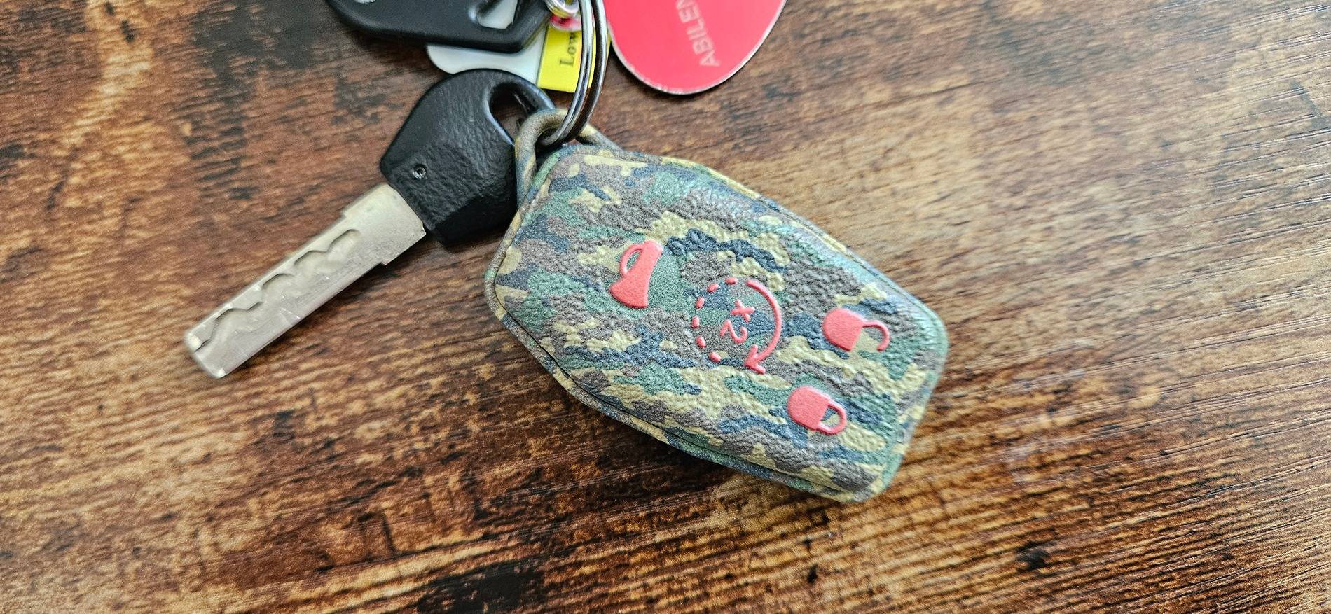

Doing the swap is pretty simple. I did have to fight with the RFID chip quite a bit on both, and actually had trouble getting the stock key to separate from its little holder, but otherwise, it was easy.
Now I still need to replace the salt-corrupted stock FOB, but at least my keyring is a little lighter.
