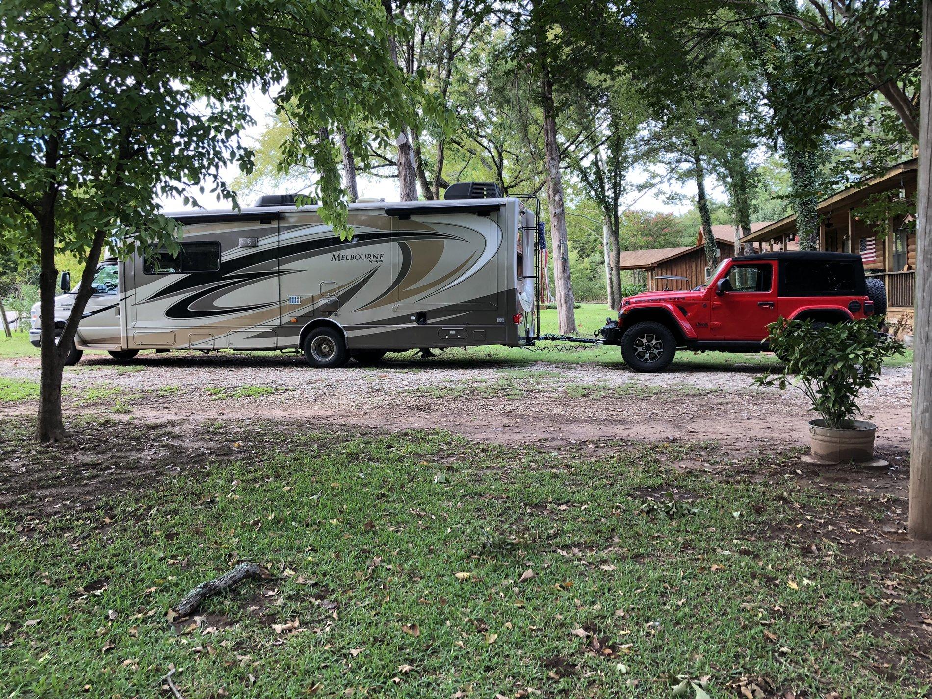

I know one of the things I"m going to monitor on my next long tow is whether the Jeep is in ACC or OFF. I noticed that when I hooked up the jeep for a short (90 miles) tow last weekend home from the motorhome dealer (routine service stuff) the Jeep didn't go into OFF mode and that could have something to do with the transaxle in neutral and transmission in P. I literally had to turn the car back on and then off again and this time it went to OFF. I can't honestly say I'm 100% sure it's always been OFF when towing since the screens stay on a bit either way. I'm going to add this to my checklist to be 100% sure. I won't be towing again til probably February but those are likely to be consecutive 400 mile tow days with the Jeep likely staying connected in a pull through site. I also picked up a highly rated (about $90) lithium jump starter so if the problem does recur, I can simply attach that and perhaps 40 minutes might become 15 minutes and less noticeable. But clearly the auxiliary battery is getting back up to minimal levels during that 40 minute process. I'm also planning to bring it to the installer but he basically says there's not a lot at the charging end going on and that method of seeing if the voltage goes up to mid 13's to low 14's from 12's with the motorhome running and the Jeep off, that should answer the question as to whether the Jeep is getting charged while driving. Hadn't thought to check that myself. I just need to find something to measure that. Given that it never happens when towing isn't involved, I am seriously thinking it's user error and the Jeep isn't really OFF but rather in ACC. Never even noticed that the ring around the push button tells you.
Jimac
Jim
Mar 7, 2018
420
615
Kingston, OK
2018 JL Rubicon
I have flat towed 2018 JLR for thousands of miles with Blue Ox system with no such problems JLR always starts
