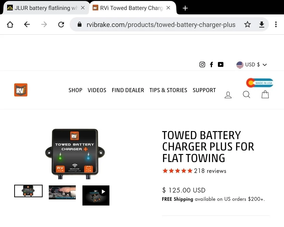

For flat towing the best charging solution would be to get a charge line from the coach. Solar will have issues when cloudy and at night. Many have success with using just a diode for the charge line or you can get a little fancier with a small charge controller. The hardware is pretty inexpensive and even if hooking it up is farmed out it should not be expensive, especially if doing it at the same time as installing the rest of the towing system. I would run a 10 or 12 gauge wire from the tow plug to the battery as part of an install just because it's so much easier to do at that time. Just leave it unhooked as insurance in case you decide you want it later.

I've used this on multiple toads now. Simple installation, safe for the battery, has eliminated any battery drain issues.
