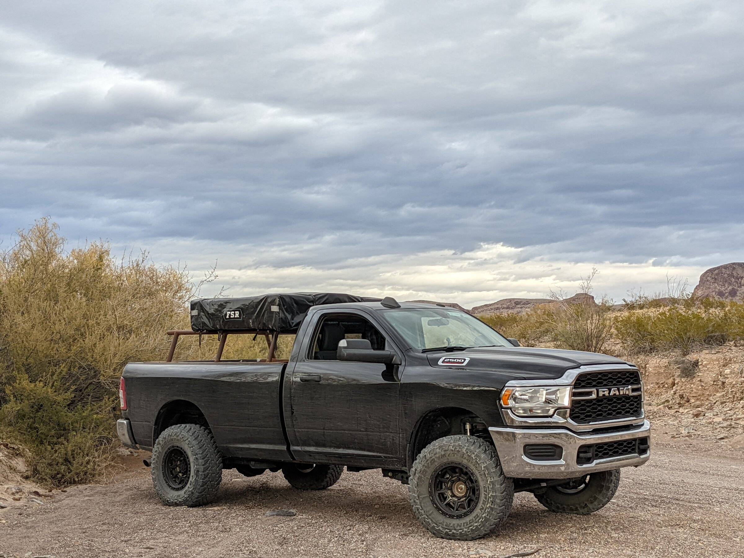

My Gladiator was a 2020 – sold it right after a 5,000-mile road trip pulling a small built camping trailer – it was approximately 2,000 lbs. – the reason I sold my 3.6 gas gladiator with MAX Tow and the 4.10’s was because I figured if I was going to get v8 fuel economy I might as well have the v8 – so I switched from a 3.6 v6 to a 6.4/ 392 Hemi in a single cab 4x4 Ram 2500.
This trip took place between Thanksgiving and Christmas 2020. Temperatures ranged from well below zero to above 80 degrees - The mpg on the Gladiator was 12-average on a road trip that took me from Dallas, TX to Los Angeles via Santa Fe, Moab, to Flag Staff, ultimately to Los Angeles. On the Return trip I went From L.A. to Cour de Lane Idaho, via Las Vegas. From Cour de Lane, I hit the outer realm of Yellow Stone, to Deadwood S.D., then back to Salt Lake City, down through Grand Junction Colorado, back through the mountains of New Mexico onto Dallas, Texas. It wasn’t the altitude or the torque that got me out of the JT. It was MPG…
I.M.O. The single cab 2500 chassis and engine combination with the 8-lug axles is what the Gladiator should have been; it should have shared very little with the JL wrangler. It should have been a RAM H.D. with the 6.4 – I’ve run that experiment… My opinion is, little more than my opinion – Jeep F.C.A. did what they did I am sure to appease many masters. But nevertheless, I’ve run the experiment.
For reference the RAM H.D. with 6.4 Hemi on the same size tires got 17 mpg and did great off road on trails I feel the Gladiator was suitable for in the same tire configuration.
Gears matter – I was running 285/75/17 on stock wheels with a leveling kit on my 2020 Gladiator, with the 4.10’s. I would have enjoyed 4.56’s but wouldn’t pay for that miniscule of a change. 5.13’s and the 8-speed with legit 35’s or 37’s would have been the cat’s ass. Not sure what that would have done to the unloaded MPG….
Later the Ram was running a Thuren kit which equated to approximately 4” of lift in the front and 1.5” in the rear. It looked funny on 285’s and later cleared 37s without issue.
The 2500 Ram H.D. was $5,000 less than the Gladiator – with a Hemi and 1-ton axles – (4x4) – its wheelbase is 1.5” longer than the gladiator. I’ve repeated the trip on two occasions with the Ram – and the MPG was slightly better than the Gladiator even with larger tires.
I put 37’s on the 6.4 hemi and the MPG went from 17 with the 285/75/17 to 10 - mpg with the 37’s so I pulled them and replaced them with 35/12.5/17 Toyo Open Country’s. Mpg is 13 on the 35’s. Weight was the only explanation I can find.
The HEMI needs gears, but no-one is yet making gears for the New Body Style H.D. Ram Axles -
