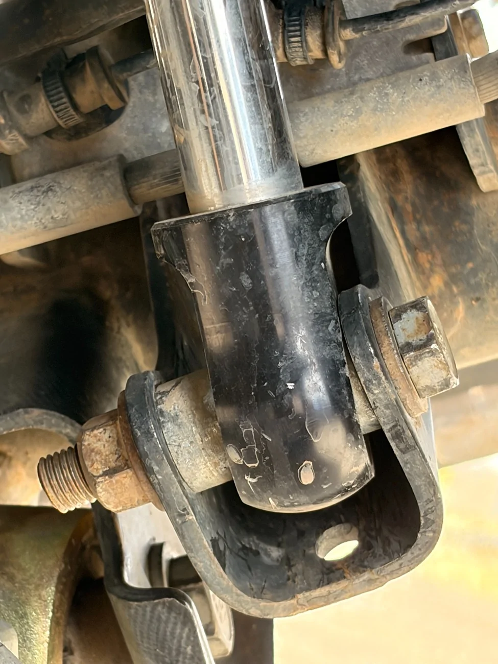

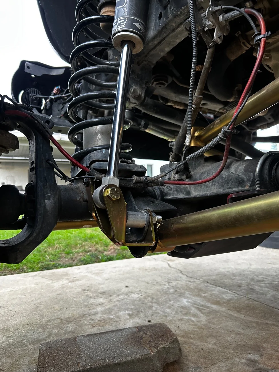

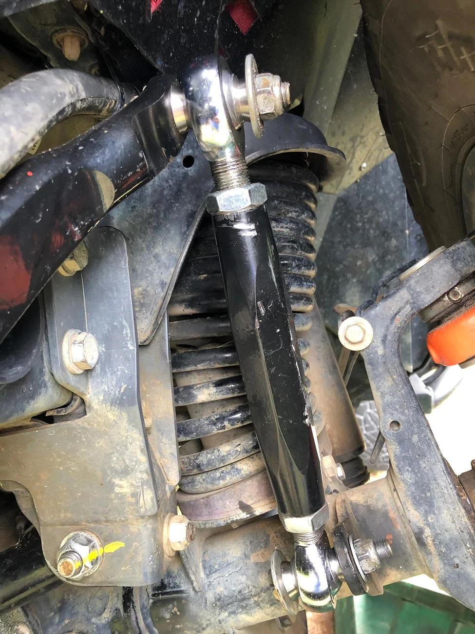

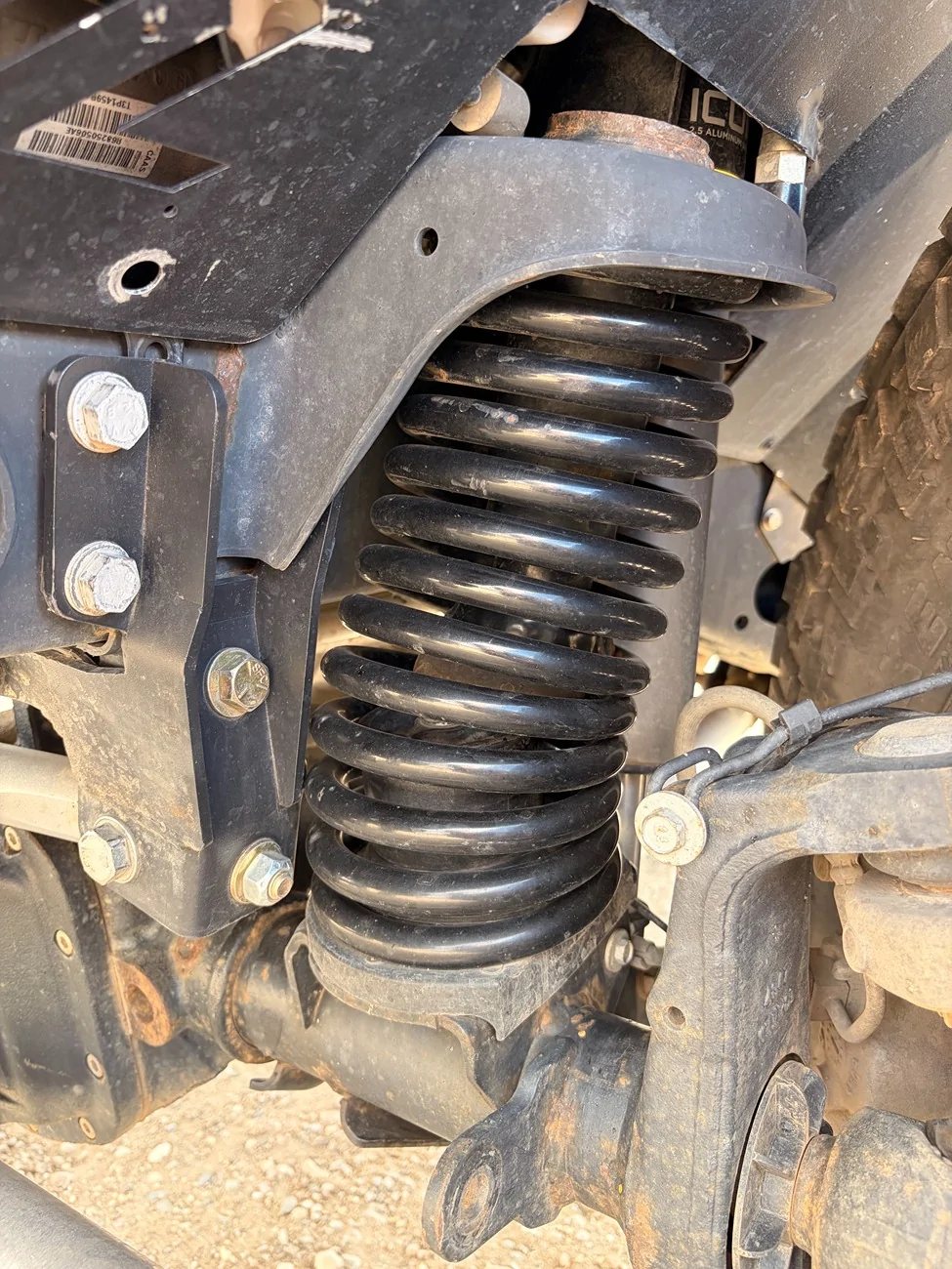

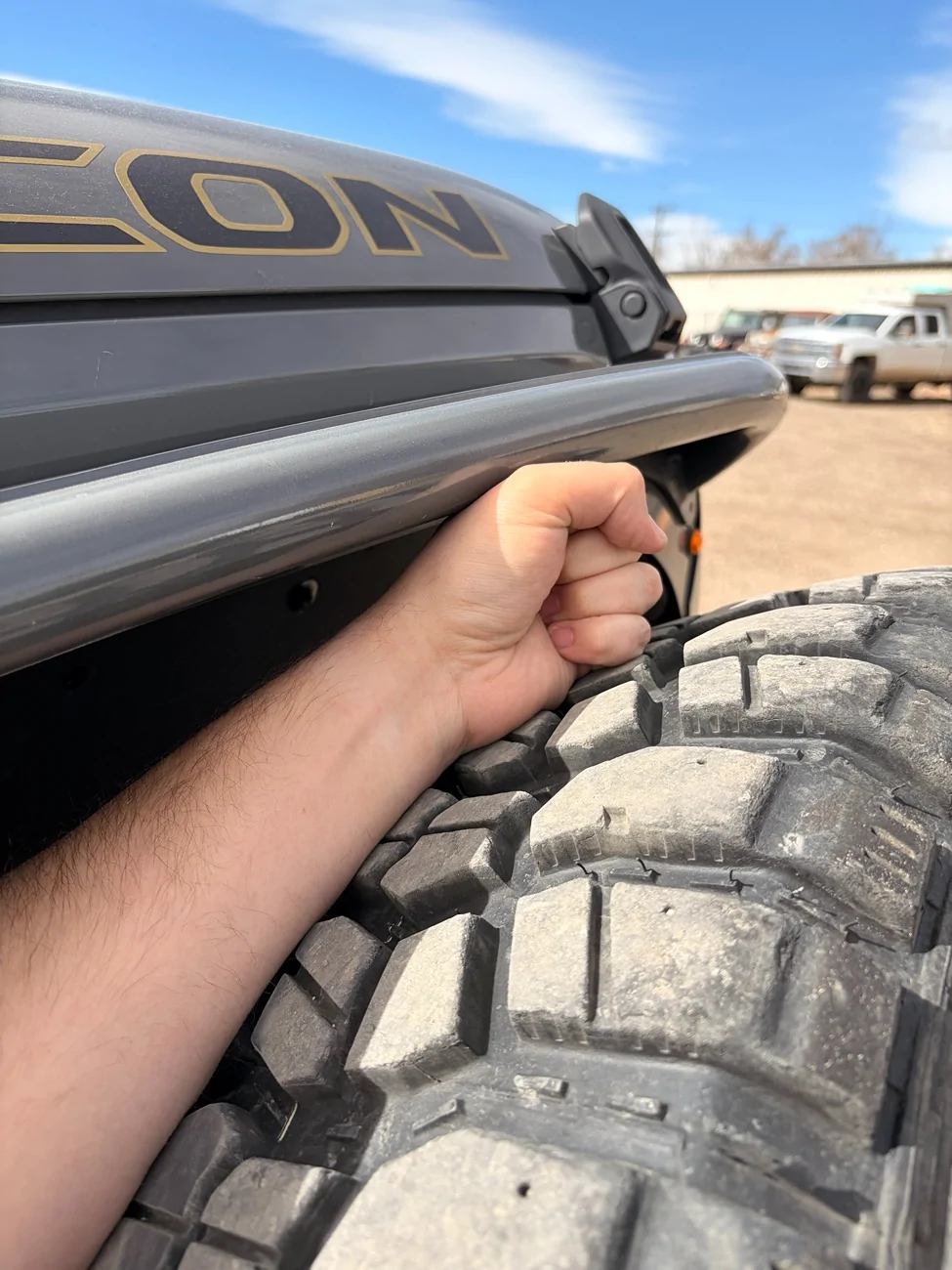

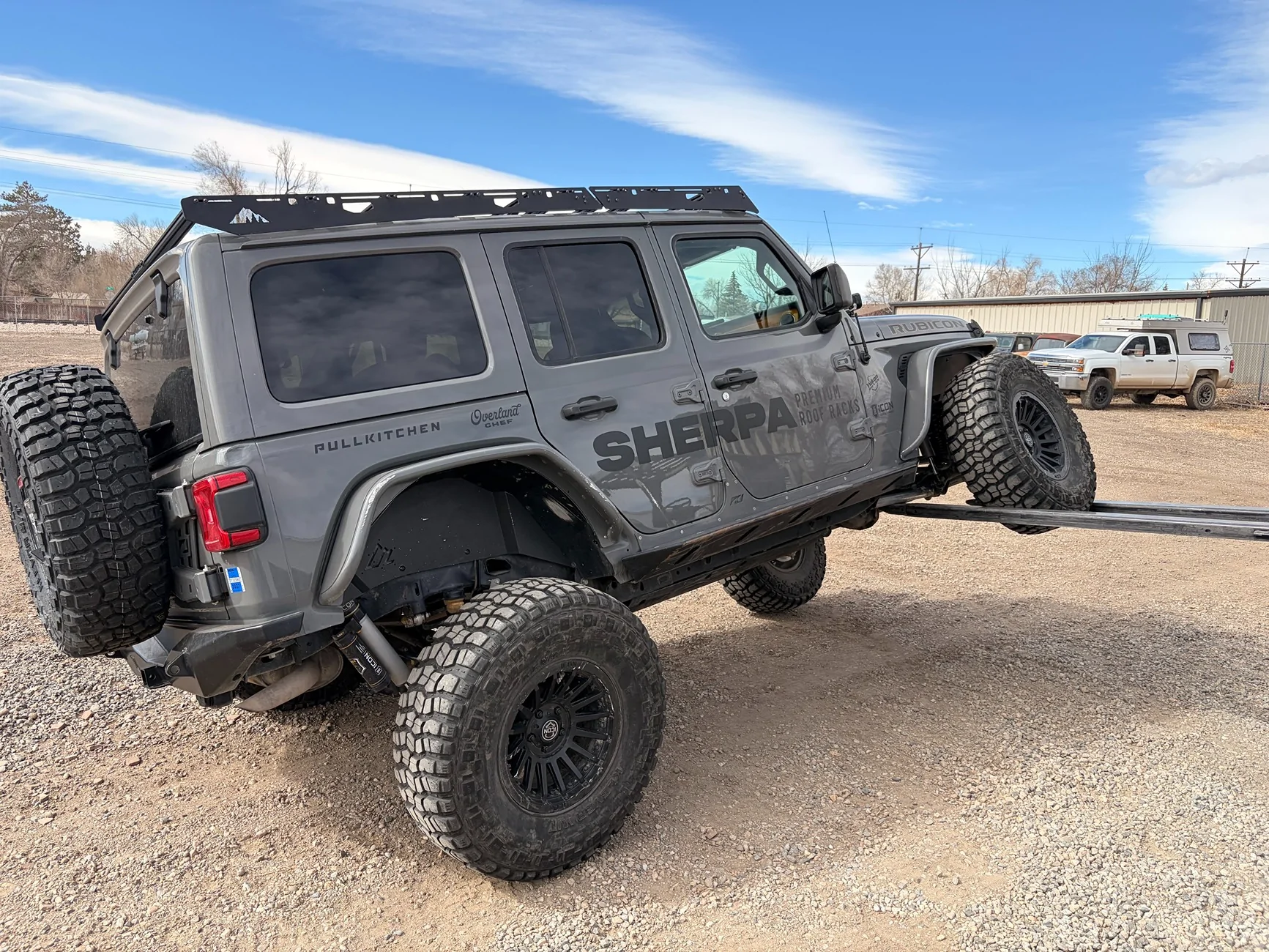

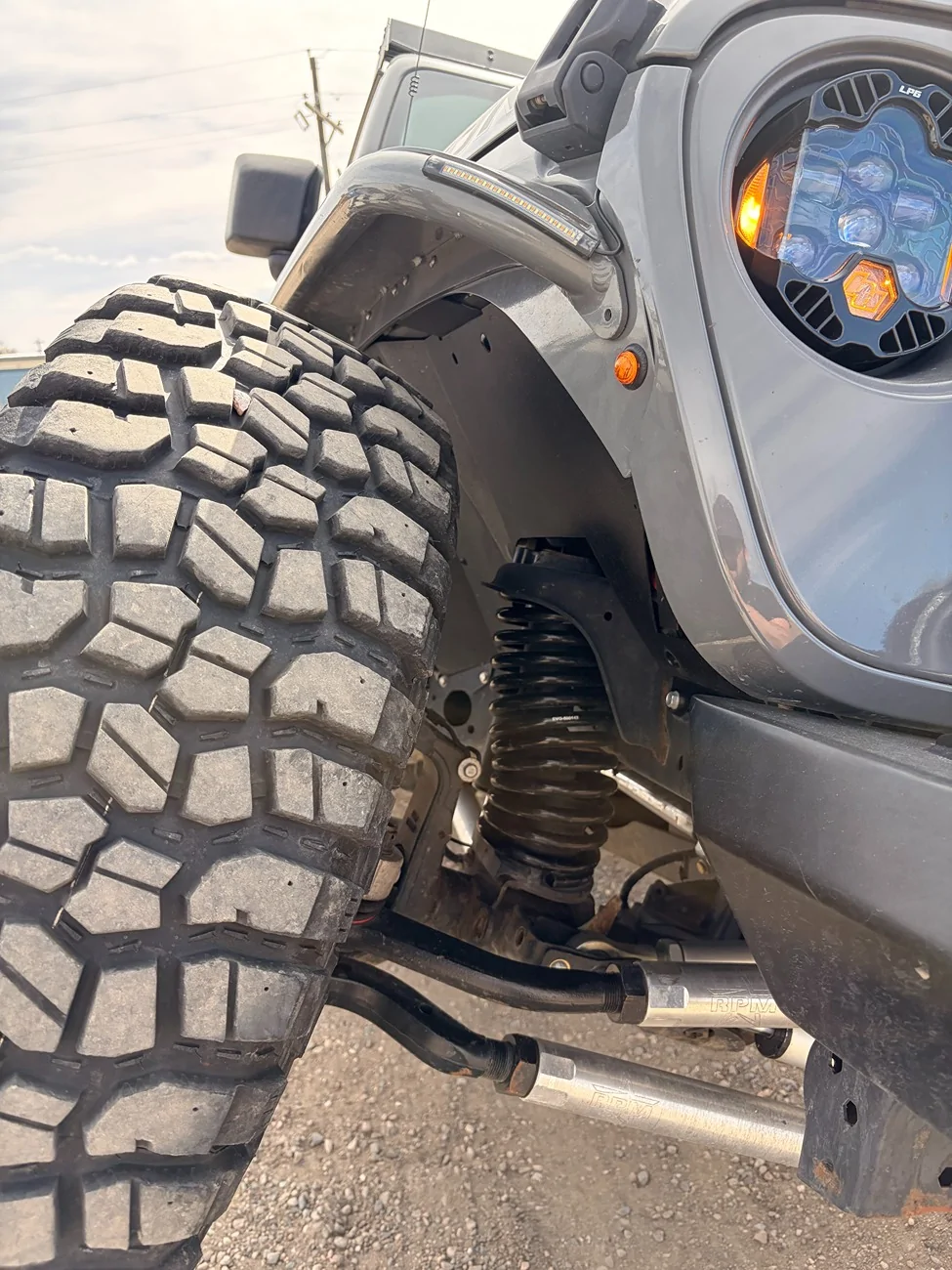

After doing so many projects on the Jeep, the one thing I haven’t done is just flex it out with the forklift to see how it's all “working”. I haven’t had any issues with it out on the trails but I hadn’t checked for rubbing, stretched lines, or general clearances. I could see that I wasn’t using the full travel on my shocks so I had a feeling I needed to lose some bumpstop spacer.
Another issue I am having is spring bow. I am not sure if this needs to be tended to or if it is just normal.
After getting the truck on the forklift, I found a few things.
  1. I do infact need to remove roughly 3 inches of bump stop in the front. I was shocked there was still so much room with the Genright fenders.
  2. There is a little bit of binding happening in the bottom misalignments on the shocks up front.
  3. The coil bowing seems to be pretty dang bad at full compression. I cannot imagine this is good. Maybe someone here will have some advice.
  4. I need to add a smidge of bump in the rear to keep the tires off the fenders. I am a little concerned with clearances when I go to 40’s with these fenders.
That spring bow is normal……this is mine at full stuff……

for the shock mounts check out metal cloaks outward bound shock relocation brackets. they recommended them with the long arm kit.
This is awesome. I will have to get a set of these. Did a good bit of reading on them and really like what they were after with this one.

Love the build, Icon is legit…..
Just wanted to throw this out there….. Those MC brackets raise the shock bottom about 1.5” so it gonna decrease up travel and increase droop…. Depending on where your shock is sitting at ride height it may or may not make a difference to you….. I am running long travel shocks on a 3.5 inch lift so I didn’t want to sacrifice the 1.5” of up travel…..I opted for the MC relo brackets that don’t change the shock bottom elevation…..again, this is just a heads up in case you weren’t aware….. ✌

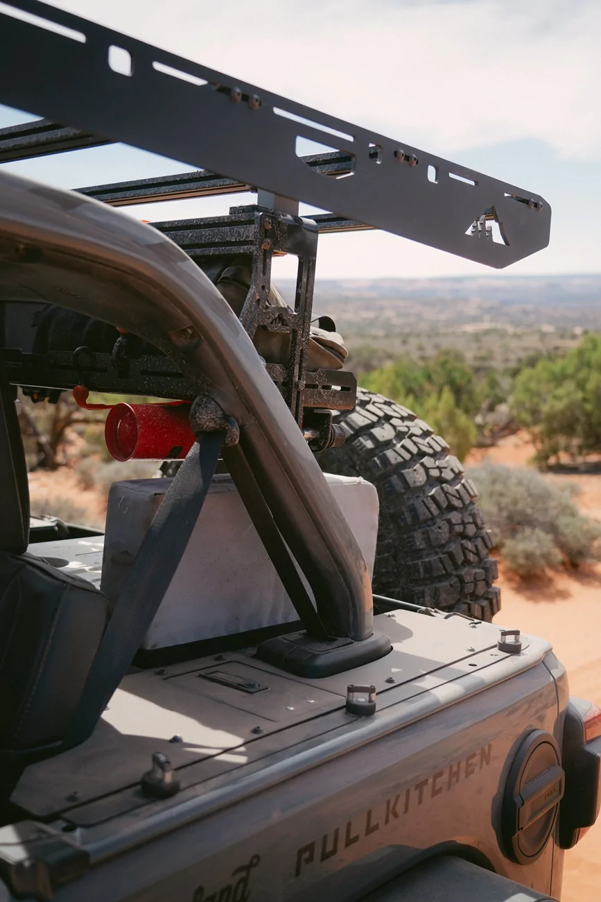

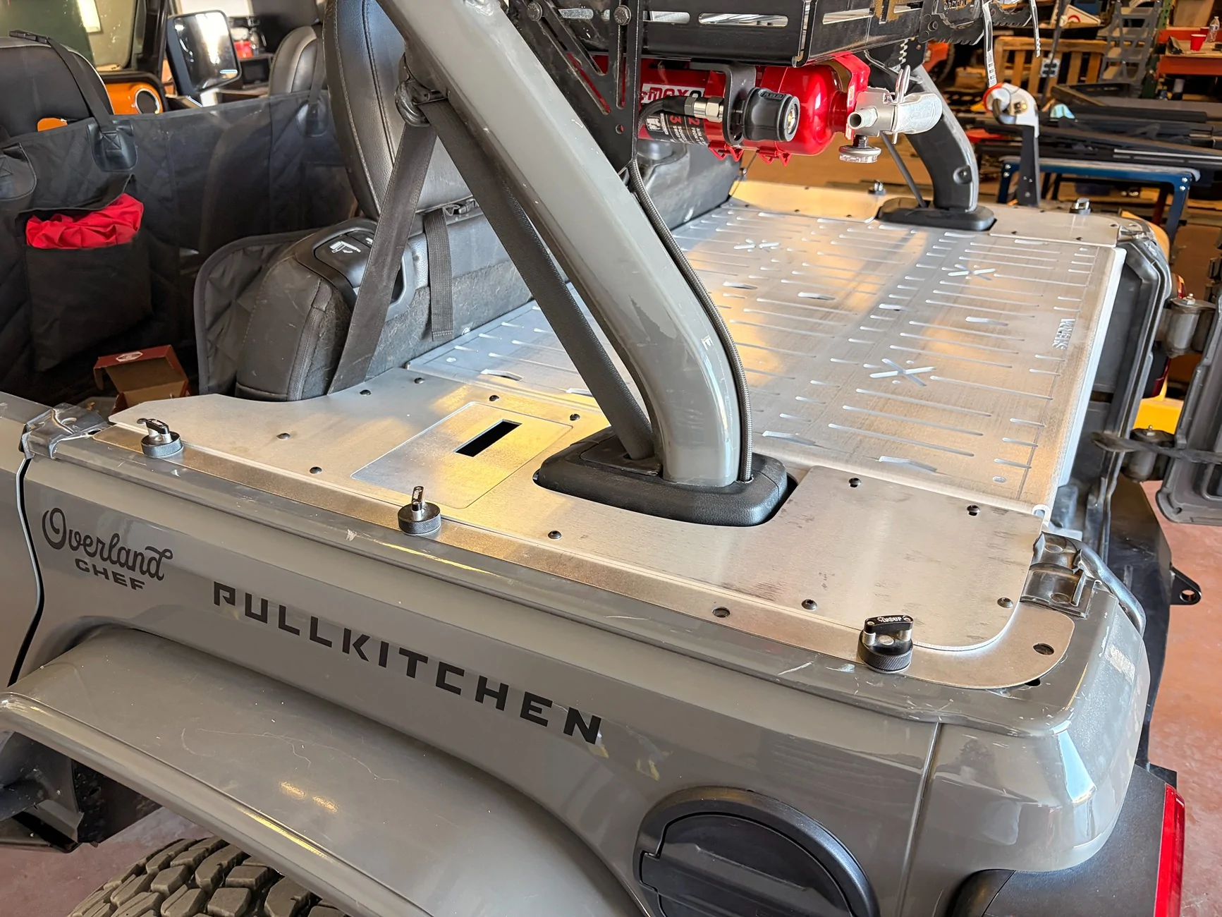

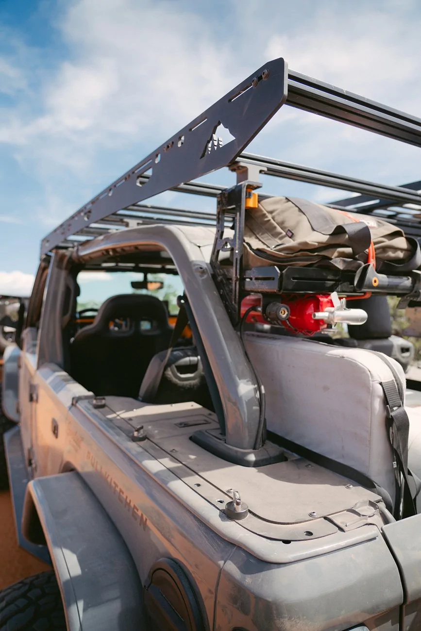

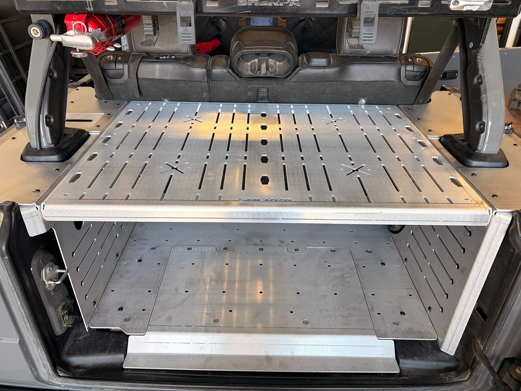

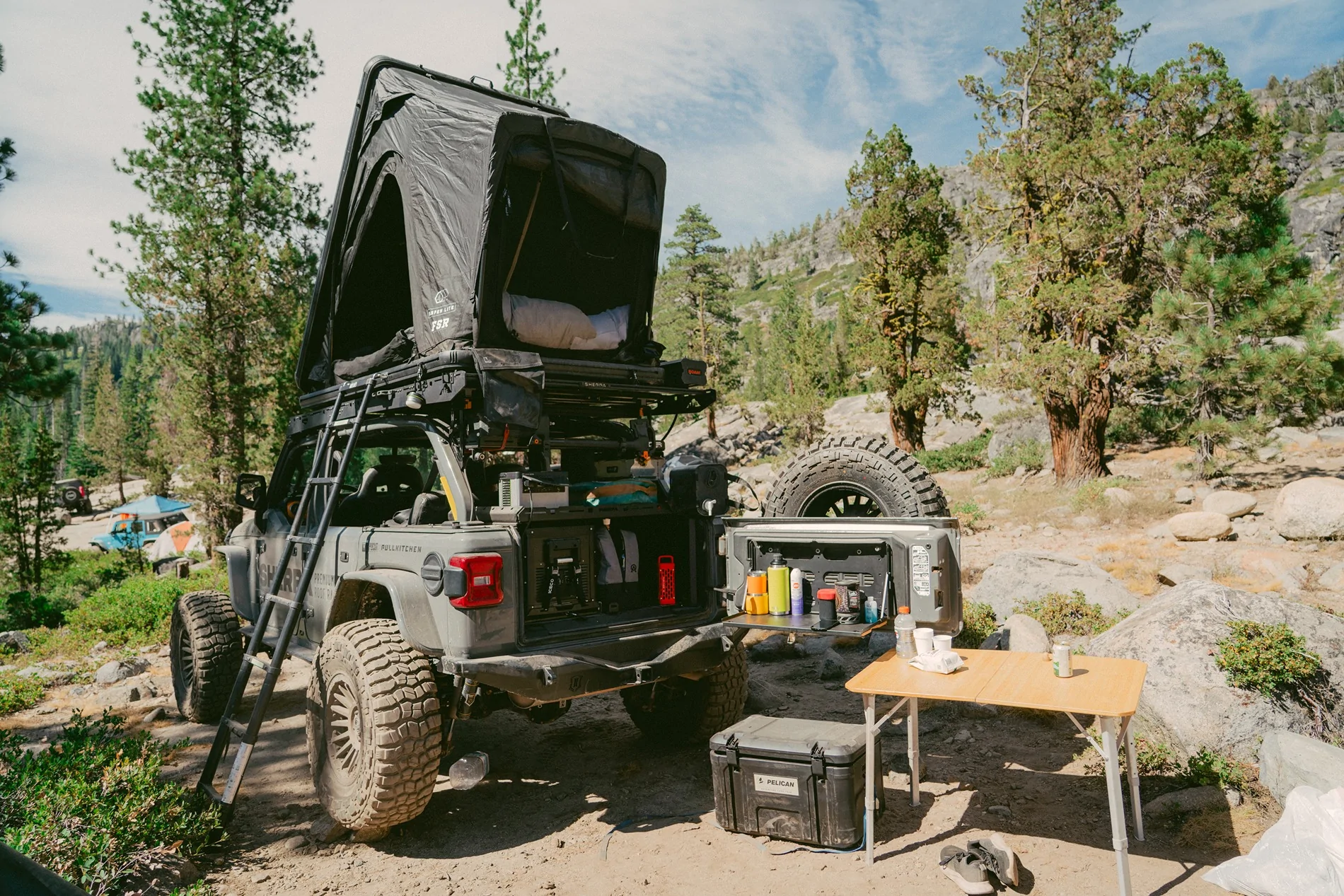

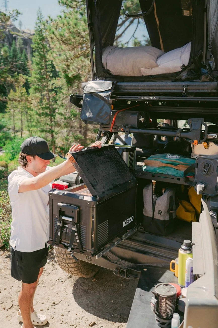

Wanted to officially share some updates here of a rear cargo system I have been working on. This is my first real CAD project and it's been to tinker with. Still needs a few adjustments after real world testing out at EJS.
This isn't a perfectly weather-tight compartment, but I wanted to swap that for "features". This is technically 3 separate "modules." A baseplate, enclosed sides, and then a load deck shelf that can come in and out quickly with knobs. It works with or without the top and the focus is giving customers a more functional space to work with for storage. The driver side has a cubby for packing in things like coats, recovery gear, or whatever you might need.
