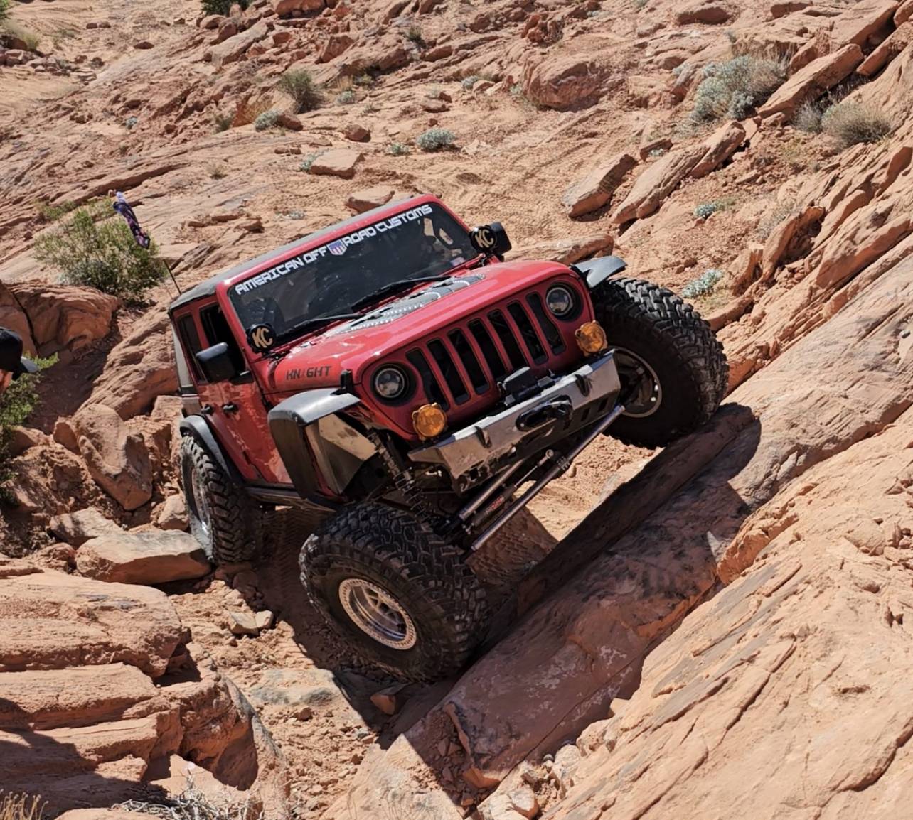

Hey everyone! This is Knight my 2018 JLU Sport I’ve had for about a year and a half. Follow my build on Instagram @knight_jlu

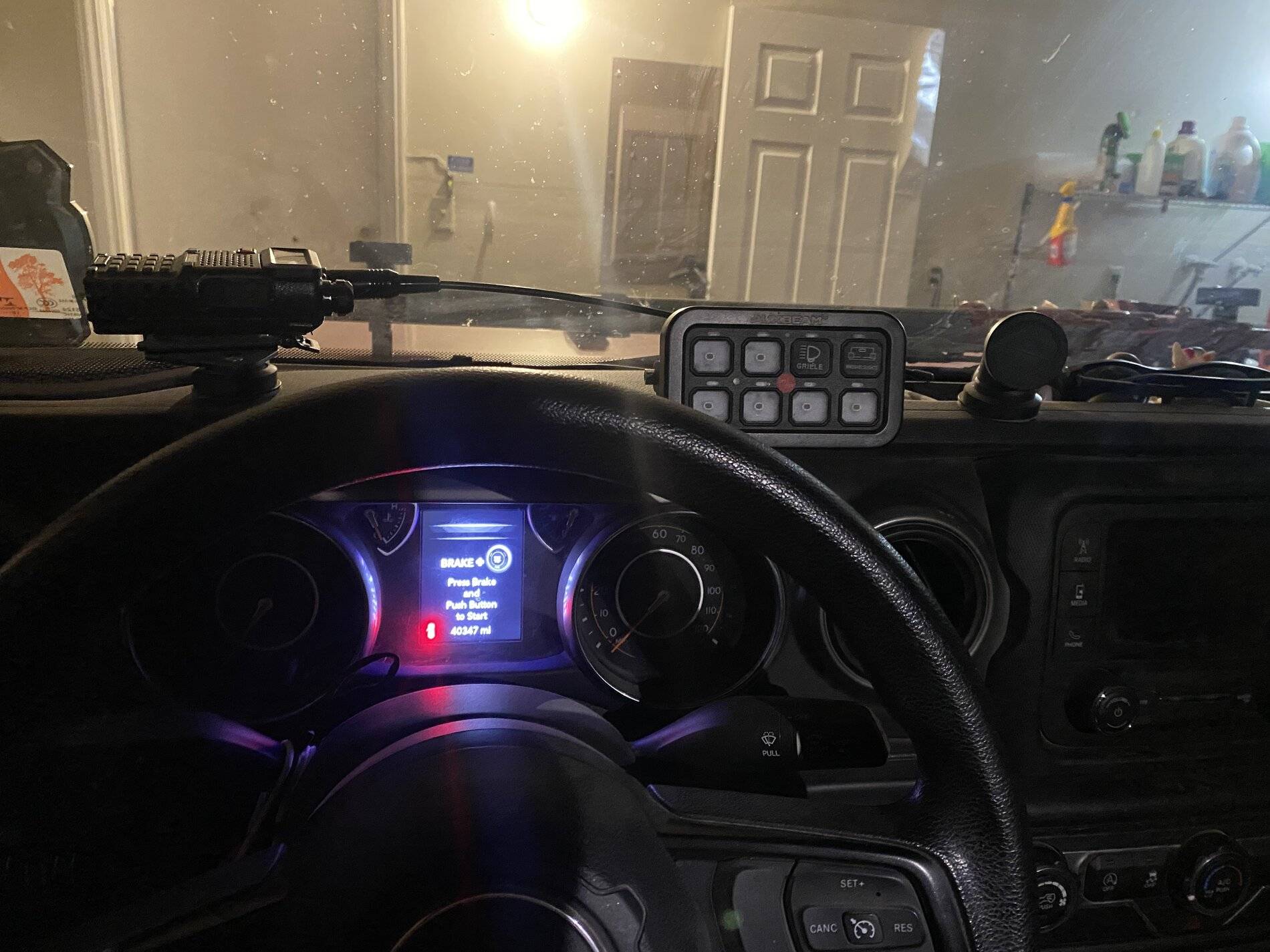

quite a build list! Curious on where you mounted your sunbeam control panel, if you have any pictures

I mounted the switch panel on the dash just above the instrument panel off the the right a bit.

Obviously it’s been a while since I’ve updated this. The rig has gone through many changes, some have came and went since then.
Jeep is now on coilover suspension from radflo, welded on metalcloak long arms and Rubicon axle swapped. Coilover towers are RPM. It’s sitting on KMC beadlocks and 40” Nitto Trail Grapplers. Has RPM aluminum steering and PSC hydro assist.
As far as armor goes I have motobilt corner armor, rocker guards and I did DIY RuffStuff sliders. I had Motobilts fender flares too but had to scrap them to tuck my 40s. If I missed anything I’ll have to update later.
