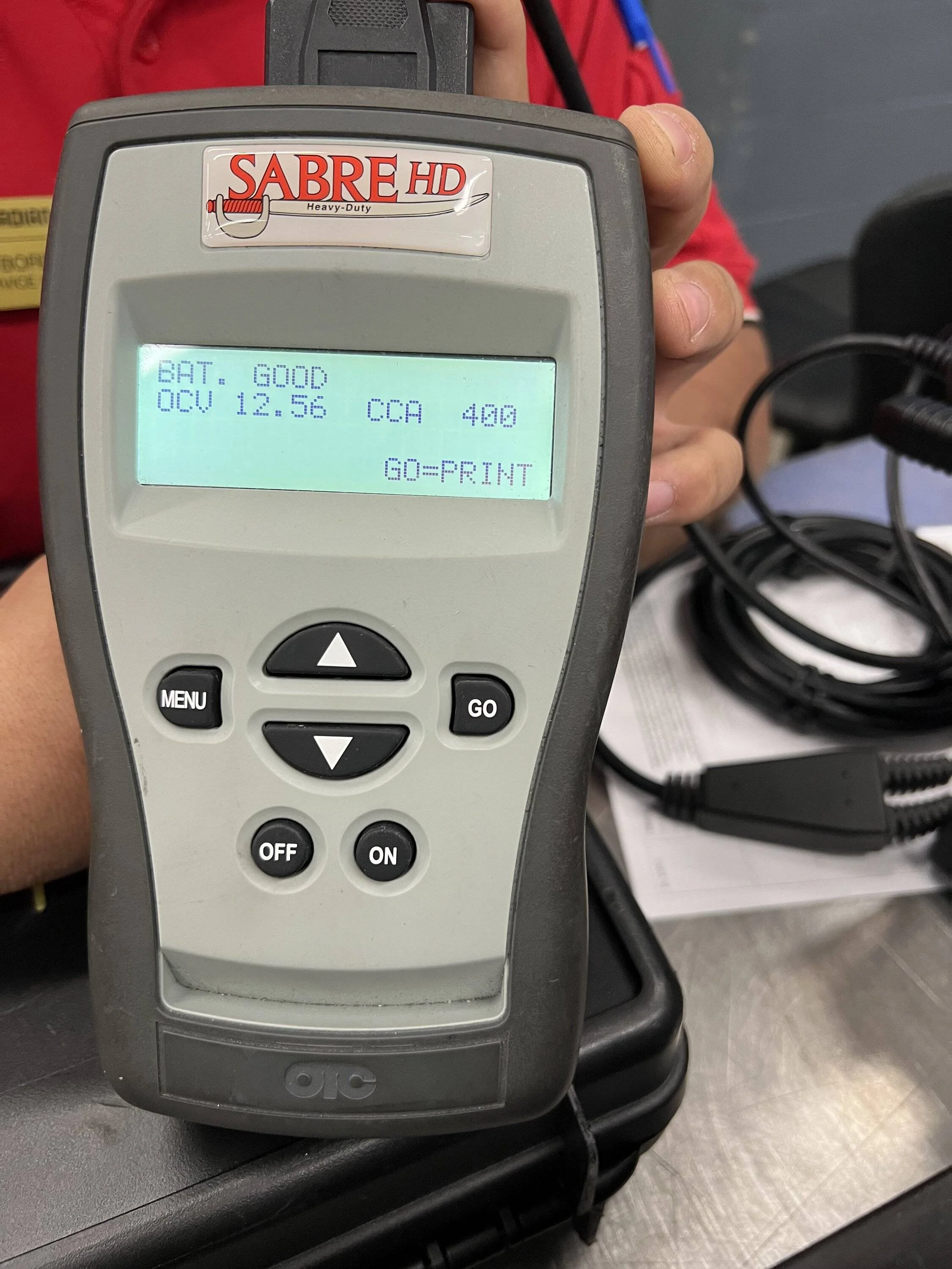

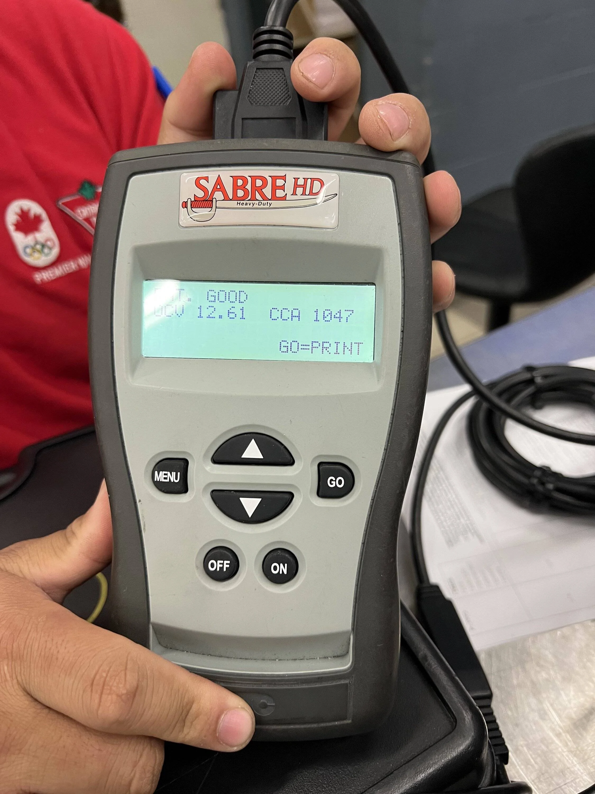

I just did a load test on both the main battery and the AUX battery. They said the batteries are in good health.
Jeep Wrangler JL JLR 2.0 engine will not start IMG_3792
Jeep Wrangler JL JLR 2.0 engine will not start IMG_3793
