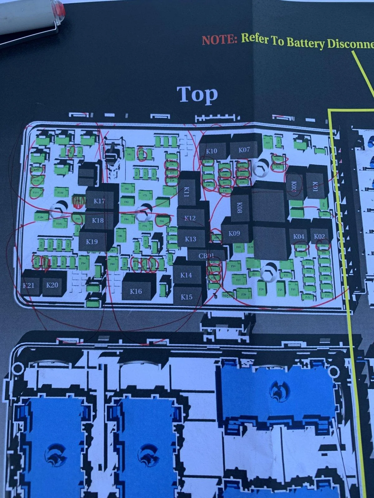

Photo Below. I used a buddies Jeep as a baseline. With the ACC turned on but not the engine.
then tested mine and photo shows results. (Ignore big red circles). Small red circles baseline showed juice flowing. But on mine it did not.
now to trace where those fuses go into the can bus and see-if any wires are faulty.
