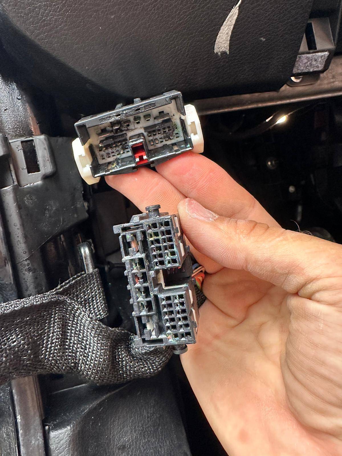

We have removed all mud and salty water from the carpet, but we have found some connectors which are damaged.
The most damaged connector is the one that connects the door and the vehicle (see image below).
Jeep Wrangler JL Electronic issues after flooding. PHOTO-2023-06-14-17-23-08
This connector is specified in the wiring diagram, found in this forum :) as:
Jeep Wrangler JL Electronic issues after flooding. IMG_0845
I cleaned this connector with WD40 for contacts, and the electric step started responding sometimes to door opening & close, but other issues are still showing.

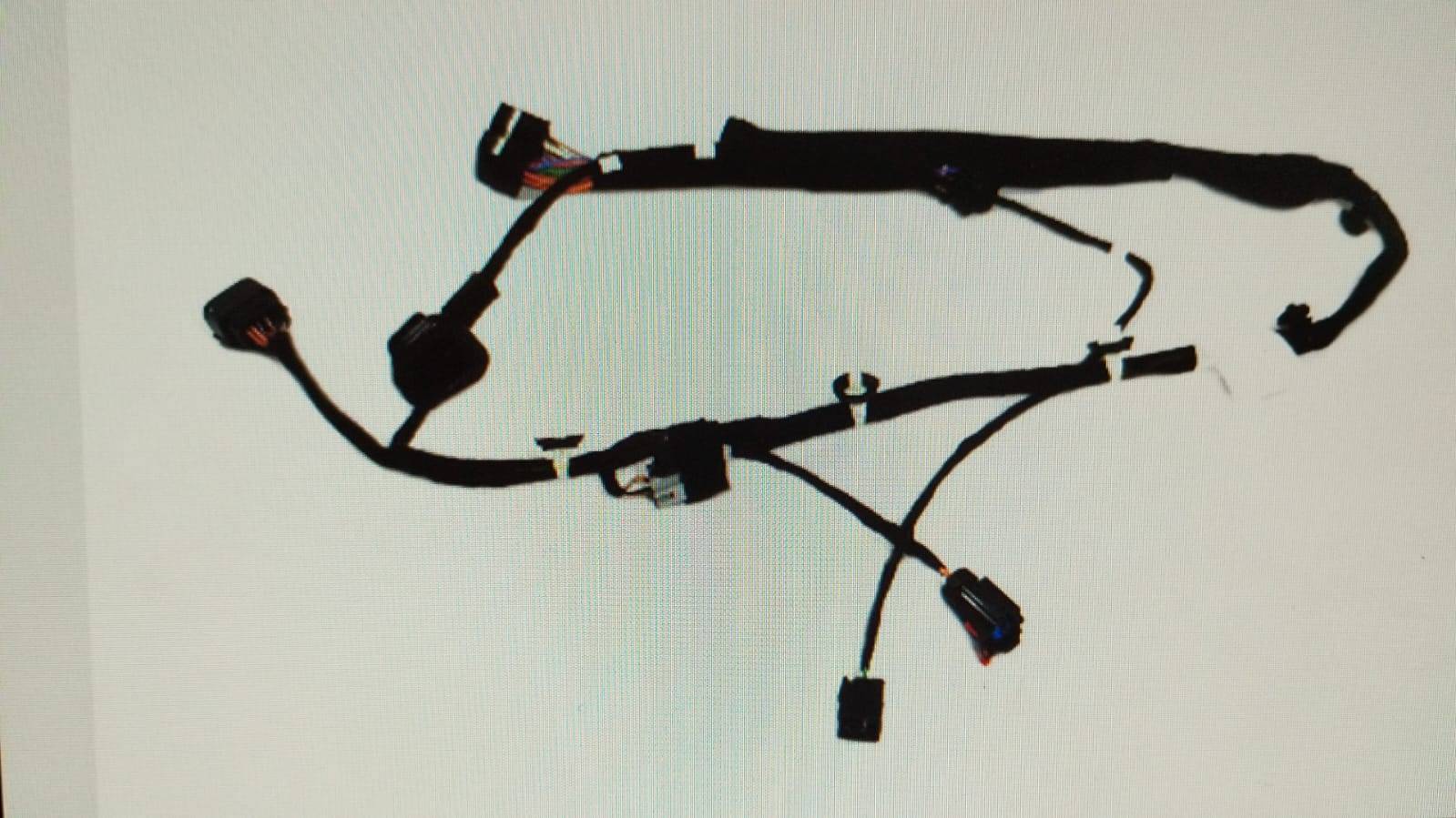

I guessed is better to replace the connectors, but I only found the cables set corresponding to the door (product example image attached).
It costs around 100€, not bad.
Jeep Wrangler JL Electronic issues after flooding. PHOTO-2023-06-15-11-10-13
BUT I can't find the reference of the cables set that goes from this connector in to the car.
Does anyone have a wiring diagram to identify it? (PINK in the diagram attaced above)
