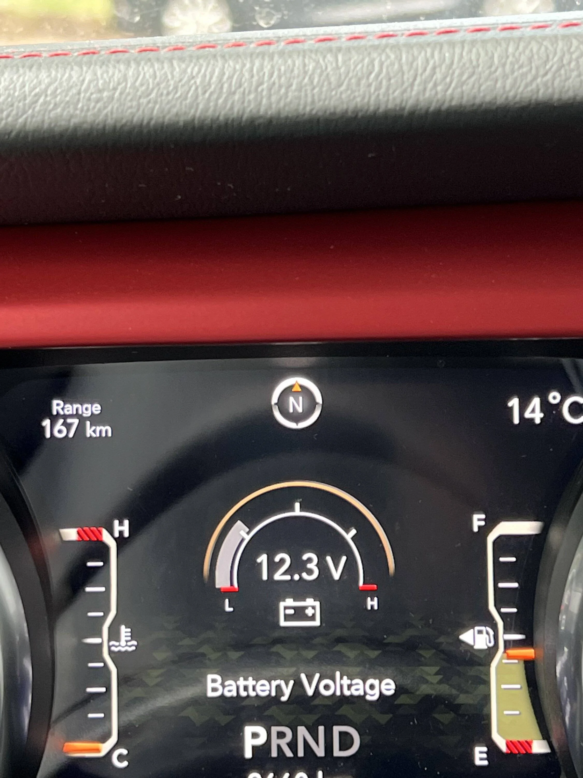

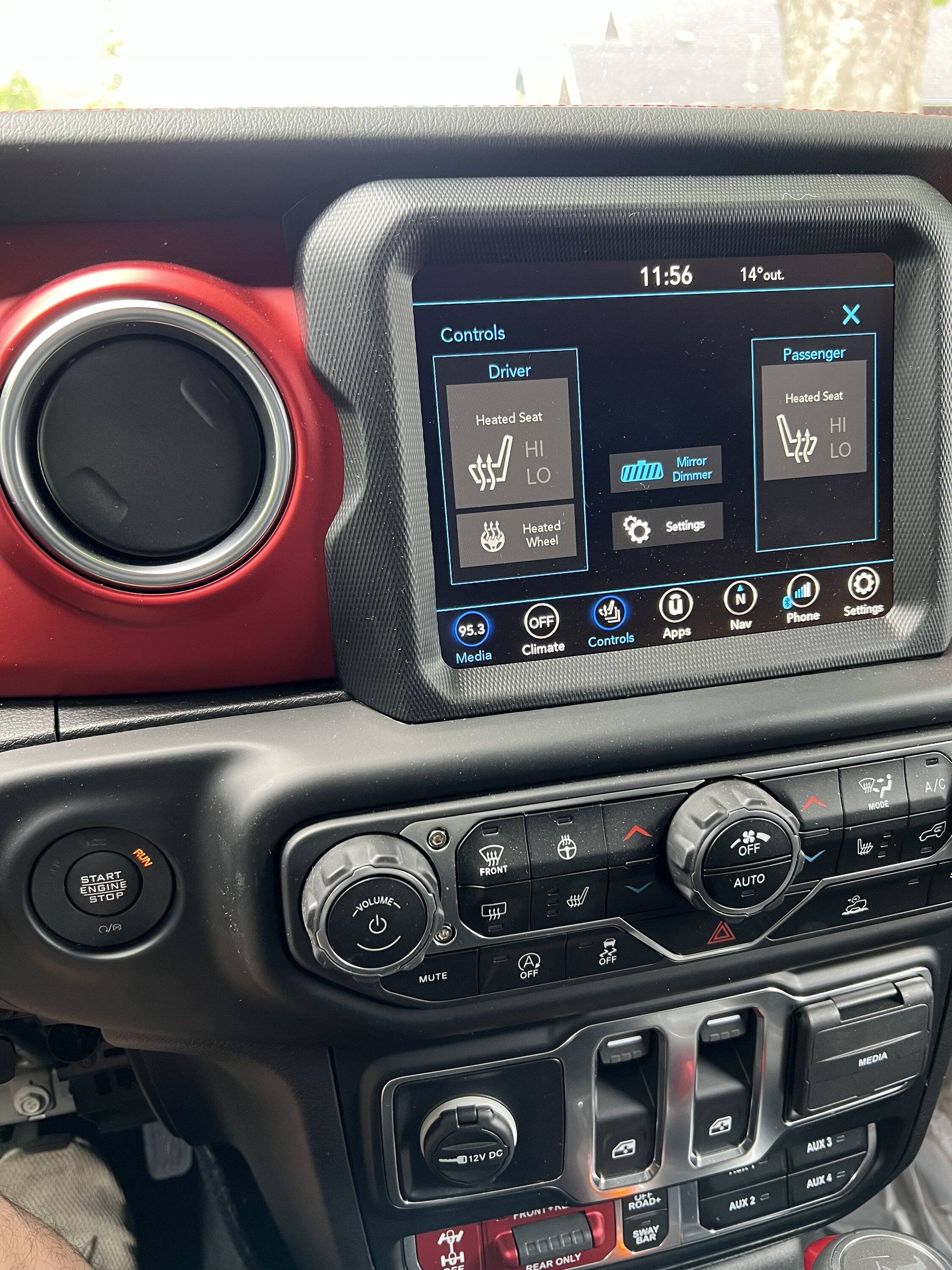

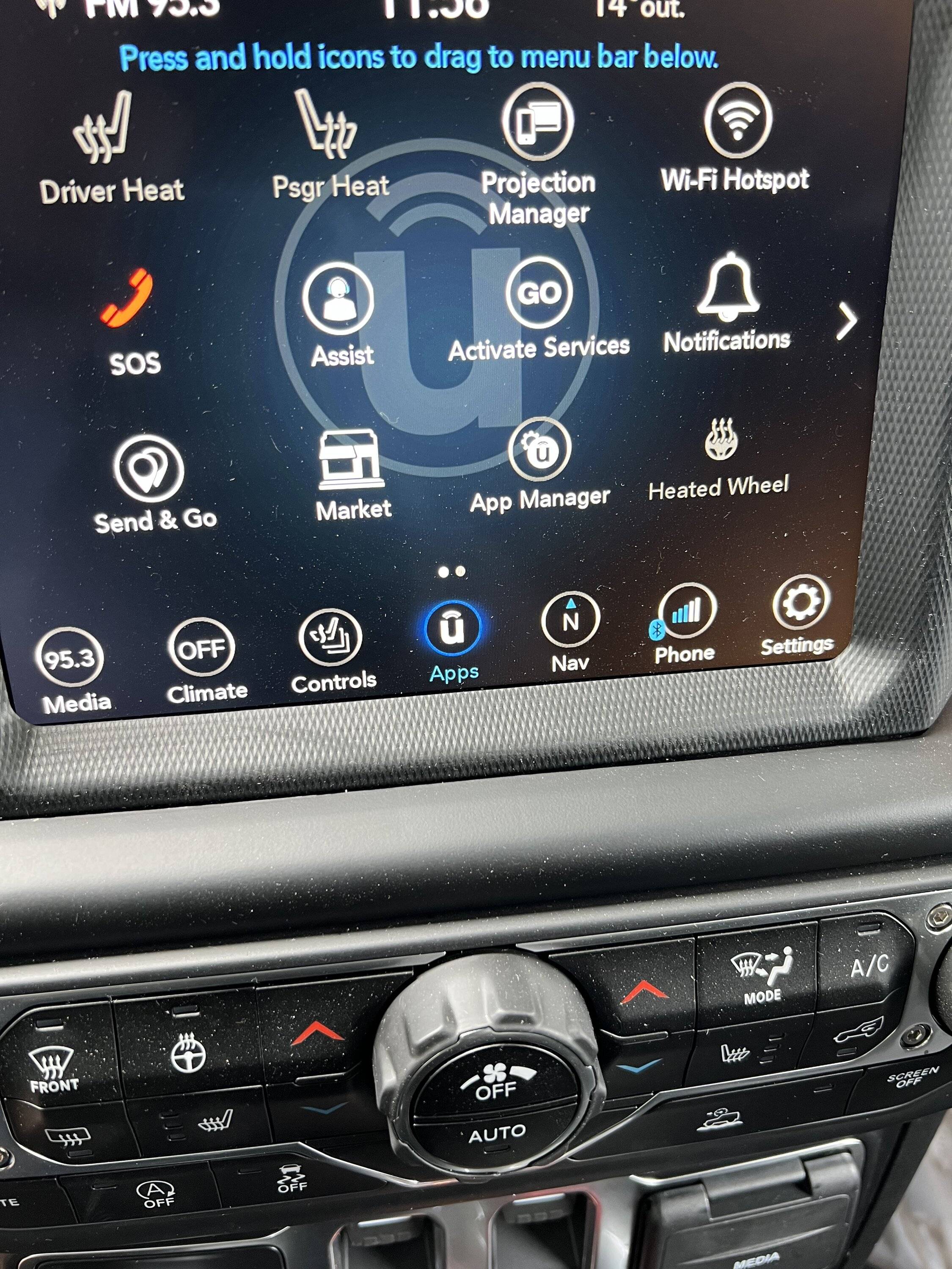

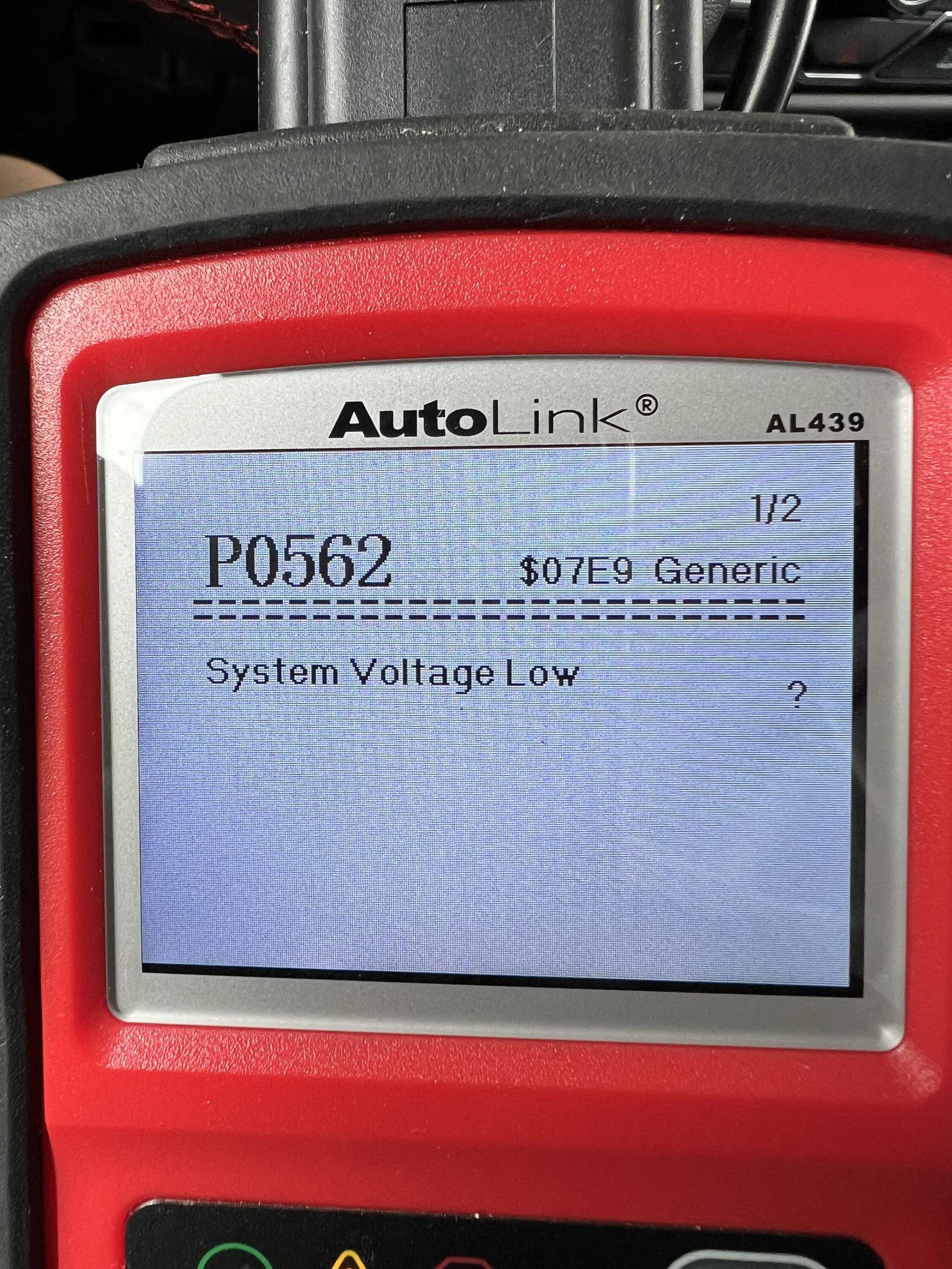

Result: I did everything mentioned above and still the engine does not start. I hear an electrical whirling for a second or two when I tried to start it, but no crank. There is an engine light that appears on the dash, so I put my Autel in the OBD and it says I have a engine code P0562: System Voltage Low. My jeep reads that the battery voltage is 12.3 V. My heated seats and heated steering wheel option on the screen is greyed out.

Vehicle batteries that are near the end of their practical service life (no matter their age) can show a proper resting voltage -- e.g., the 12.3V that you observed -- and then fall off a cliff when an engine cranking demand occurs. They can also cause seemingly unrelated issues, such as the dashboard warning lights illuminating concurrently. N.B.: 12.3V is the absolute floor for resting voltage.
