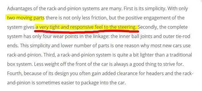

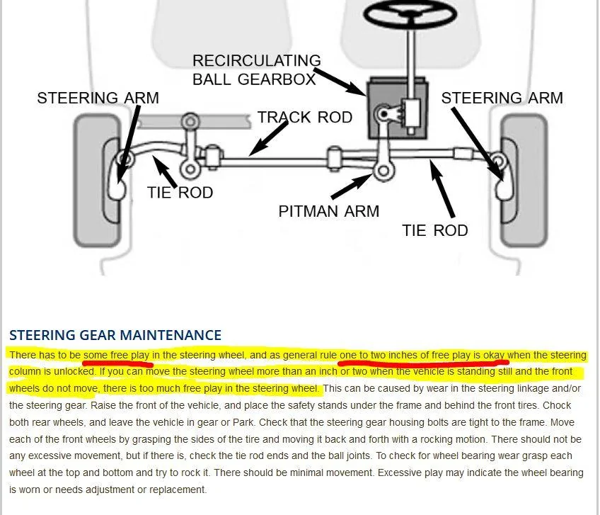

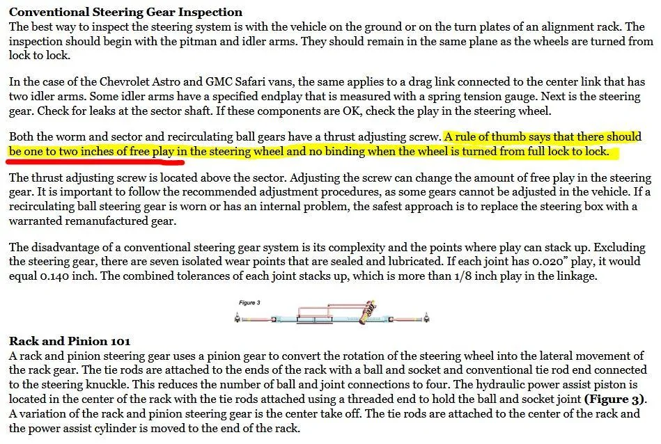

This is absolutely normal for recirculating ball steering systems to have about 1-2" of play in the steering wheel, no amount of part replacement is going to change that, many clueless consumers fail to understand this, what you were used to was a rack and pinion steering which is much less complex and have way fewer parts and thus less slack between them.

Ouch! Had no ill intentions other than to link some scientific article on recirculating ball steering systems merely showing that 1-2” of slack is quite normal(if you have more by all means get it fixed), guess you can’t have too much of a good thing going eh? You are confusing death wobble with steering wheel play. Also, steering wheel slack has nothing to do with not tracking straight, that’s an alignment issue. By the way.. I had no mentions of JL vs JK, or even attempted to compare them, but sure, if you want to go there, I belong to a club and have friends who drive JKs they all suffer from some degree of steering wheel play. JKs use hydraulic assist while JLs are electronic so JLs steering will feel lighter and less “connected”. I guess it’s also just that many JK or older Jeep owners didn’t come from soccer mom or weekend dad demographics so they may less susceptible to the steering bullshit.
