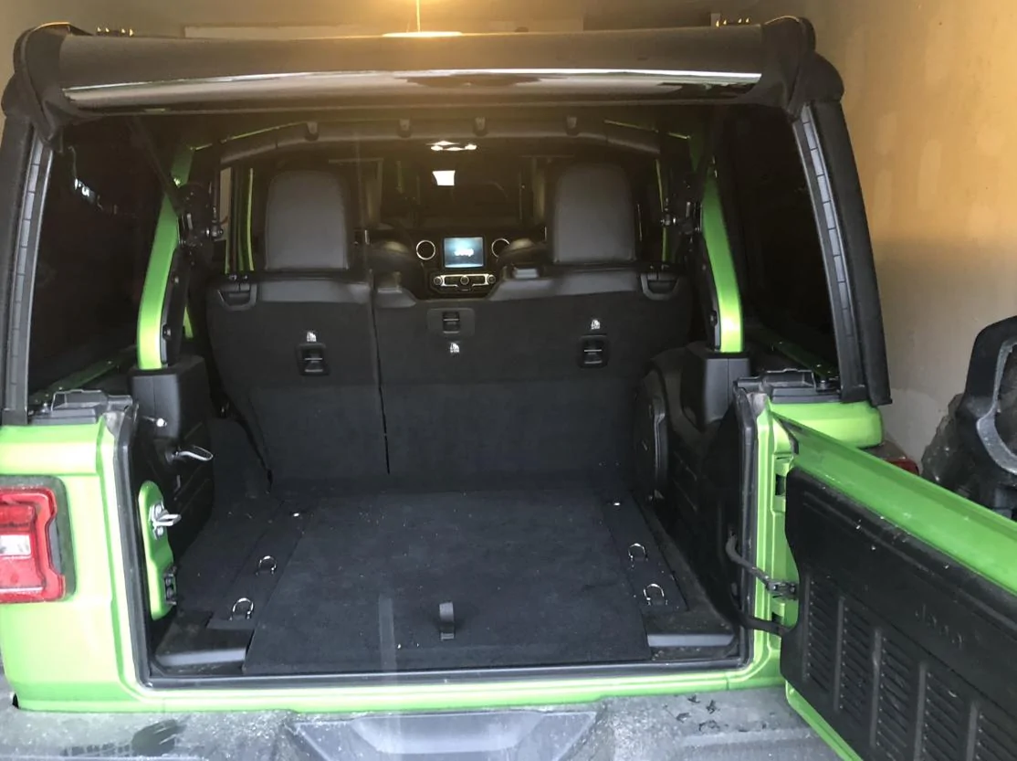

I have had my Soft top installed for about 2 weeks. Went on fine and I have had it up and down about a dozen times. Yesterday when I went to put it up the leading edge of the soft top by the windshield seemed a bit further away from the windshield than normal. Went back and checked that everything was where it should be, then dropped the top and put it back up carefully. Still a bigger gap than before but I figured it was just tight since it had been down for a couple of days.
I was able to get the latch in the groove and gently pulled the latch to tighten it and the metal SNAPPED just past the two bolts that secure it to the windshield.
I was able to get the other side latched (it was going to rain) then I had to drive it to work this morning on the highway and had to hold the top down with my hand as it flopped up and down.
I got a service appointment at the dealership tomorrow and we will see what they say.
The one thing that has changed is that previous to this weekend, the top never really locked in place when it was down. I had to strap it down. In looking at videos here I saw how it should stow and pushed it harder down. It didn't really click I felt the top slide into something and it was then securely tight in the down position. Now I am wondering if that screwed something up in the top which caused this issue. I am hoping there is something wrong with the top that they can identify and fix, because I am not feeling confident about the tops longevity at this point.

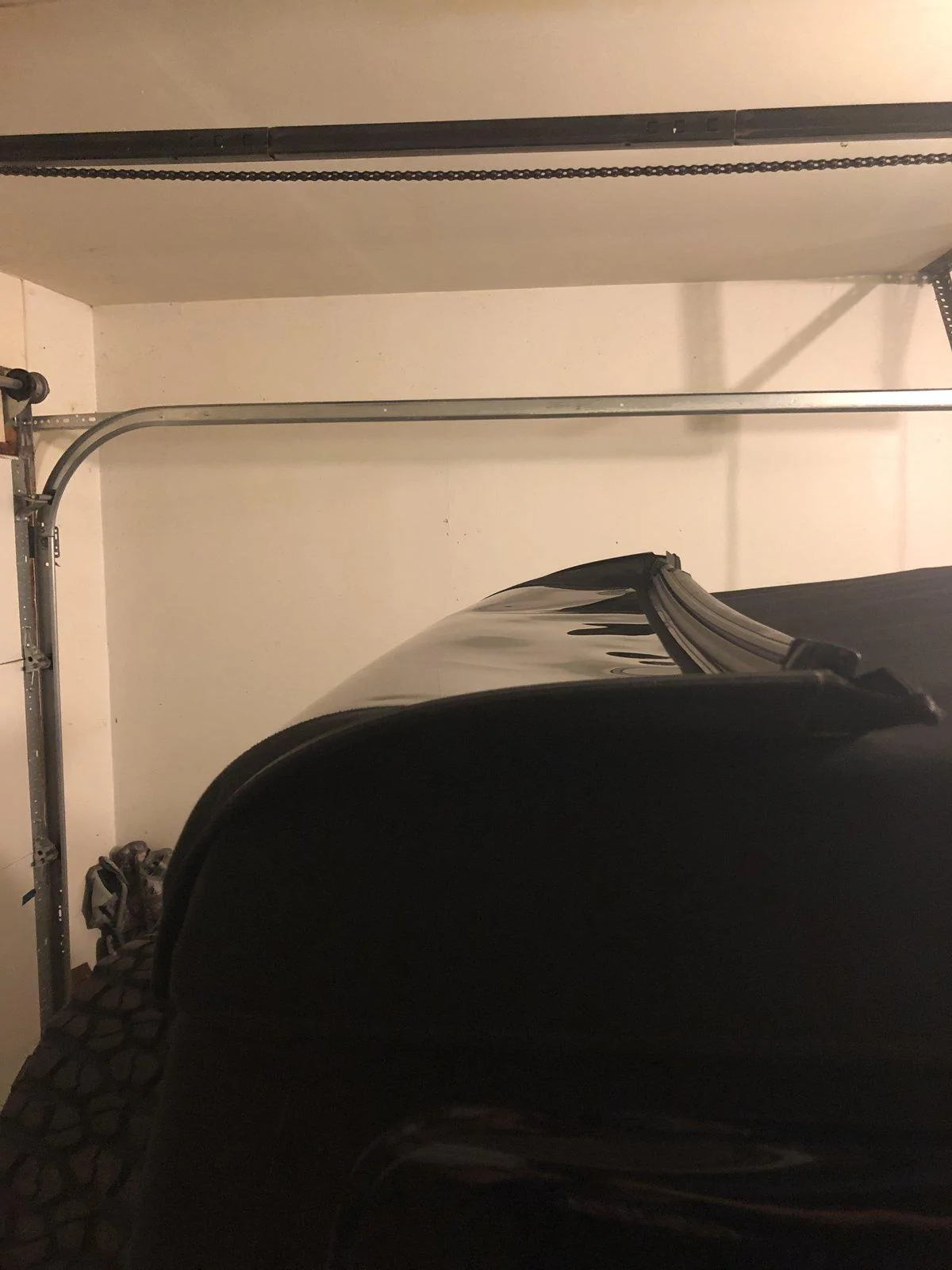

So I'm at the dealership and I ask about the drooping rear part of the softtop. They tell me that is normal, that they do that after they are used. (It has been on the Jeep for 3 weeks.) He also tells me that there is not much adjustment they can do on the softtop. It is what it is, Is that accurate?
Unfortunately, I believe everything they told you. Normal vs acceptable is the debate, however. In all the JKs I had I never experienced drooping. I think it's just the growing pains of this new soft top design. maybe by MY 2025 they'll finally get it all sorted out and looking good. I don't think there is much, if any adjustments to be made. So yeah, I believe that it is what it is.
