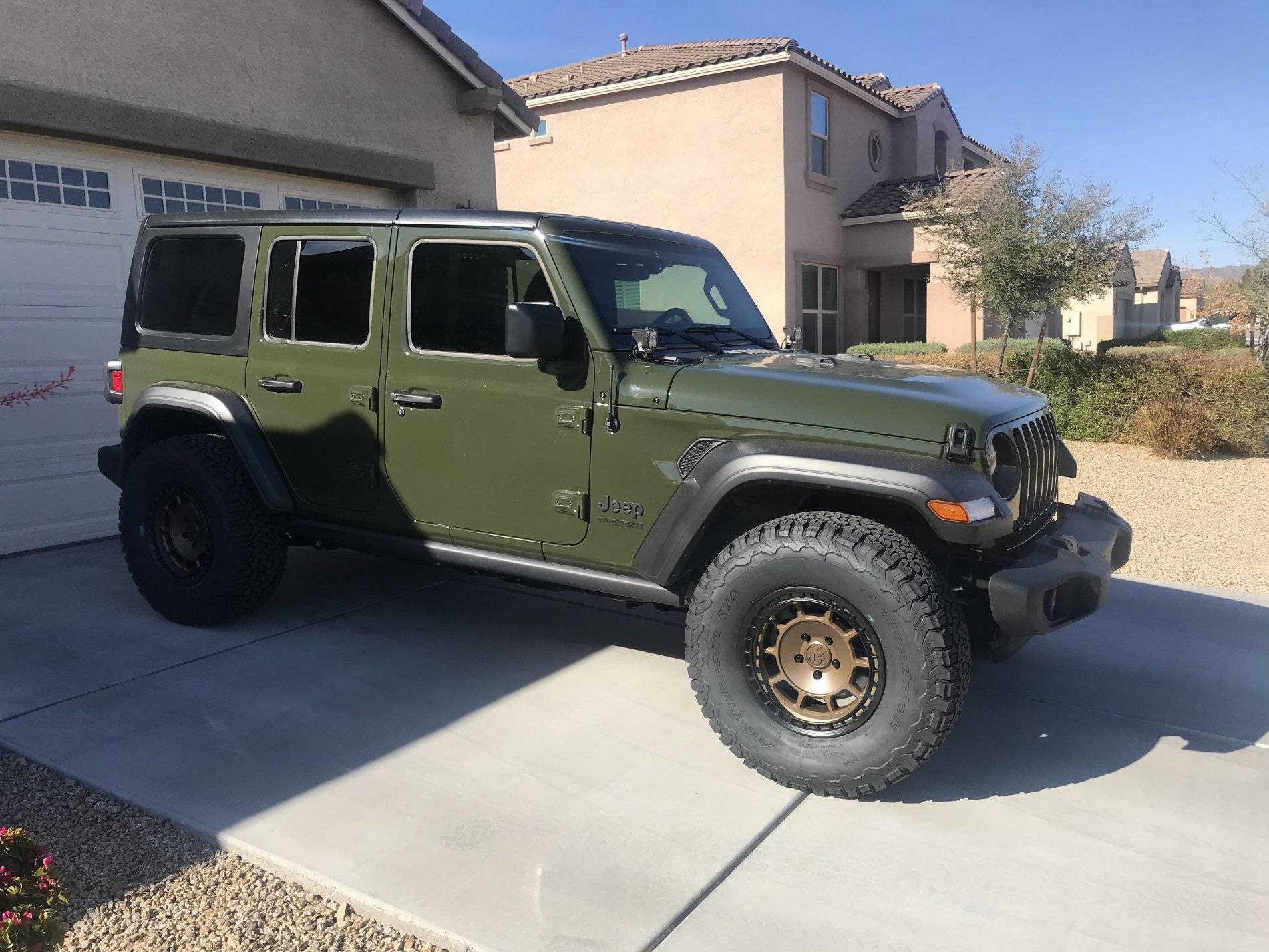

For reference to everyone with 33s this is mine with 35s and rubi take off

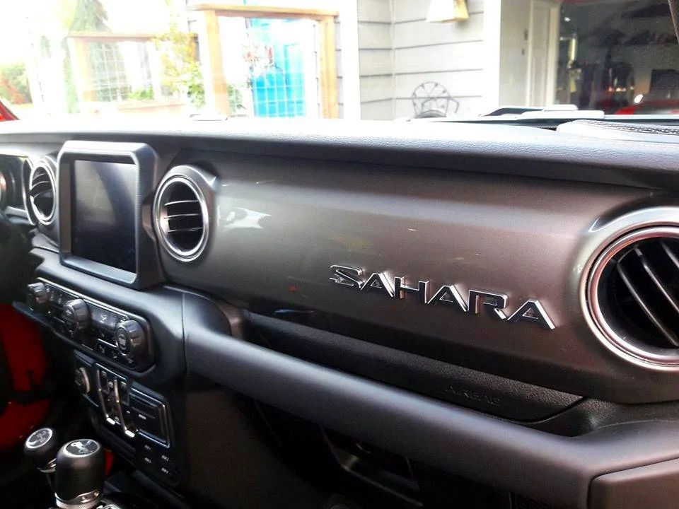

Not any more than those big plastic dashboard covers

Can you give me more details on your build?? Tire size, lift, other upgrades? I love the stance!
HELO 904 Wheels, tinted bronze, 20x9, -12 offset.
295/60R20 Cooper Discover AT3 tires (34.1" advertised)
For ride quality you should go with 17" wheels, as all tires that are 33" or taller for 18"or 20" wheels seems to be rated E - heavy and stiff. Good for handling in the corners, puncture resistant, but ride rougher.
17" you will have no problem finding C rated tire in 33". To get the same look with 17s, get same offset wheels -12, (8 or 9 wide), with 285/75R17 tires.
