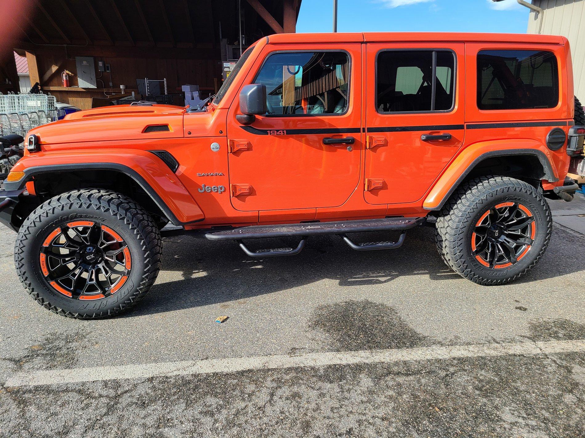

I actually love those wheels and tires as well as the front bumper, what are you running?
Rough Country bumper 37x12.50r20 Toyo mt and mayhem 20x10 wheel. Haven't had chance to re gear. Going to 4.56

I have a 2019 Sahara 2.0t. I have it pretty heavily built up. I knew I was going to be building it before I bought the jeep and after researching, still decided the Sahara was what I was looking for.
I have a 3.5" lift, 35s, bumpers, rails, lights, hood, cold air intake, and a few other things I'm forgetting while listing off the top of my head.
I considered a regear, but decided not to. While I rarely see 8th gear at this point, I still feel like the jeep drives very well. Still has great pick up and speed. Gas mileage is still pretty good too.
I see you mentioned wanting 37s. Had I got 37s, I probably would have gotten a regear. I ultimately decided 37s were unnecessary for me. Also, the 3.5" Rancho lift recommended not to go higher than 35s with that particular lift, which is the lift I wanted.
Besides just wanting to have a jeep because jeeps are awesome, I bought it with the primary focus of being able to drive in the snow and then light/mild trails and dirt/gravel roads around a farm, where I work. With those type of driving focuses in mind, my build works perfectly for me.
I'm very happy with my choice of the Sahara and my build so far. All our jeeps are our own, so as always, do what you feels best. But aside from the axles and the regear, the Sahara is still a great jeep to build.
