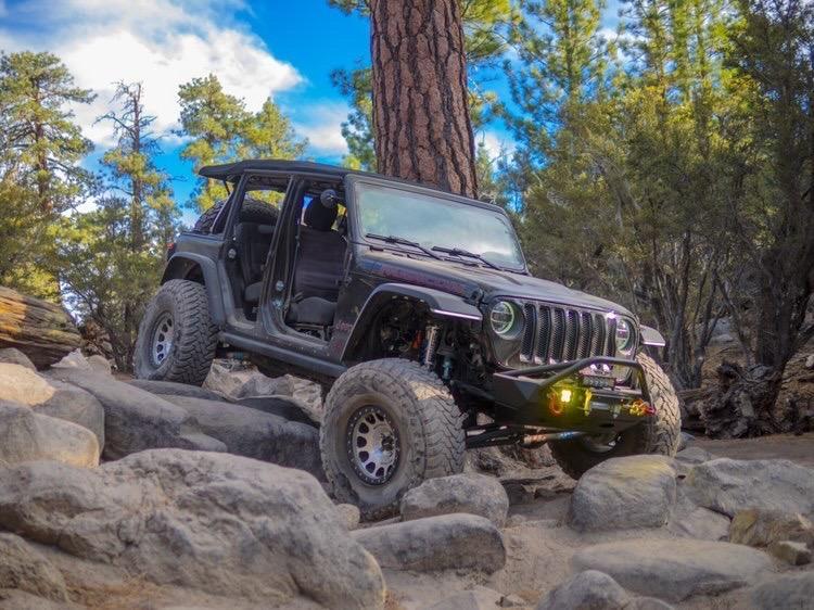

Been deep down this path running 2 bumpstops and 1 bumpstop flexing on a forklift and offroad with 2.5" lift, fender chop on 37s with a 17x8.5 with 4.7 backspacing and a 17x9 beadlock with 3.5 backspacing. Flexing with a forklift/ramp with your wheels straight isnt what I'm talking about. Your pic is simply showing droop with tires straight. Tires clear fine doing that. I'm talking about flexing your jeep with driver side front tire tucked up and then turning passenger or the same on the passenger side. It rubs the inner fender before you get to full lock with 37s. You'll definitely see it with 38s if you wheel it and flex it and turn a decent amount.
Way of life on youtube has excellent videos from last year where he tested clearances on 37s with kmc 17x8.5 wheels with 4.75 backspacing. He ended up adding a 1.75" wheel spacer to add clearance.
My results were the same as him. Another buddy of mine had the same spec wheels with 38s and also added a wheel spacer to push the wheels out for clearance. That's partly why Metalcloak and Rock Krawler recommend 4.5 backspacing or less with 37s and even less backspacing for bigger tires.
I didn't turn full lock wheelin obstacles in pics below and still rubbed the powder coat off my inner liners. Not a big deal...but I wish I had a little less backspacing than 4.75 running 37s.

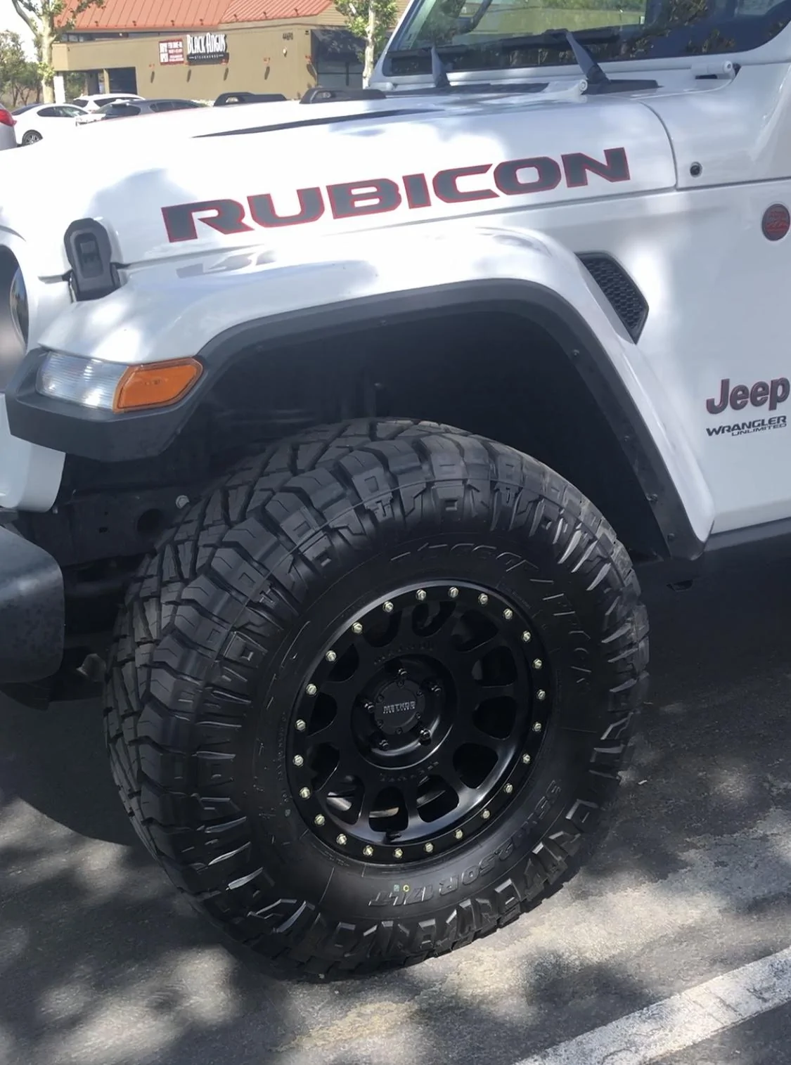

Method 305 NV 17x8.5 0 offset 4.75 backspace on KM3 37x12.5x17
I’m looking to run 37s with a Mopar lift and these exact wheels. Any running at full flex? Can you still turn the wheels at full flex?
I have no rubbing at full flex but I am running the MC upper bump stops which are about a half inch longer than stock and running two inch bumps stops on the bottom. I also did a little trimming of the stock fender liner.
