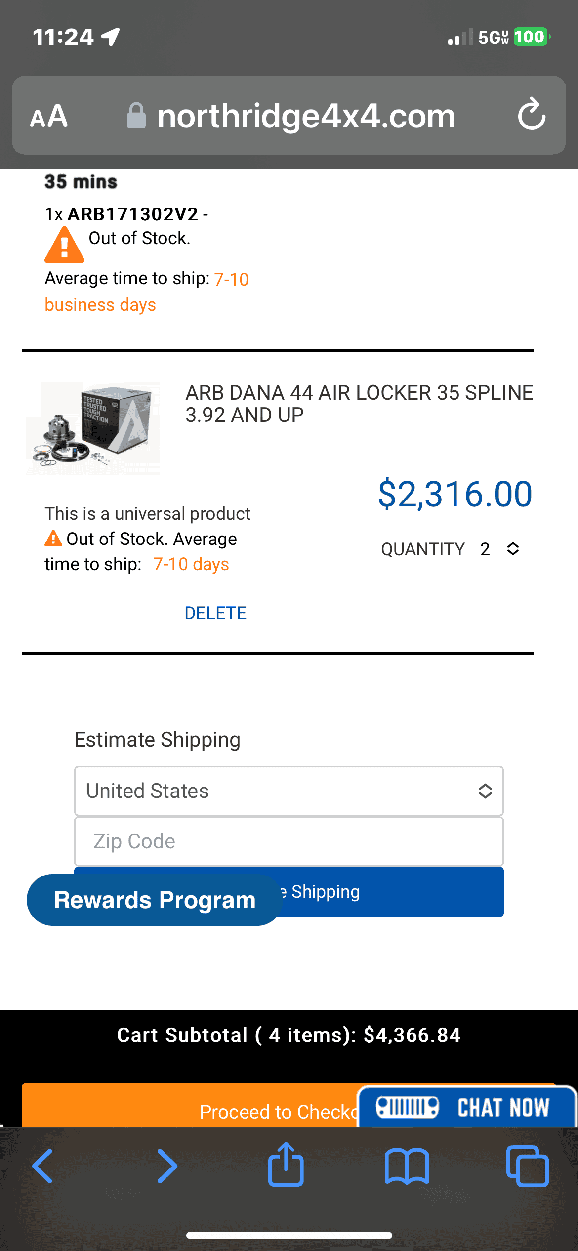

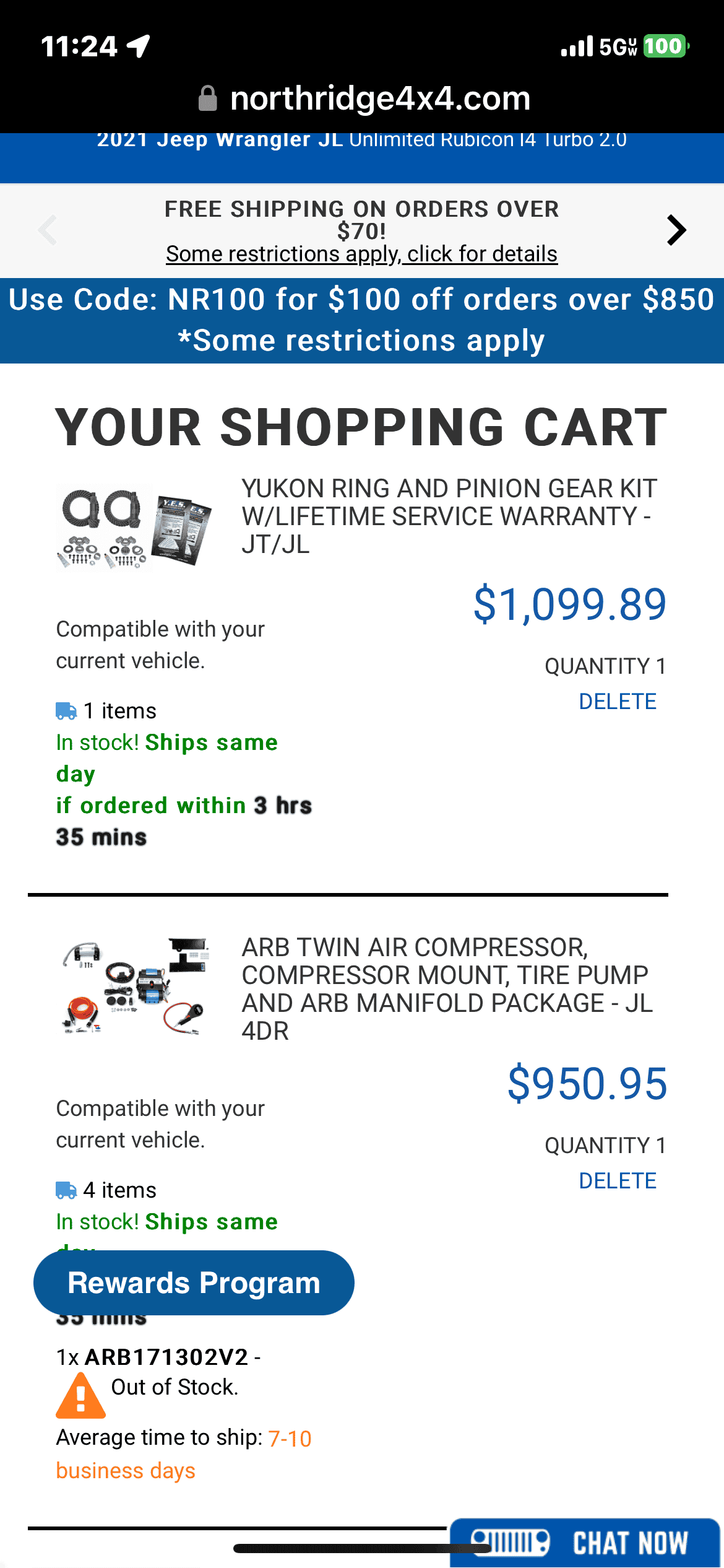

Maybe $7000 if it includes air compressor, gears and rebuild kit. Labor for just lockers or lockers and gears should be roughly the same. Plus labor to route air lines, mounts, etc. my list from northridge shows $4366 in parts. Rough price. But that’s gears, lockers, arb dual air compressor , plus other parts needed. Before any discounts.
So that leaves $2600 in labor. $1000 per axle to install lockers and set gears and $600 to install compressor and route air lines.
It just seems a little high to me. But it might be more for labor in your area.
