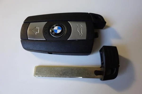

Having a remote for unlocking the doors of a vehicle is nice, but having a key that you can use to physically unlock them when the battery is COMPLETELY dead is also nice. There's a few posts that I've read on the internet from people who have found out that it was possible to lock themselves out of their keyless car if the battery was dead or if they were replacing the battery. Supposedly, it's possible to do that on my wife's BMW when you are replacing the battery since it is in the trunk and if you make the mistake of closing the lid on the trunk while you are taking the dead battery to the store to swap it out.
The people who lock themselves out of their BMWs are the ones who don't know that there's a metal blade key inside the fob. You can physically unlock the Wrangler as well.
