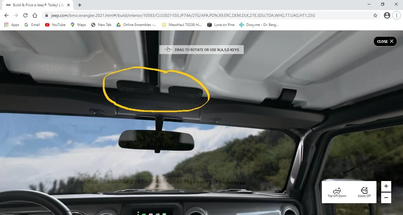

Do JLs shipped with soft tops only (like the Rubi you are getting) come with the brackets on to which the Freedom Panel's forward and midline latches attach to?
If you refer to the thread I linked above, I'm fairly certain it indicates they do not.
Gotcha Dave:
when you wrote "...remove the 2 pieces that the freedom panels latch to on the windshield header" I thought about the front latches closer to either side of the vehicle, not the ones closer to midline. :)

2x brackets on the header panel, 2x brackets on the roll cage, 6x bolts holding the hardtop to the tub. You will need to change the wiper stalk, wiring, washer pump and plumbing to make it functional.

Did the same transition to my Rubi (Bought it only with soft top, got later an used hardtop).
If the new car is sold with soft top only (like mine), you will miss the brackets already mentioned above. DV8 has them at a very good price (paid 90 bucks).
