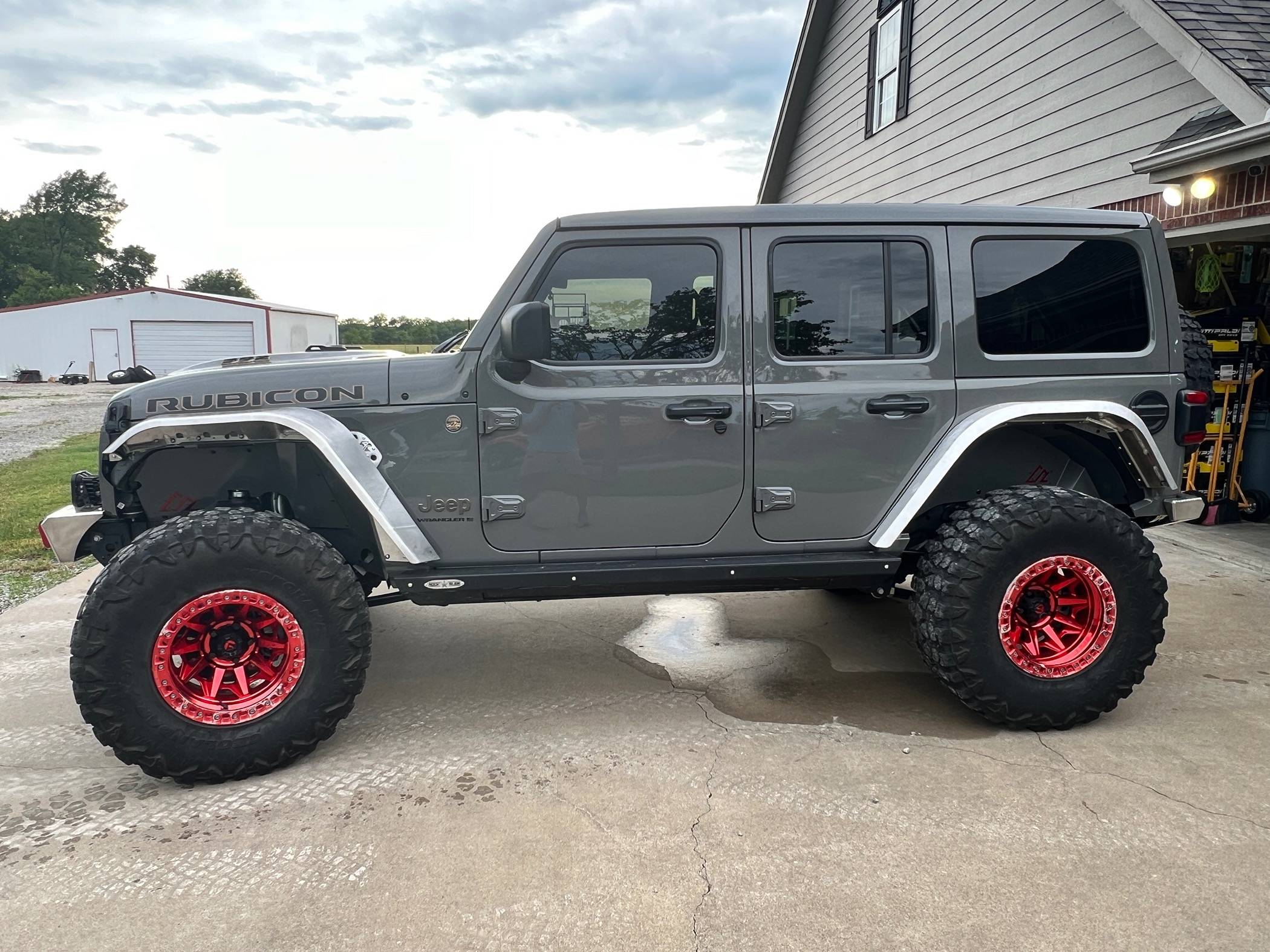

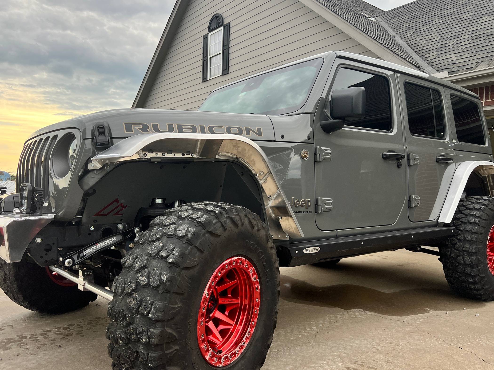

Disclaimer I have AAL inner fenders front (already installed) and rear installed at same time as NVM fenders.
Mostly finished need a little more tuning on the rears but they were definitely the easiest to do and all the bolt variances made sense as to what went where. Not super happy with the gap even with the filler plate as I did not purchase the corner armor. I ended up adding some foam tape to reduce the gap. Pass AAL can’t get a couple of the dzus in and need to tweak it.
The fronts were more challenging for me and I need to double check I have drl functionality I have not seen any white light work at all but the turns and hazards in yellow work perfectly and I can plug the stock light back in and it lights up. Also have seen the dash message twice the left front turn signal is out then goes off?
Would be pretty fast to do another set and especially fast if not for the AAL inners.

Issue with the drl was a short between the drivers seat and steering wheel. Turns out you have to pull out of the garage for your headlights to go off and the drl to come on! Who knew.
Still getting quick flashing blinker every use and intermittent turn signal out message. Will have to call NVM and see if they have any advice.
Leaning towards having them painted to match body. Thoughts?

Are the external turn signals blinking at a normal rate but you are getting hyper flash of the turn signal and bulb out message on the dash?
As a last resort you can tell the vehicle to ignore the cause of this with a Tazer or JSCAN.
Edited to add…those fenders are bad ass…my vote is for body color

Looks nice! I think color matched to the Jeep would look even better.
