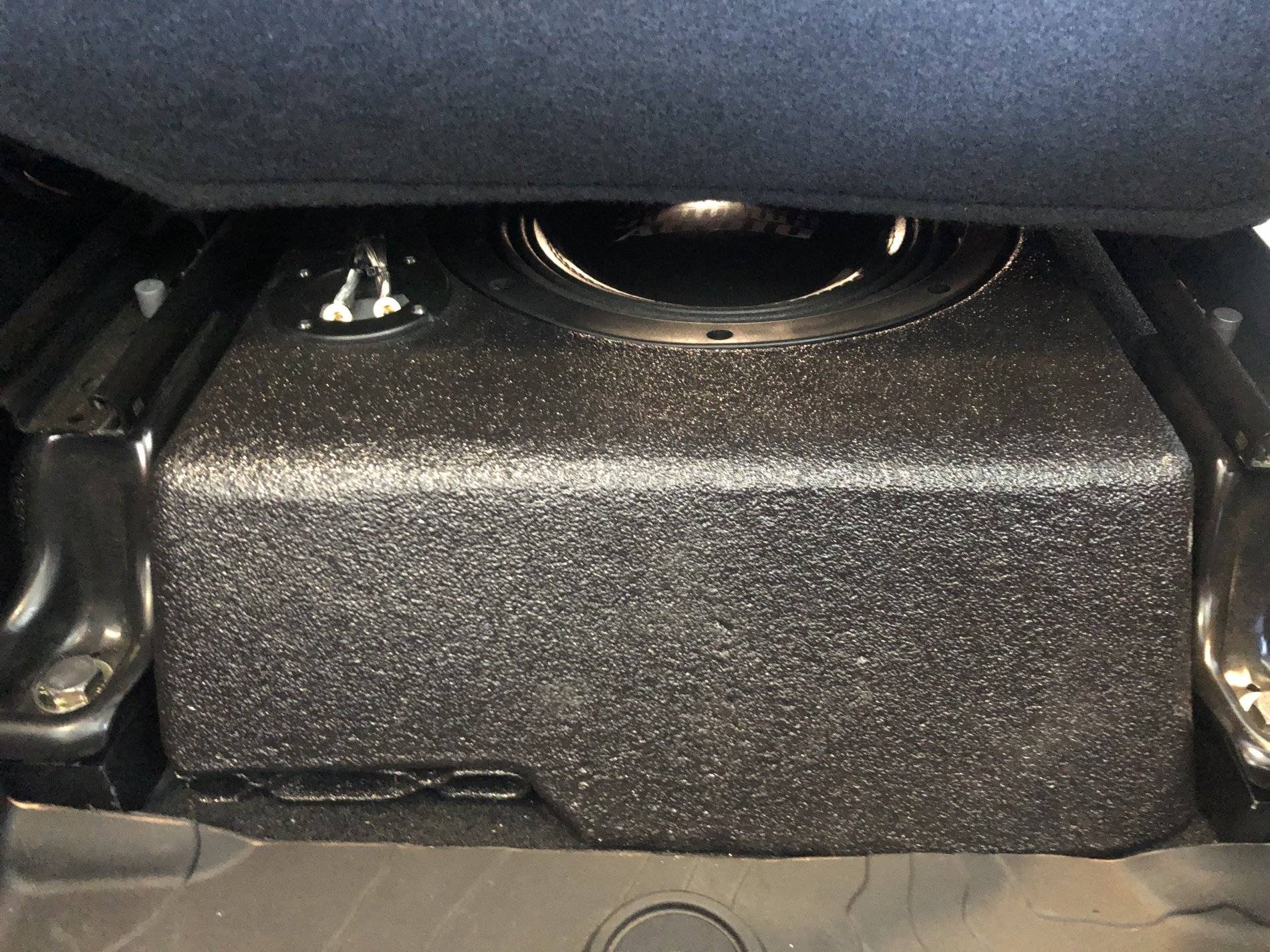

I think it pretty ironic they call them stealth boxes when you can see them in plain sight. Nothing hidden about it. I fabricated my own "stealth boxes" that are actually hidden under both of the front seats that have the same internal volume, can run a 10" shallow woofer and handle double the power for less money, just my time (although your local shop may charge a bit more). You can see the side of the enclosure with the doors off, but no one would know what it is.

How much volume were you able to get out of them, what did you do about the under seat vents, any issues with seat movement, and where did you stick your amp(s)?
.6 cu ft. We are using 10" Sundown SD-4s that handle 600w each although we have a 1500w amp on the pair with no problem. The SQ woofers with minimal distortion but when you pair them up, they are pretty loud. You can hear them with the top and doors off because they are under you,
We molded channels for the vents so they still blow air into the back seats. No issues at all with seat movement. You can see it in the lower left of the enclosure from the back.

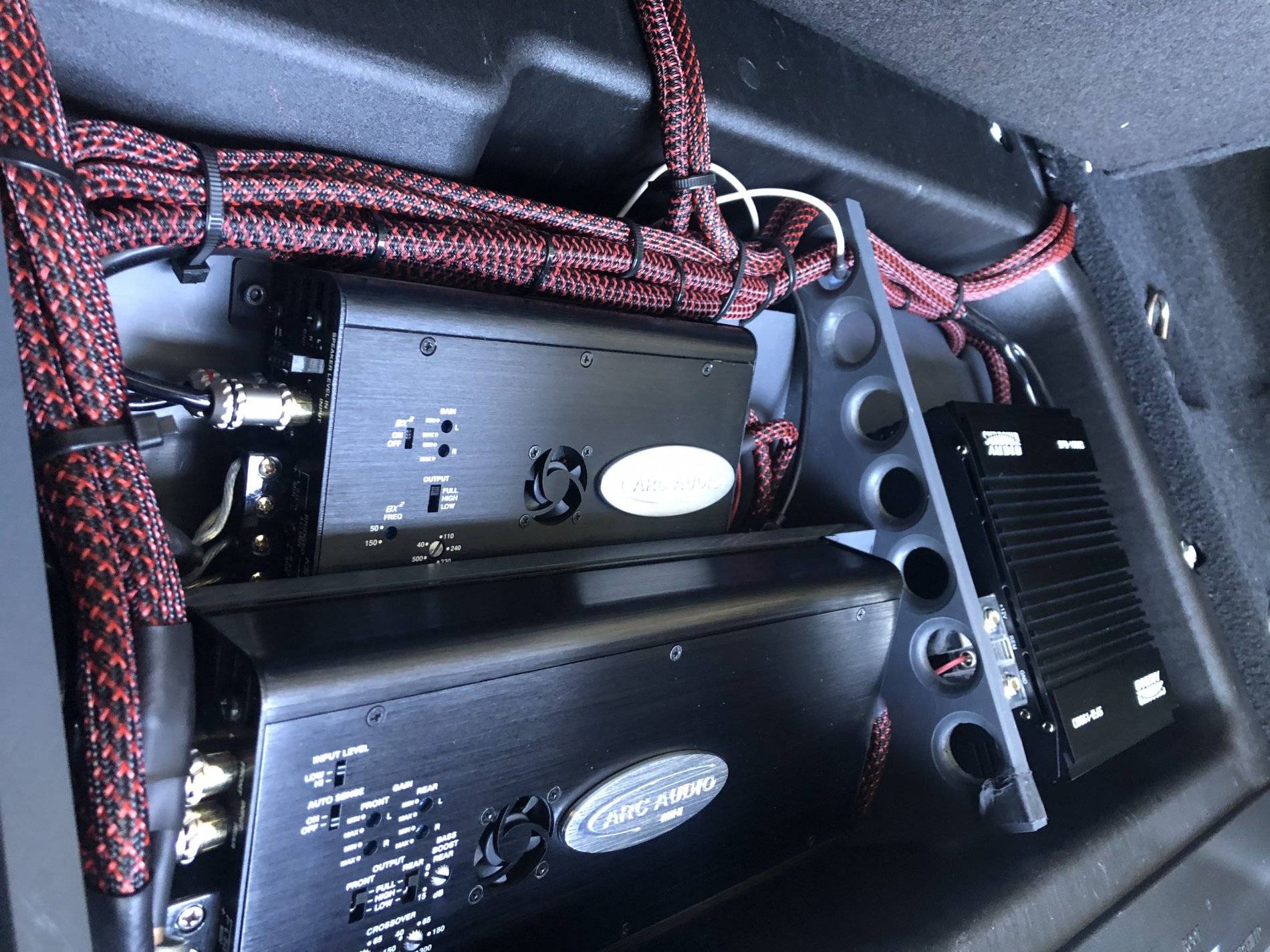

Amps are all on an amps rack in the back storage area. Needed 6 channels for the front components and the mono Sundown amp is to the far right. We mounted them at an angle so if any water got into the storage area, it would run off and not pool under the amps.
Jeep Wrangler JL Jl audio stealthbox released Amp Rack 2
