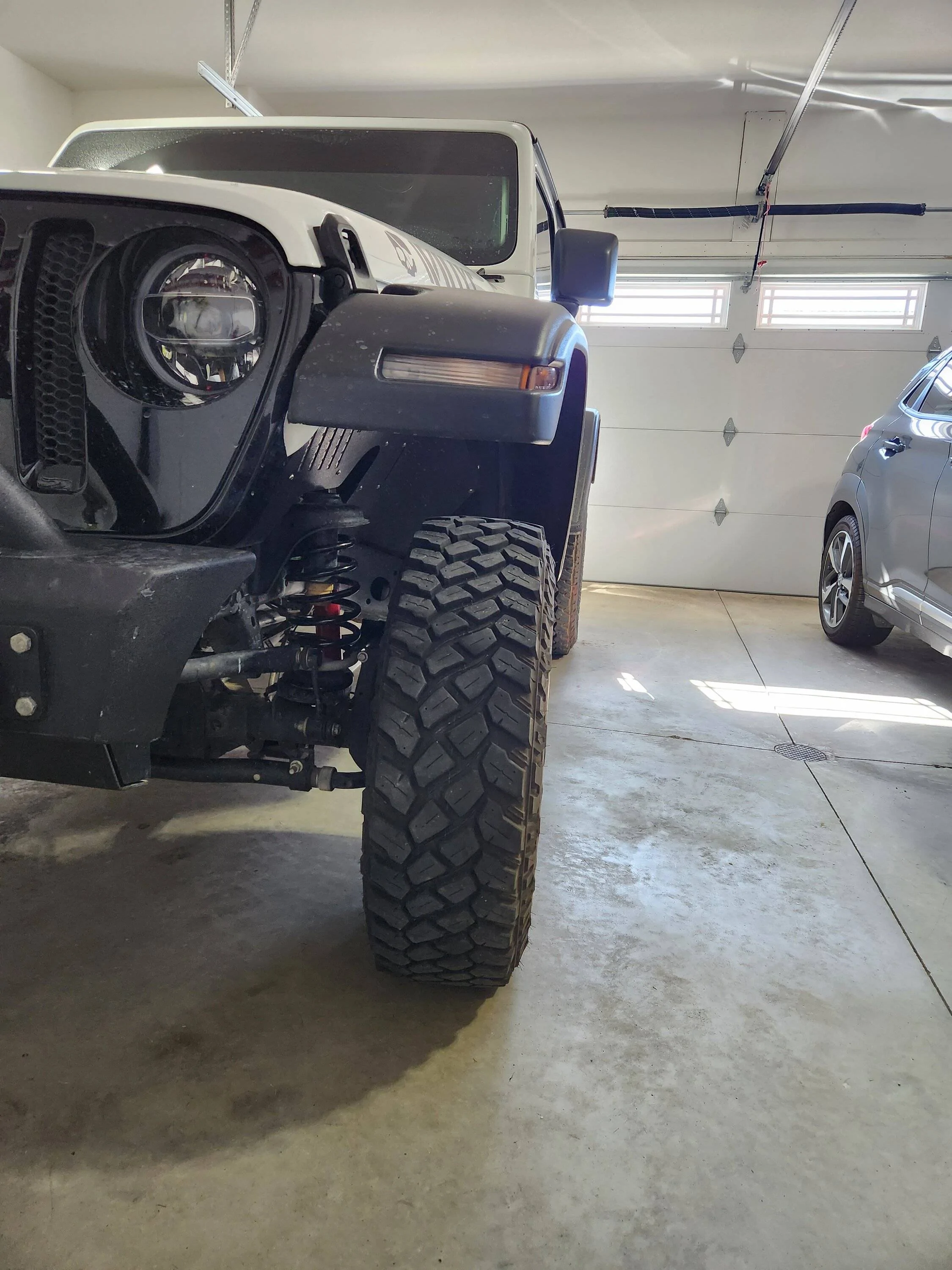

Finally some momentum. Picked up a JLUR Diesel suspension today. Only needed the springs but couldn't pass up the deal.

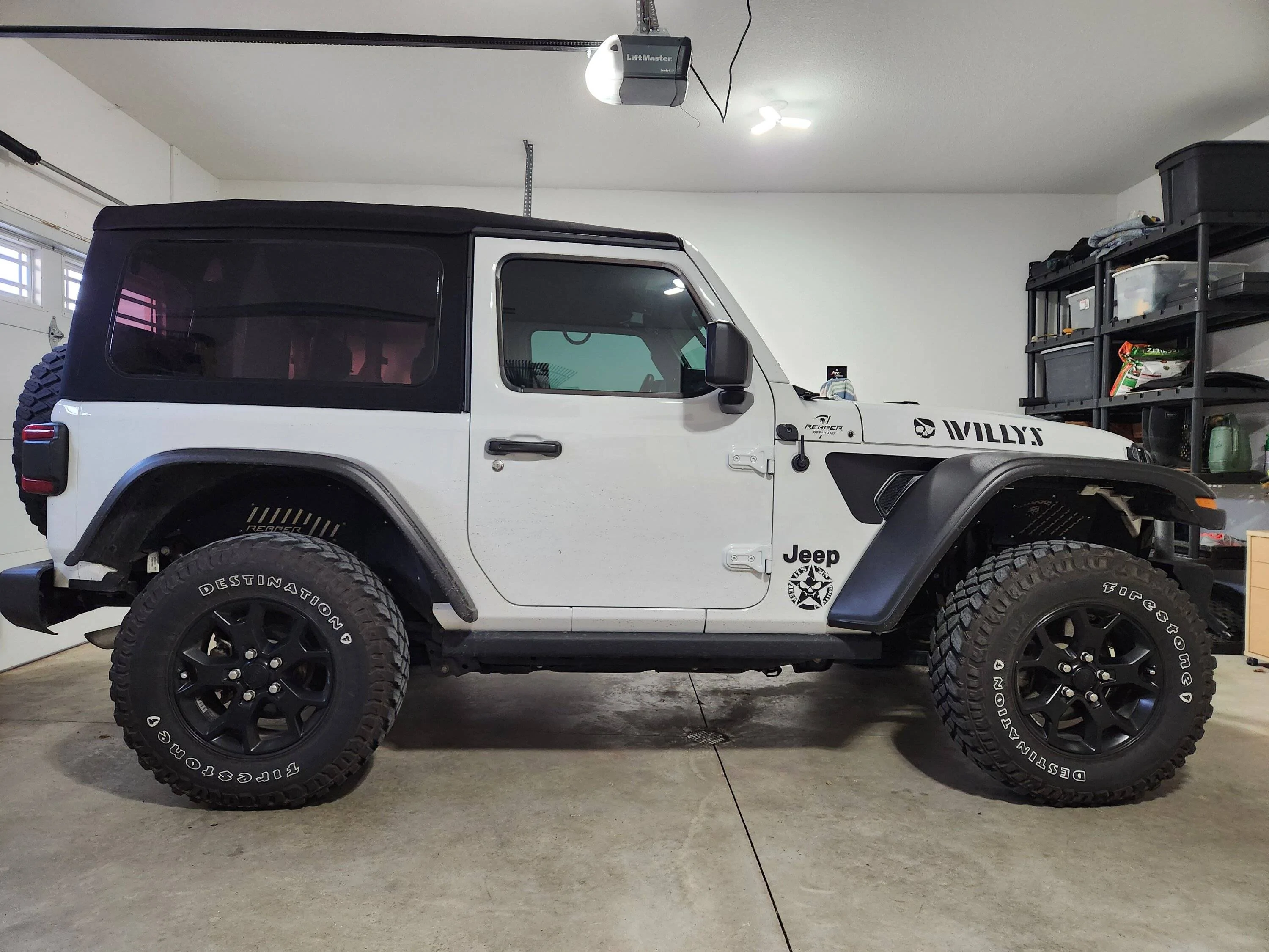

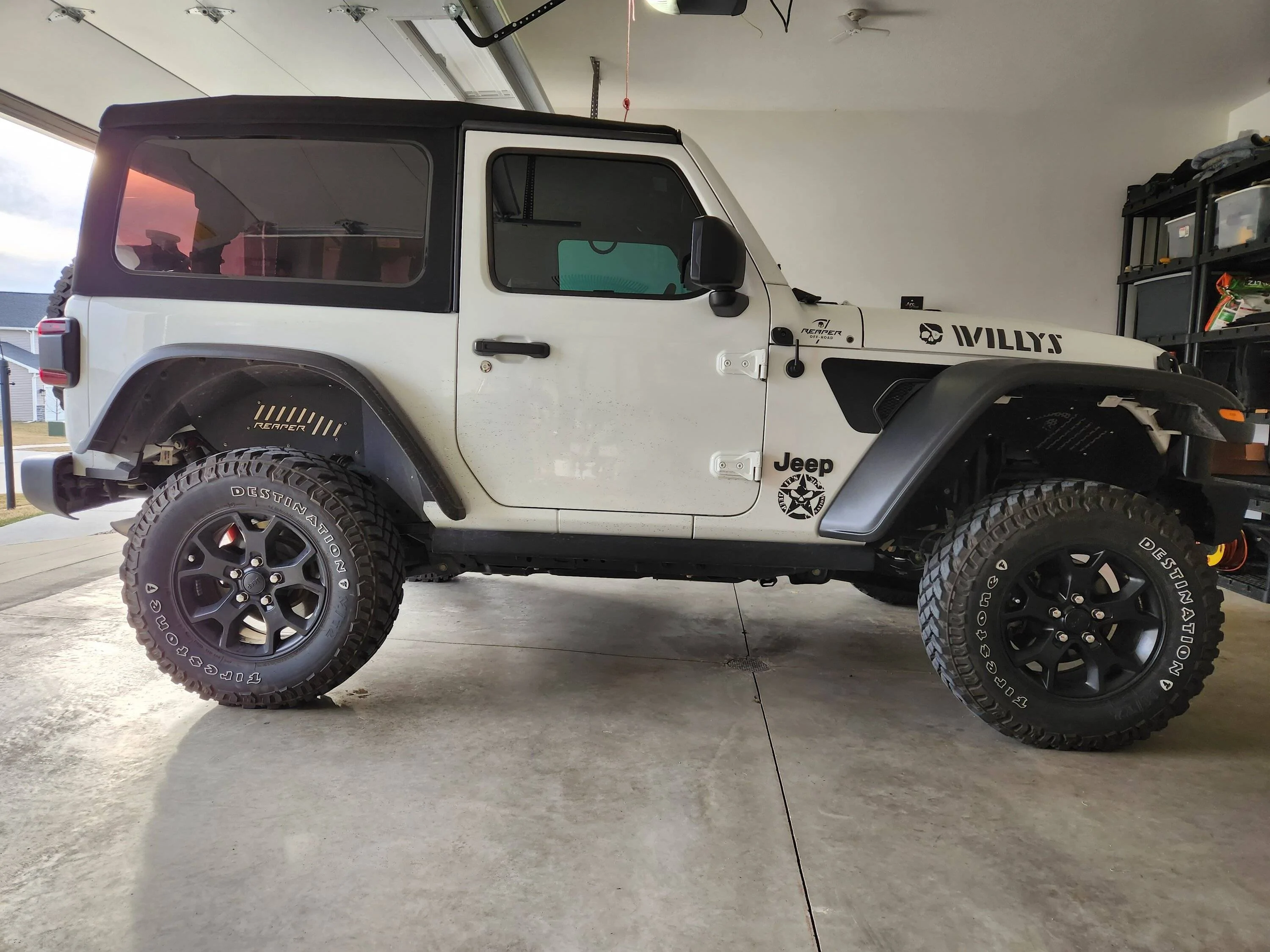

Took the time Saturday to do the swap.
Before
Jeep Wrangler JL Jim's first Wrangler 20230204_072333
After
Jeep Wrangler JL Jim's first Wrangler 20230204_155624
Gained about 3" all the way around. I put in the JLUR diesel springs and shocks, along with new LCAs from the MOPAR lift. Only took about 4 hours of work doing it all with hand tools.
Jeep went up on 4 jack stands. Dropped the axles and did both sides ar the same time.
Only real issue we had was getting that 190 ft. lbs of torque on the LCAs once she was back on the ground. Not a lot of room in there for leverage.

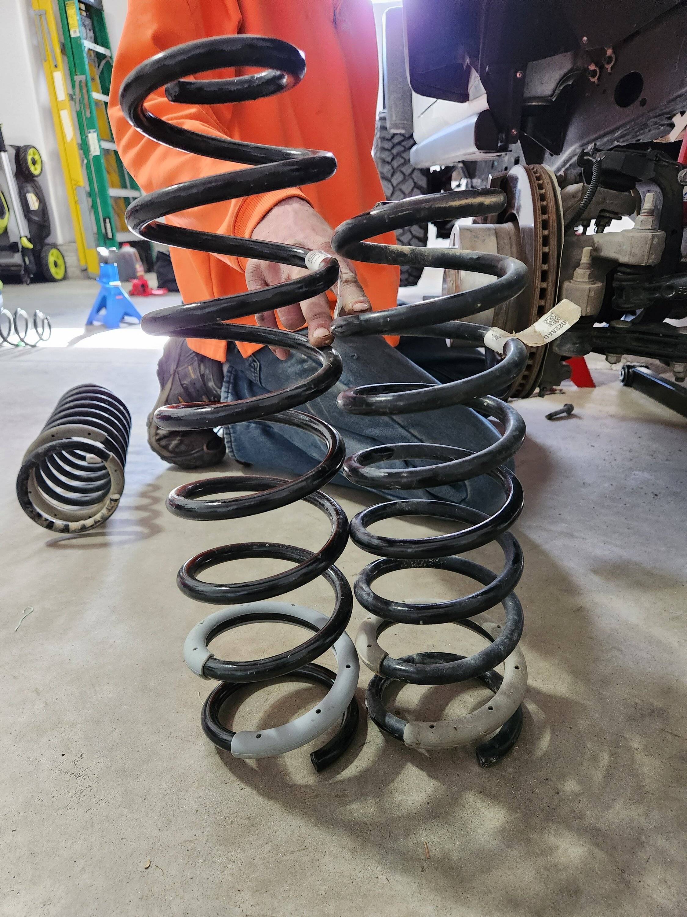

Just to compare, this is the front spring from the Rubi on the left and mine on the right.

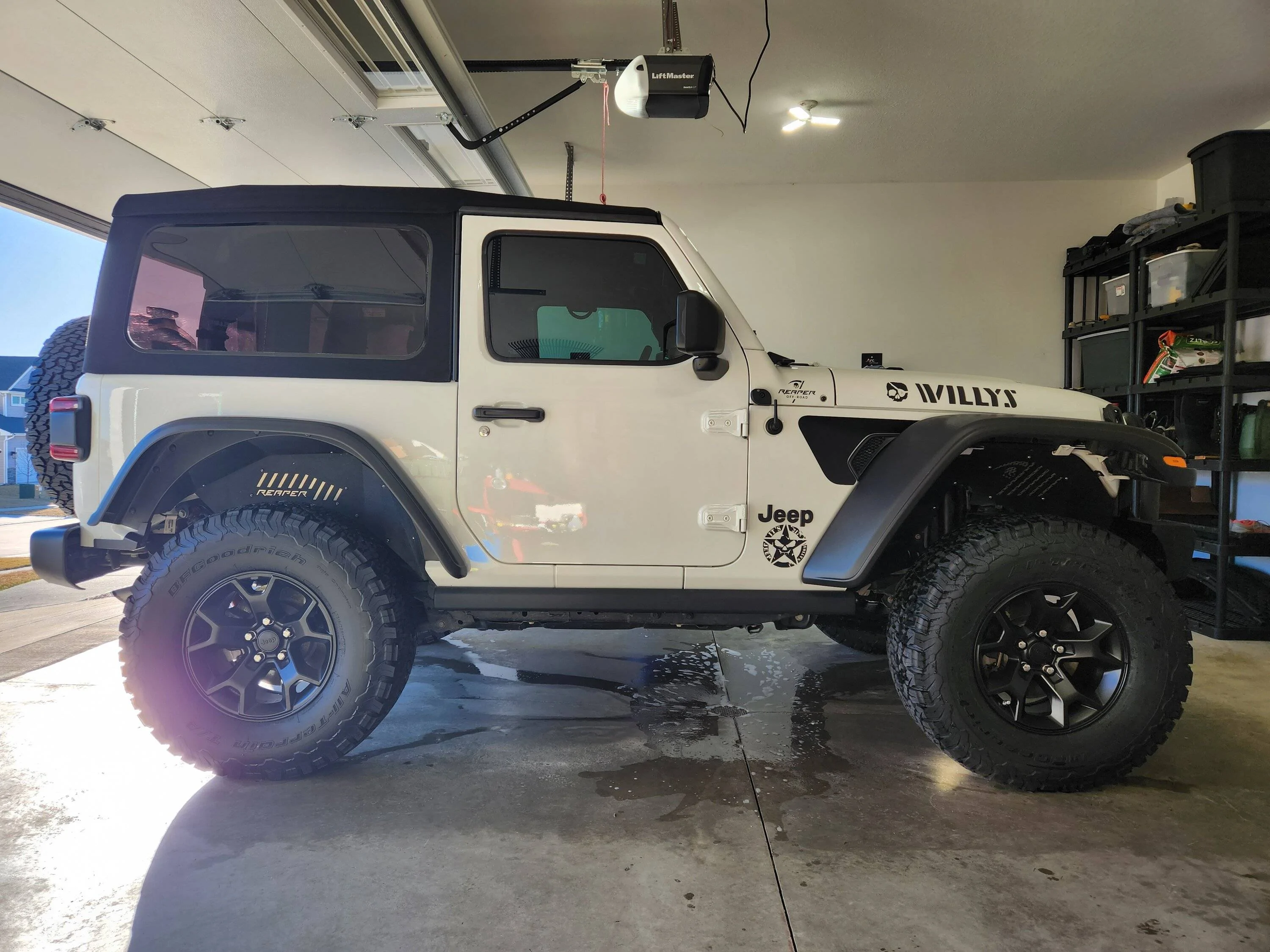

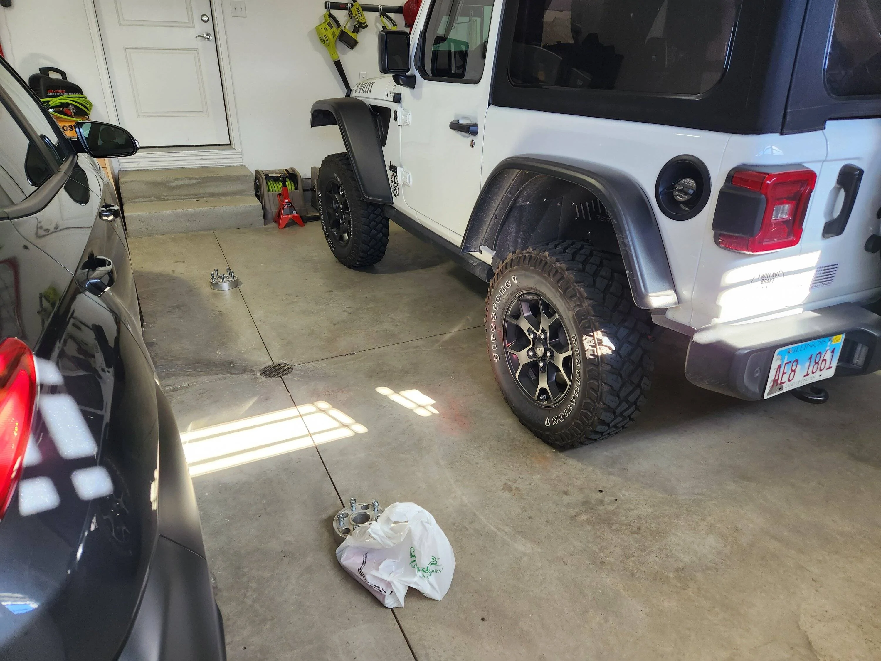

Removed the 2" wheel spacers. Today, she goes in for new tires and wheels.
Jeep Wrangler JL Jim's first Wrangler 20230211_111157
Jeep Wrangler JL Jim's first Wrangler 20230211_110651

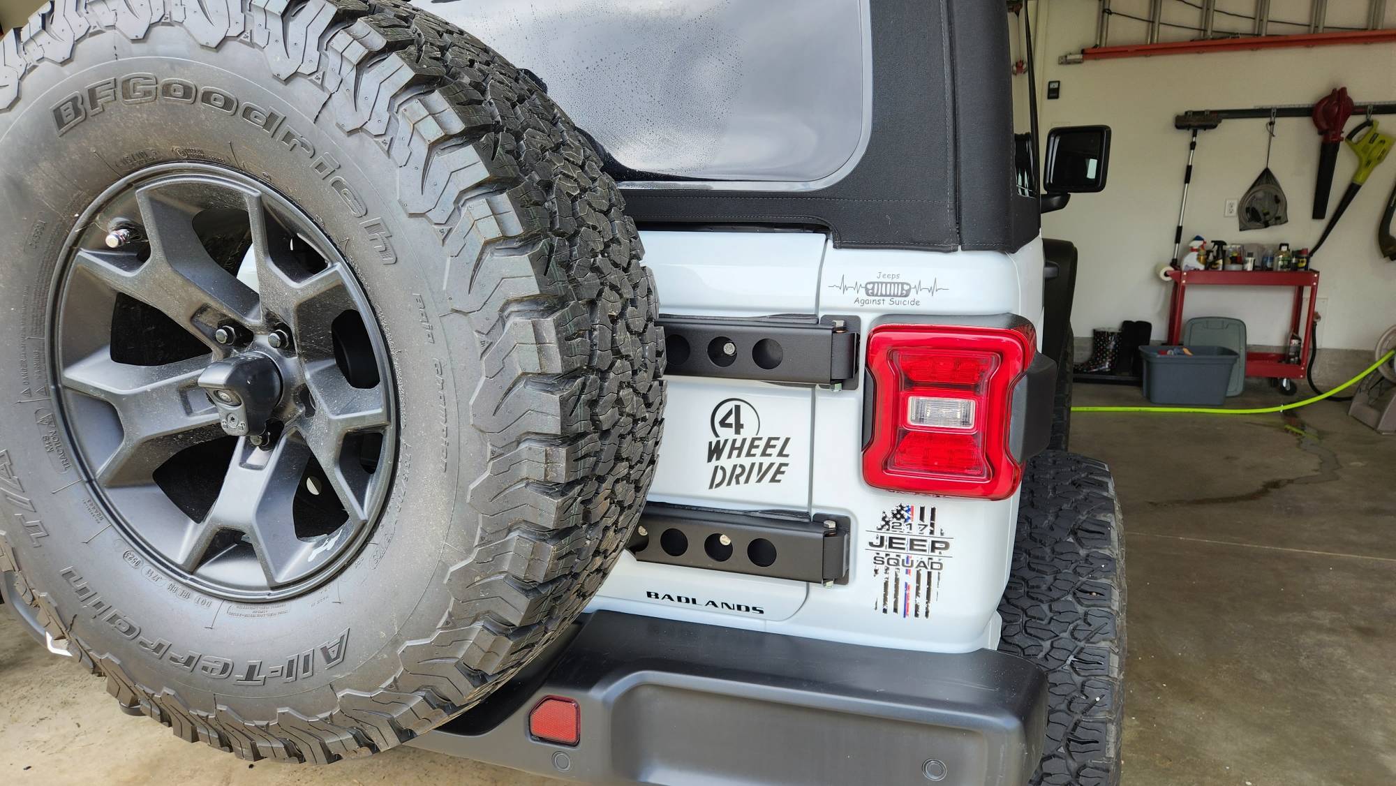

I liked the look of the stock Willys Wheels so I went with a set of Quadratec Morphics wrapped in KO2s.
Jeep Wrangler JL Jim's first Wrangler FB_IMG_1675984839165

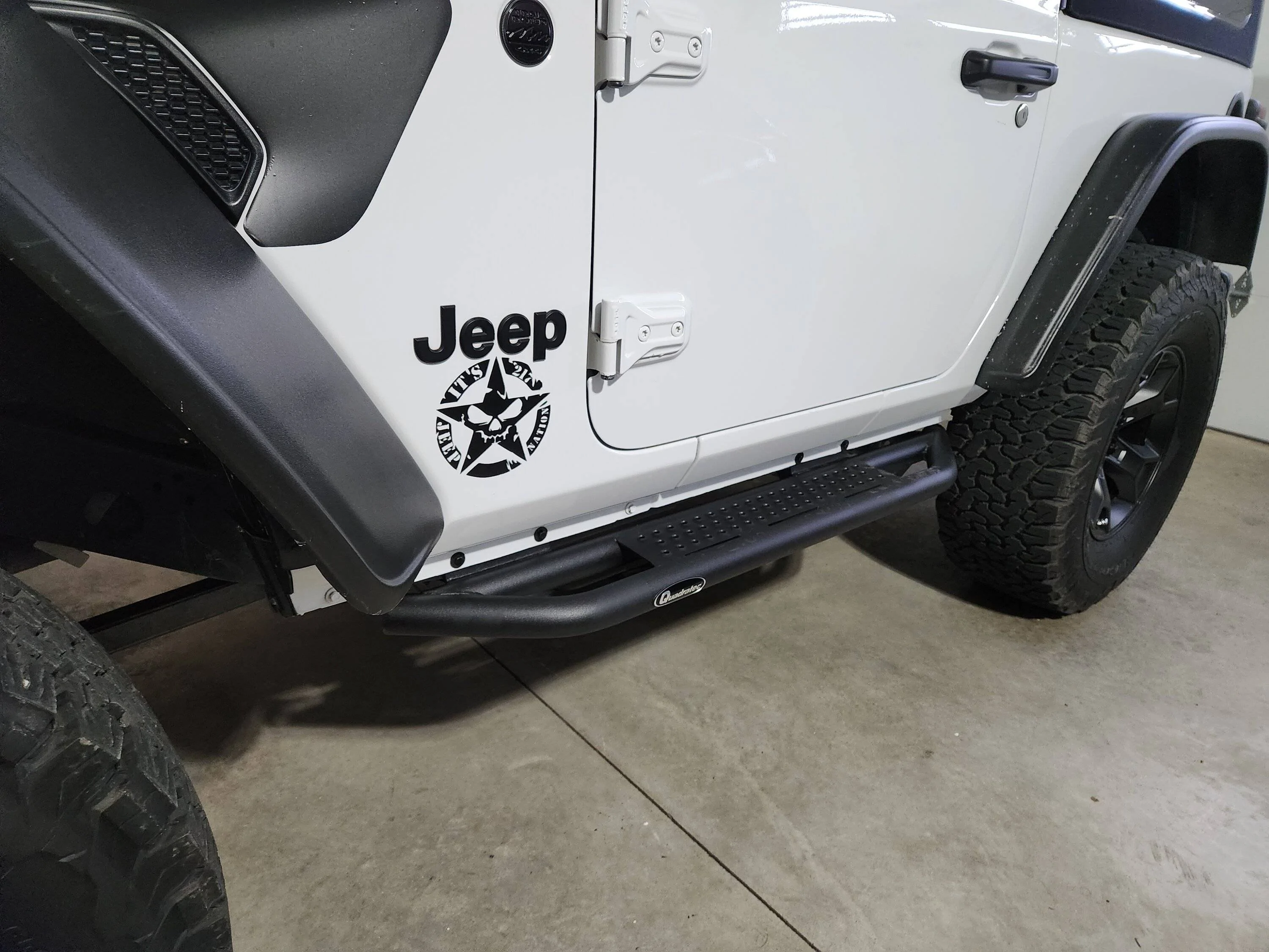

After watching my wife struggle to get in, I had to get some steps. Went with the Quadratec QRC Side Armor with Steps.
This is the one reason I’ve not lifted my WIllys. My wife is short to begin with and even at stock height, she has issues getting into the Jeep. But we both love our find and we enjoy it once we’re in and running the roads and trails. After 48 years of marriage and my wife putting up with me in the Military for 24 years of that time, SHE deserves the respect!

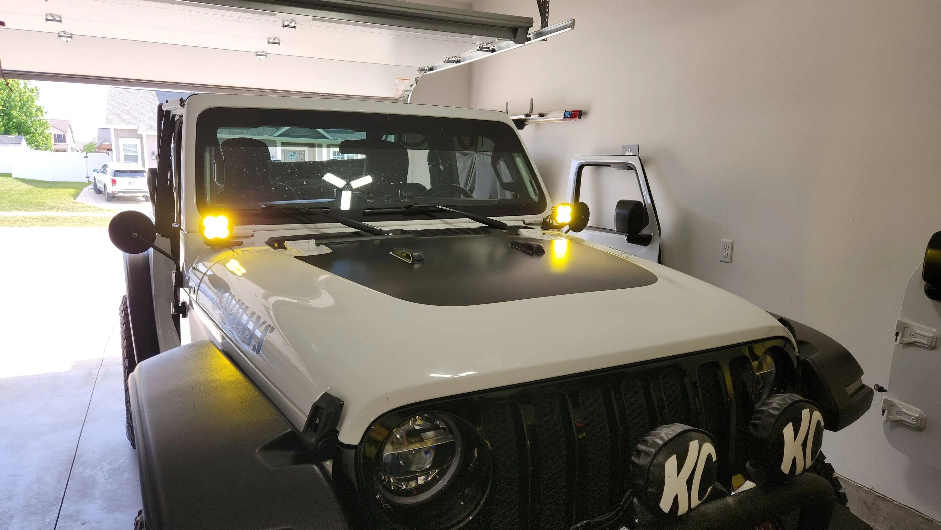

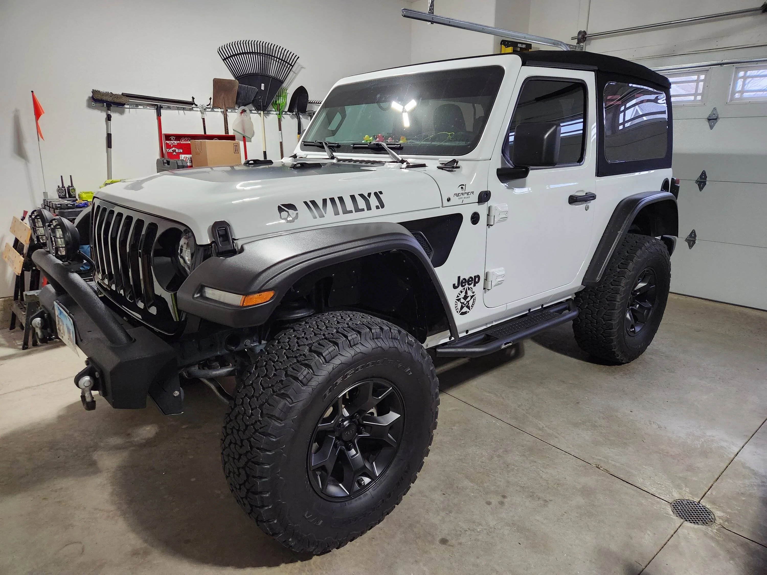

Finally got around to wiring in my Diode Dynamics lights and installing the winch.
I went with the Badlands ZXR9500. Mote than enough for my little 2-door.
Jeep Wrangler JL Jim's first Wrangler 20230528_155735
Jeep Wrangler JL Jim's first Wrangler 20230522_185916
