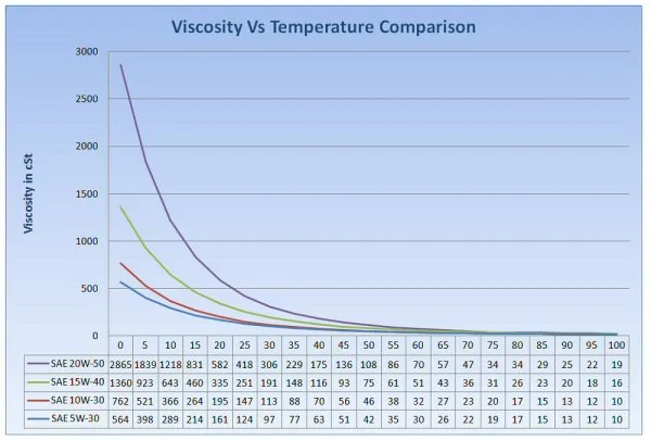

Can you do a rough guess how much? 5w30 at 40 degrees = 0w20 at ???

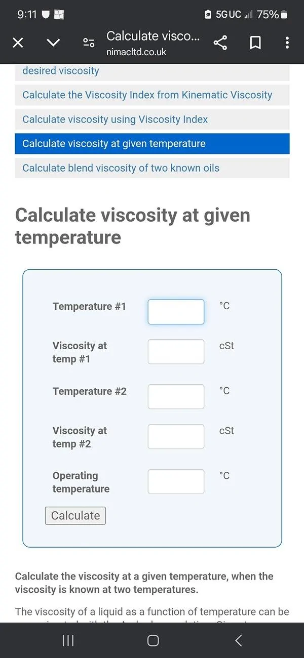

Does a physical equation exist to give you exact values?

Jeep Wrangler JL Jeep Junkie's questions graph_4_viscosity_comparison
This doesn't show 0w-20, but it gives you an idea of how much the viscosity of thicker oil varies at colder temperatures.
