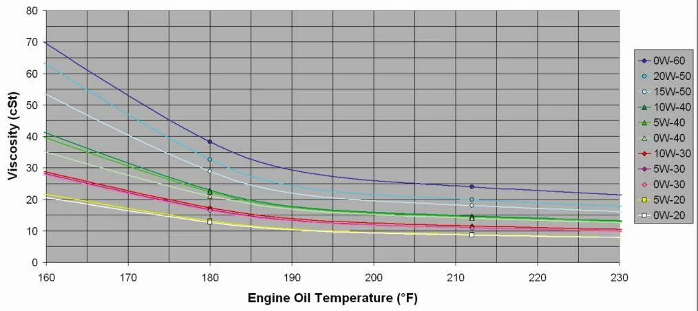

No, 5w-30 will be slightly thicker across the temp ranges. It's slightly less viscous at both of the blended ratings.

Wait, I had to reread your question, if you look at the chart I posted above. 5w-30 at 175° will be the same viscosity as 0w-20 at 162°.
