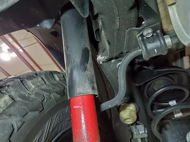

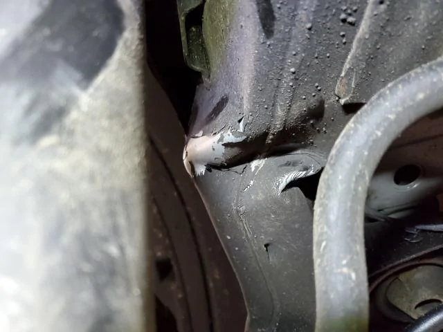

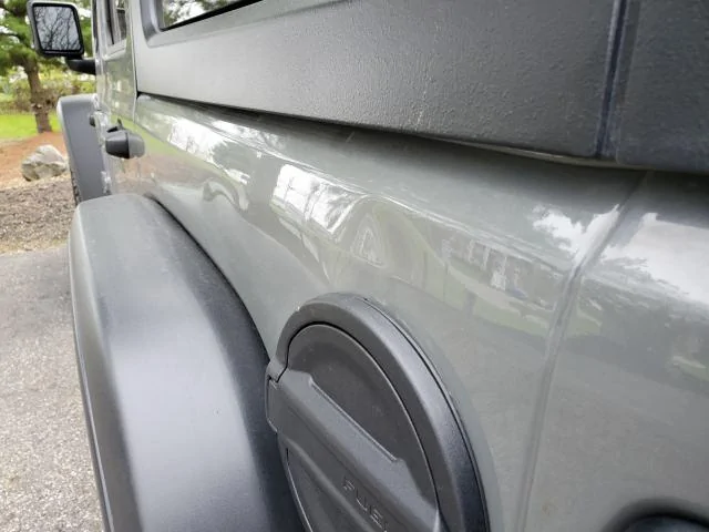

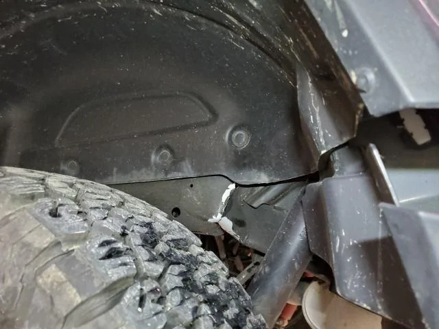

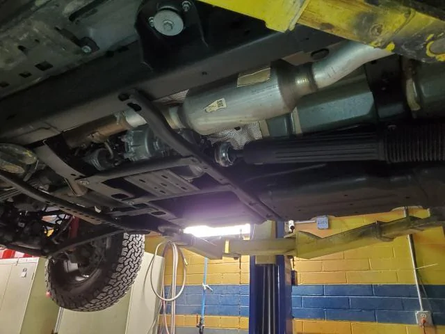

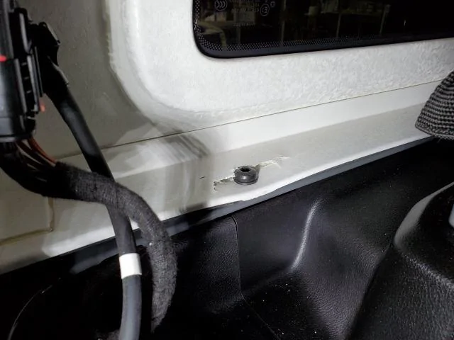

Pictures.
New estimate came in at 11,127

Looks like your tow hitch saved you a lot of sheet metal damage, though it appears to have transferred a lot of energy directly to the frame. A frame replacement is going to have you back to new and I bet you will barely notice it. Hope they can throw in installation of your lift kit!

The hitch being on seem to really send the force straight into the frame. By the time she hit the corner driver side of bumper I think a lot energy had been lost. It is unfortunate as we usually do not have that hitch on there but we had just dropped our little boat and were running to pickup a part.
I am at least doing a different exhaust. The muffler was damaged and it's a little over 440 to replace. For that I can get a SS hi tuck cat back. With a lot if manufacturers being shut done hard to find stuff to get here quick enough. We will see.

As badly folded as that frame rail is it is definitely not safely repairable. And for what it's worth, it performed as designed. By folding at designed in points it absorbed a lot of energy protecting you.
My '07 JKU frame rail looked about the same.
