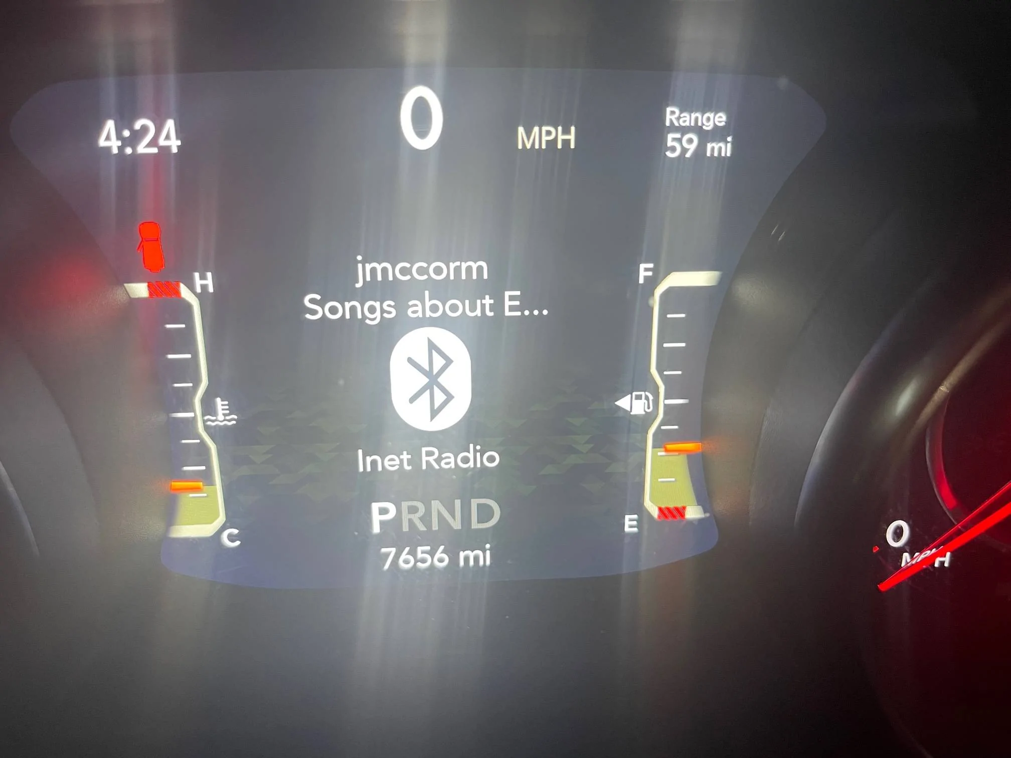

After a remote-start, one of the side-effects of turning on the HVAC system is that it also turns on the uConnect radio. "THUMP THUMP THUMP THUMP." My neighbors don't need a wicked thumping bass line in the morning (or, well, probably ever).
The following script "mute" will report if the vehicle is currently muted or not (ON or OFF). You can mute and unmute the uConnect radio by saying "mute on" or "mute off". Those commands intelligently use the mute toggle button (only if needed) to achieve the desired result.
The latest iteration of my REMOTE-SMART auto-HVAC code will mute the stereo after the vehicle is started and unmutes it when the driver puts his hands on the keyless entry door handle. (Or unlocks the door. Or opens the door. Or hits the ignition button to unlock from remote-start mode.)
Code follows for the cool nerds. And Jeepeto. ?

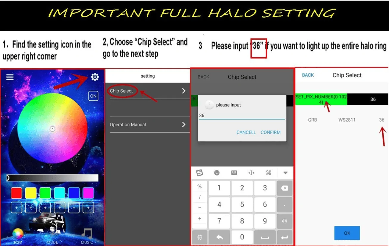

I just now noticed how much of the underlying technology was given away by one of their product images at Amazon.
Jeep Wrangler JL JEEP HACKING CAN-C / CAN-IHS / UDS ! (Reverse Engineering) 1642909096049
So it is a WS2811-compatible array of individually addressable LED chips? Okay. Now I know what that is. I'm assuming that their microcontroller addresses both halos simultaneously (with the same pattern) so there are a shared 36 LED elements per halo. That puts each one spaced 10 degrees apart.
There are quite a few libraries and projects for Arduino and Raspberry Pi which allow you to directly control arrays of WS2811 compatible lights. In fact, they typically control much larger arrays... hundreds of elements off of a single GPIO line.
My preference is still going to be to use this device's own built-in bluetooth controller like a subprocessor where I tell it the color or pattern I want it to play and let it handle all the work. But I've never reverse engineered a bluetooth device before, so I don't know how much trouble that's going to be.
At least this opens the door to a plan B where I can take control of the LED segments and pump whatever color pattern into them that I see fit.
EDIT: If I only had the time to burn, I'd create a CAN-aware WS2811 controller. Given the opportunity to spread RGB devices around a vehicle, that actually starts to make some sense.

Printing a String to EVIC
I'll need someone to test this because I can't so easily go back-and-forth between my PC and my vehicle. I created a script called 'evic' where you supply a line number (3=title line, 2=artist line,1=device name) and a text message, and it displays that on the music screen of the dash (kind of like a Taser does).
Can someone try it out and let me know if it works okay? (Just don't let the messages get too long.) You give it the line number and then the string you want to say. Also remember that one of them (I think it is the Device Name or #1) clears the screen. Examples:
evic 1 Inet Radio
evic 2 jmccorm
evic 3 Songs about EVIC
UPDATE: It works!

This is going to be a really big help to me because now I can print debug information to the dash and see what's going on without hooking up a keyboard and mouse to the vehicle.
UPDATE: I reduced some of the sleep values which allows this to run faster. I also changed the final message to all zeros, as it should have been.
