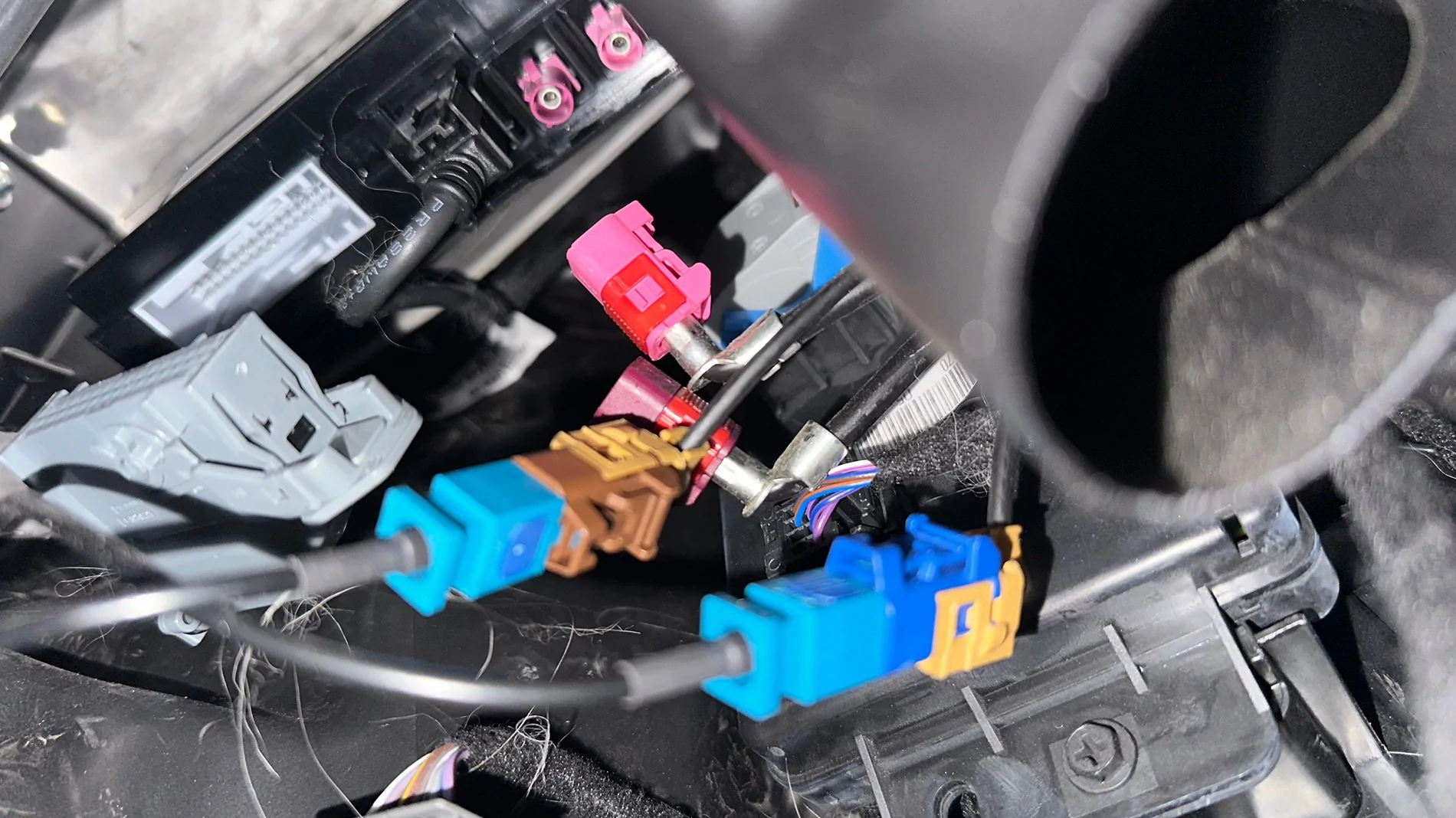

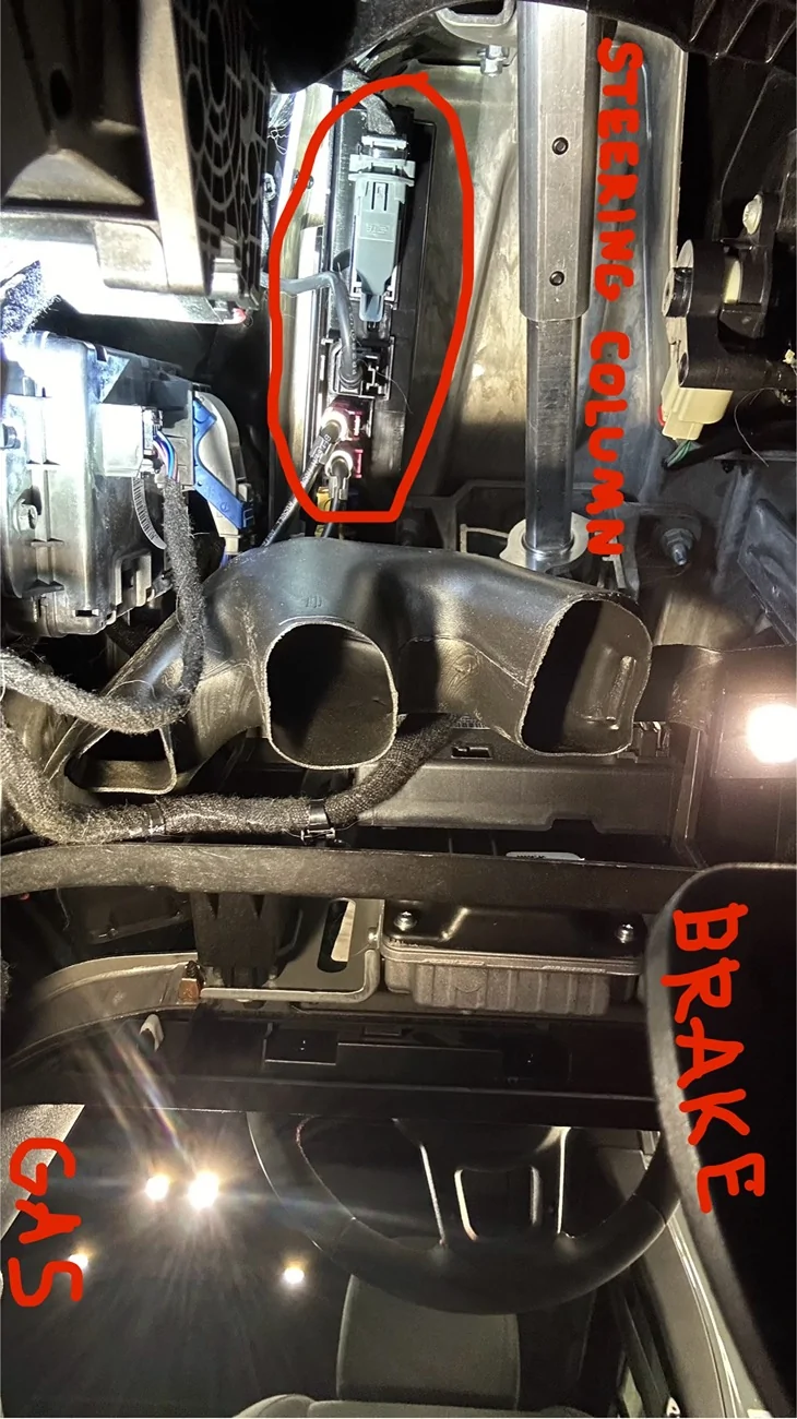

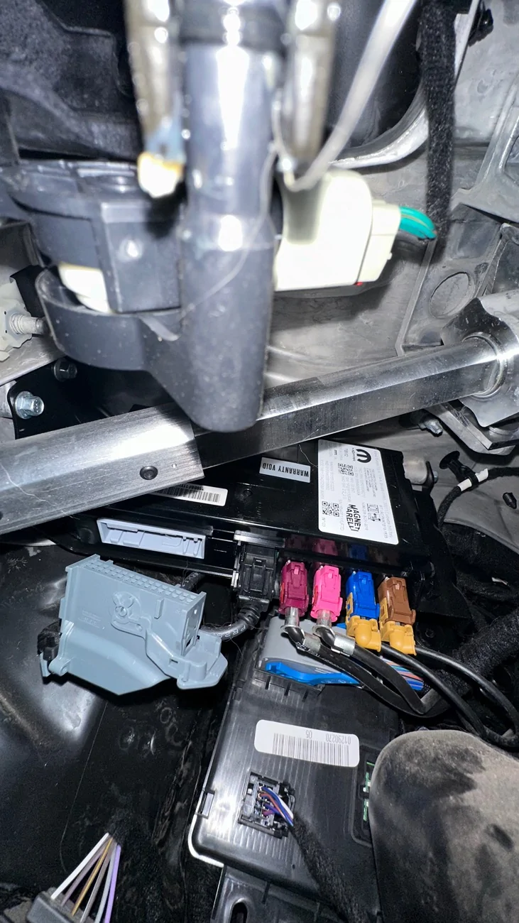

My 2024 has the Uconnect 5 computer screen and the telematics box is next to the steering column. I bought a jumper cable for the brown and blue antenna lines to keep the satellite radio functional.
