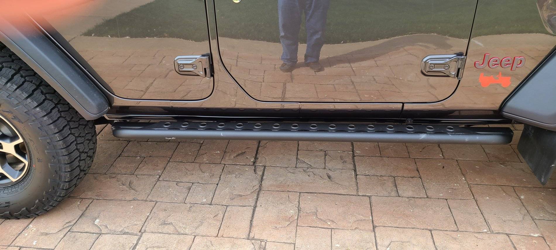

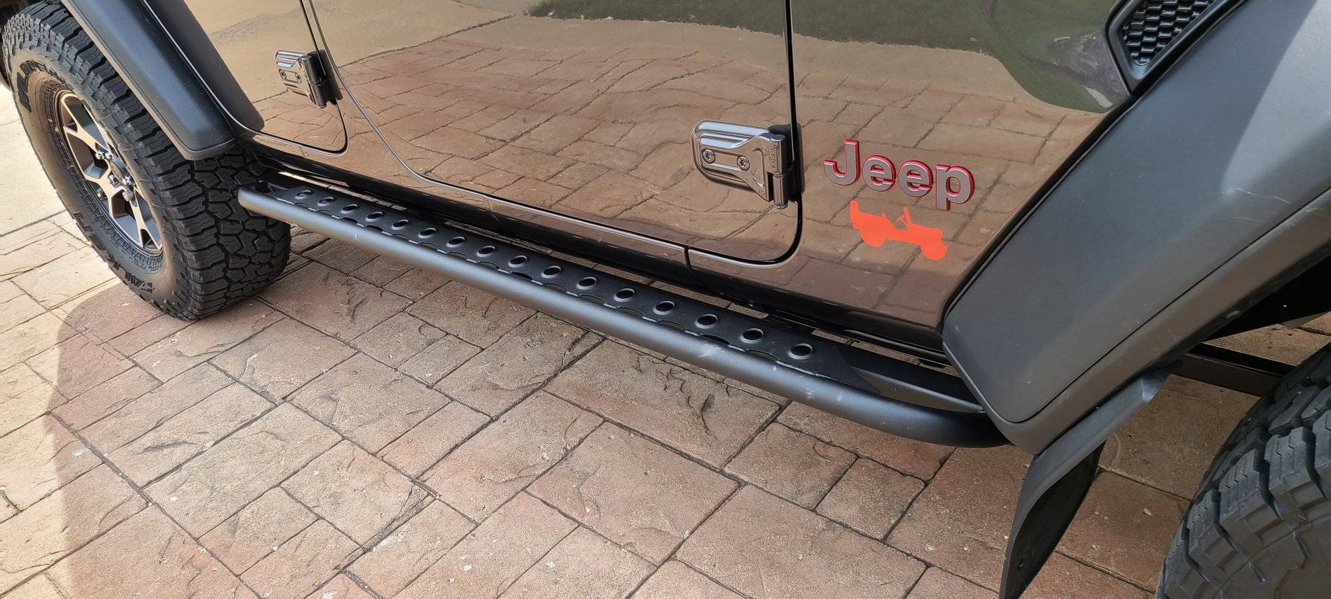

Installed Shrockworks rock sliders:
Jeep Wrangler JL It has been a busy week 20210330_104237
Jeep Wrangler JL It has been a busy week 20210330_104244

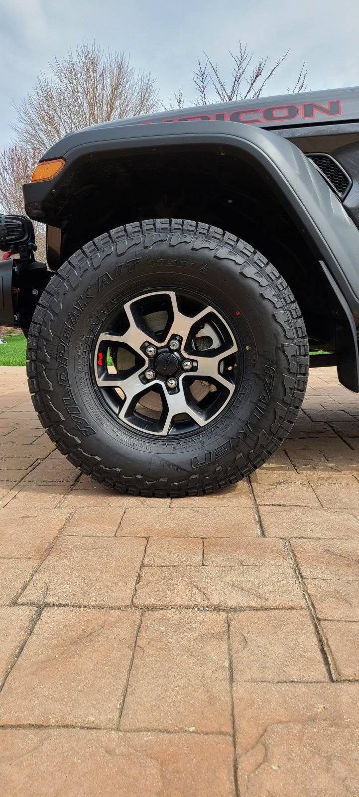

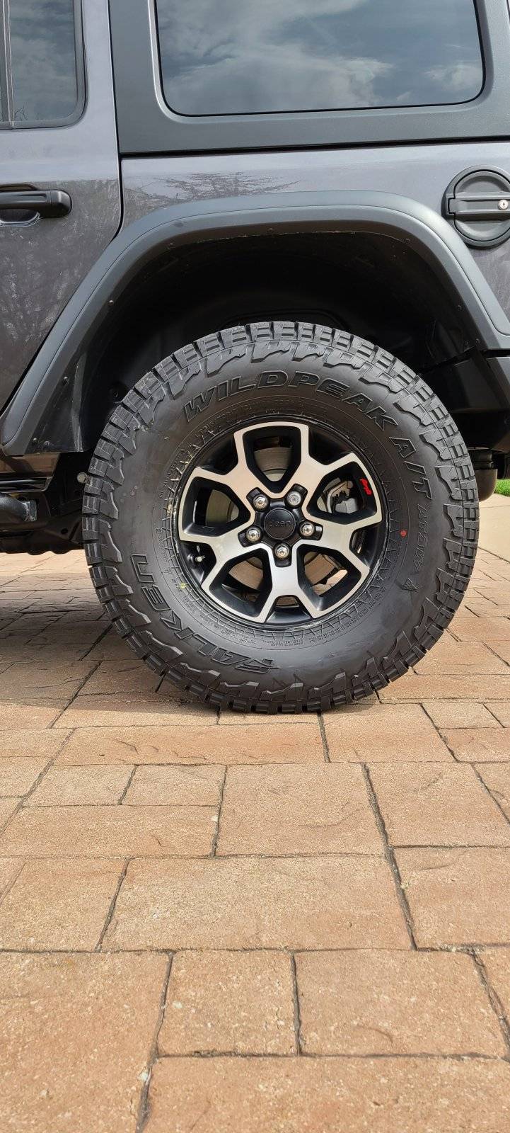

Installed Falken Wildpeak A/T3W LT315/70R17 tires:
Jeep Wrangler JL It has been a busy week 20210330_104115
Jeep Wrangler JL It has been a busy week 20210330_104230
Jeep Wrangler JL It has been a busy week 20210330_104127

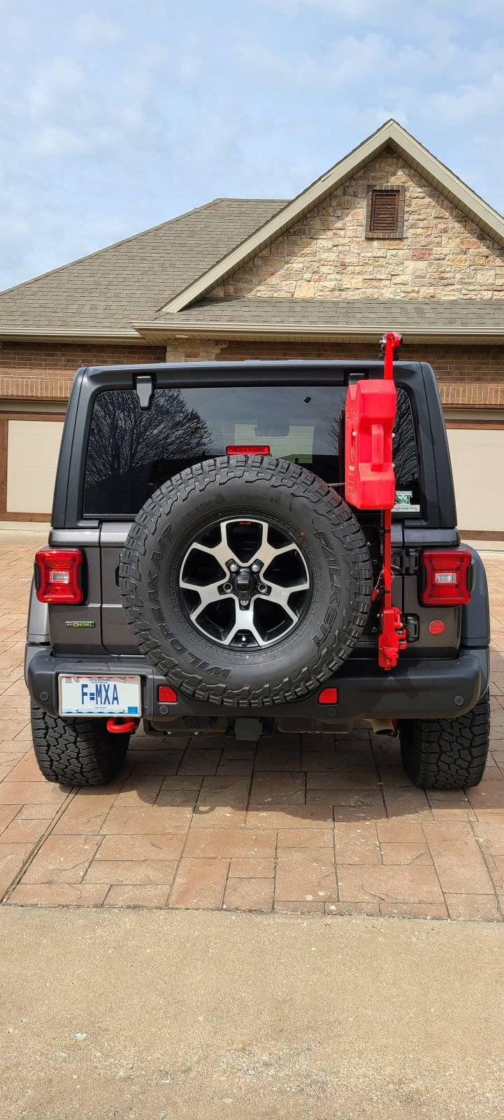

Installed TeraFlex Hi-Lift jack mounting bracket to tailgate hinges and then installed TeraFlex mounting bracket to my Hi-Lift jack for my 3 gallon RotopaX fuel container. There were some issues since the Teraflex mounting bracket for the JL was designed for a 2 gallon RotopaX container. I made some changes so that I can use my 3 gallon container, and the tailgate opens fully and my tailgate glass opens now with no interference:
Jeep Wrangler JL It has been a busy week 20210330_104151

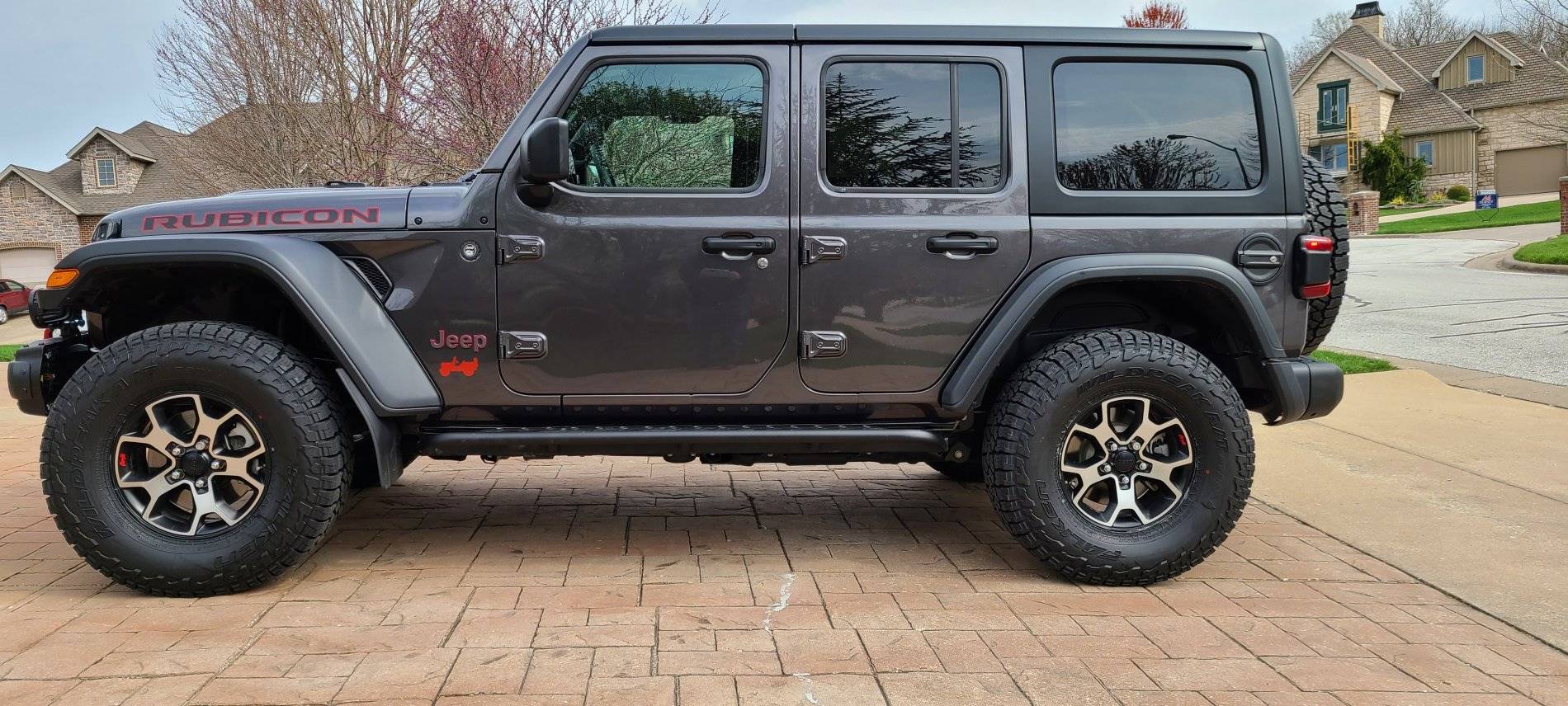

Installed Daystar 3/4" spring seats front and rear to compensate for the added weight and provide more ground clearance. The spring seats plus the 35" tires provided about 1.75" additional clearance for the Rubi.
Jeep Wrangler JL It has been a busy week 20210330_104101
The LT315/70R17 are about a 1" wider tread than the OEM MT's.
Jeep Wrangler JL It has been a busy week 20210330_104552
The 3/4" lift did affect the toe, so I had an alignment today to bring everything back to specs. The LT315/70R17 induced a 6% odometer error, plus my Jeep is involved in the Customer Satisfaction Y09 for the recalibration of the EBCM. So while the dealer is updating the software for the brakes, I will have the dealer correct the calibration for the new larger tires.
