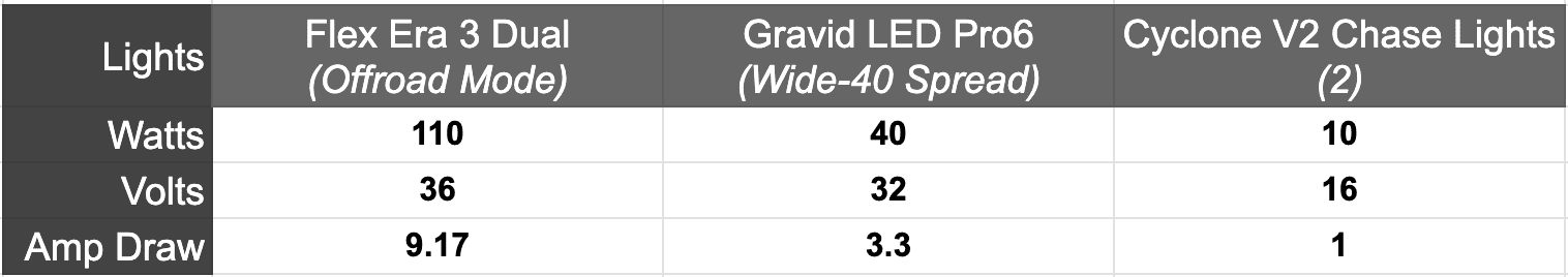

Great information here, folks. Thank you! A couple more details about my plan:
I'm installing KC Flex Era 3 Dual amber fog lights, KC Gravity LED Pro6 amber front bumper lights, and then 2 KC Cyclone V2 LED amber "chase lights" on the rear of my Jeep. My idea here is to activate the rear lights at the same time as either the Flex Era 3 Offroad lights or the Gravity bumper lights so that I can activate amber lights on all four corners at the same time with the same button.
The chase light wiring would run inside the Jeep to the under-dash AUX wiring, and the front lights would run to the AUX wiring by the battery.
Here are the specs that seem relevant:
Jeep Wrangler JL Is this possible? Screenshot 2023-10-25 at 8.18.02 AM
I've not decided yet exactly which front lights I want the rear lights connected to.

I wouldn't write the fogs with the chase lights, you'll want to be able to run the fogs on road when it is actually foggy and I don't believe chase lights being on is legal on road in most states at least. With the amp draw of the fogs of put then on aux 1 or 2, the other lights could all run off the lower amp 3/4 switches.
